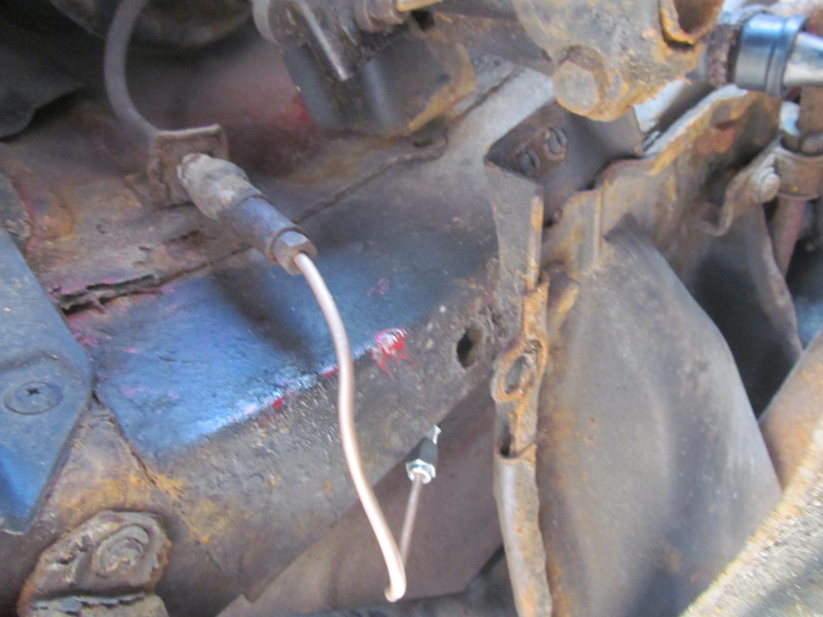

AMC Rebel Posted March 4, 2017 Author Share Posted March 4, 2017 Got the first of the brake pipes done, although it did take me all morning. Short version - inept old git has to make 3 versions of pipe to get one that's going to work. M'coli, Magnificent Rustbucket and Bren 3 Link to comment Share on other sites More sharing options...
AMC Rebel Posted March 4, 2017 Author Share Posted March 4, 2017 Grrr why is it that no matter how many brake spanners you have, the fittings are always between the sizes you have? I have eleventy million brake spanners, imperial and metric, and yet there are still some that are a duff size. I don't think this job is being helped by the fact that Ford seem to have put the pipes on before fitting the rear subframe either, but onwards and downwards. I am actually having a decent day - the weather is glorious. Tickman and Magnificent Rustbucket 2 Link to comment Share on other sites More sharing options...
AMC Rebel Posted March 5, 2017 Author Share Posted March 5, 2017 Day 2 weather not glorious. No longer pissing down but not anything like as much fun as yesterday. First job was sorting out the downpipe on the guttering. I have made one more brake pipe, but waiting for a lull in the rain before fitting. By the way, I meant to mention that after several weeks just sitting there, the mondy started up first time. This is where I got to yesterday Three (well six if you count the balls ups) pipes made and fitted. Three to go (plus balls ups). Oh, and did the rear drop link on this side - despite not being failed for that or even advised, the rubbers were totally shot. Will do the other side when I get around there. Since it was raining I went into the garage to do battle with the track rod end on the MG (thanks to all for all the ideas) finally removed the old 'un (which was only buggered due to my hamfistedness in releasing it). I celebrated by fitting the new one from the wrong side, which I noticed whilst doing something else. Now corrected. Link to comment Share on other sites More sharing options...
