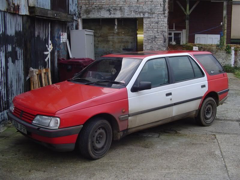

Argh! Don't mention octopuses! What a filthy job they are to change! Thankfully, i don't have many of them to do anymore.
As for the XUD lumps, i rate them big stylee! I've got a 'low mileage' 405 estate/van/hack with only 150k on the clock, engine is brilliant, it's just the trim thats falling off!

^^^^^That is fantastic!

MrGav, That 405 is almost perfect!!If only the replacement doors were different colours you could create a 405 Break Harlequin! 8)I had a shiney newish Mi16 back in the day. T-cutting it every month to try and keep all the pannels the same colour and endlessly buying / glueing / stoping to pick up bits of trim was a royal pain. :roll:Now like all old french cars, once they look scruffy and all the plastic bits have fallen off the remaining bits will go on forever.

My 405 wagon looks like that, but only the rear doors are non-matching.Sometimes coolant-related issues are down to airlocks, the radiator fill is at a low point in the system (thermostat is higher due to engine tilt) and they don't have proper header tanks. My wagon pushed out lots of coolant, no heat from the heater, crazy temp gauge action etc when I got it - a good flush through then a cutdown Evian 1.5ltr bottle jammed in the rad filler as a header, holding it at 1500rpm until the fan cut in 3 times, seems to have solved the problem. It bubbled like a bastard with loads of pressure from the rad cap before, but now there's hardly any.So open the rad cap after a run, there should only be a very small hiss. Also, watch the temp gauge - it should go up to about 85 then drop to 75 (83 degree thermostat), if it goes above 90 the fan should cut in. They don't all do this because the loom wiring to the fan is easily buggered.My two XUD9TE 405's have a mere 433k on the clocks between them :lol:
