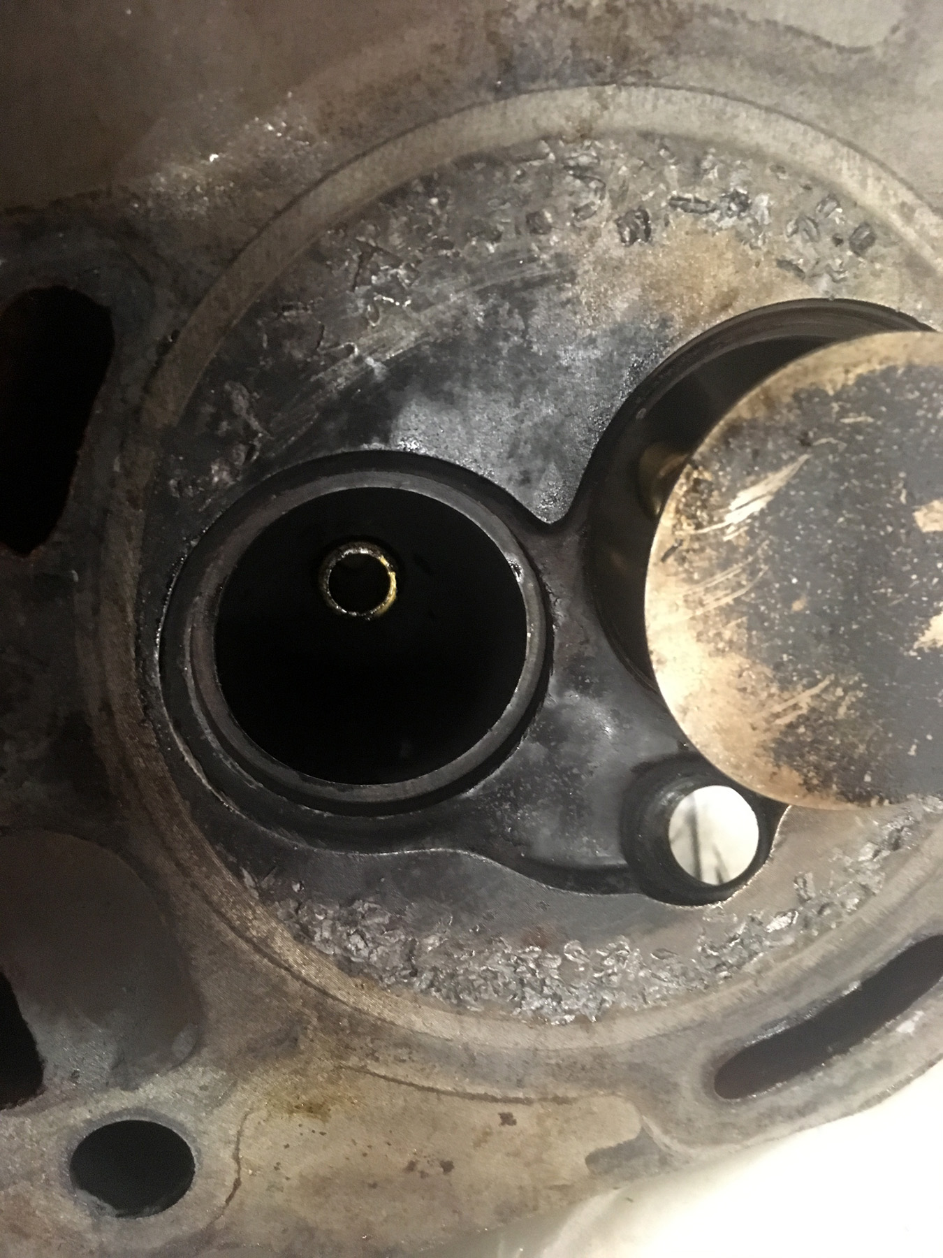

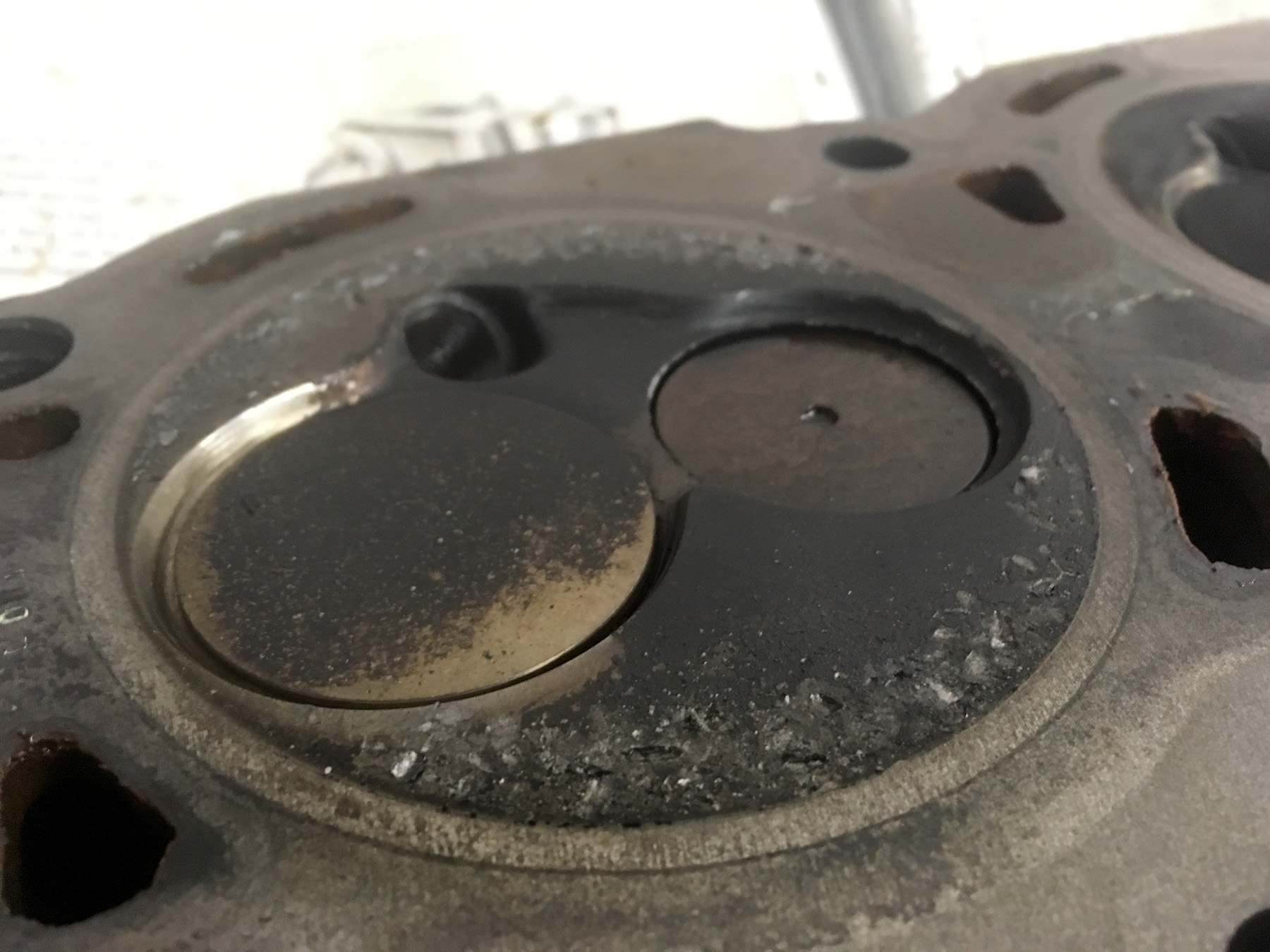

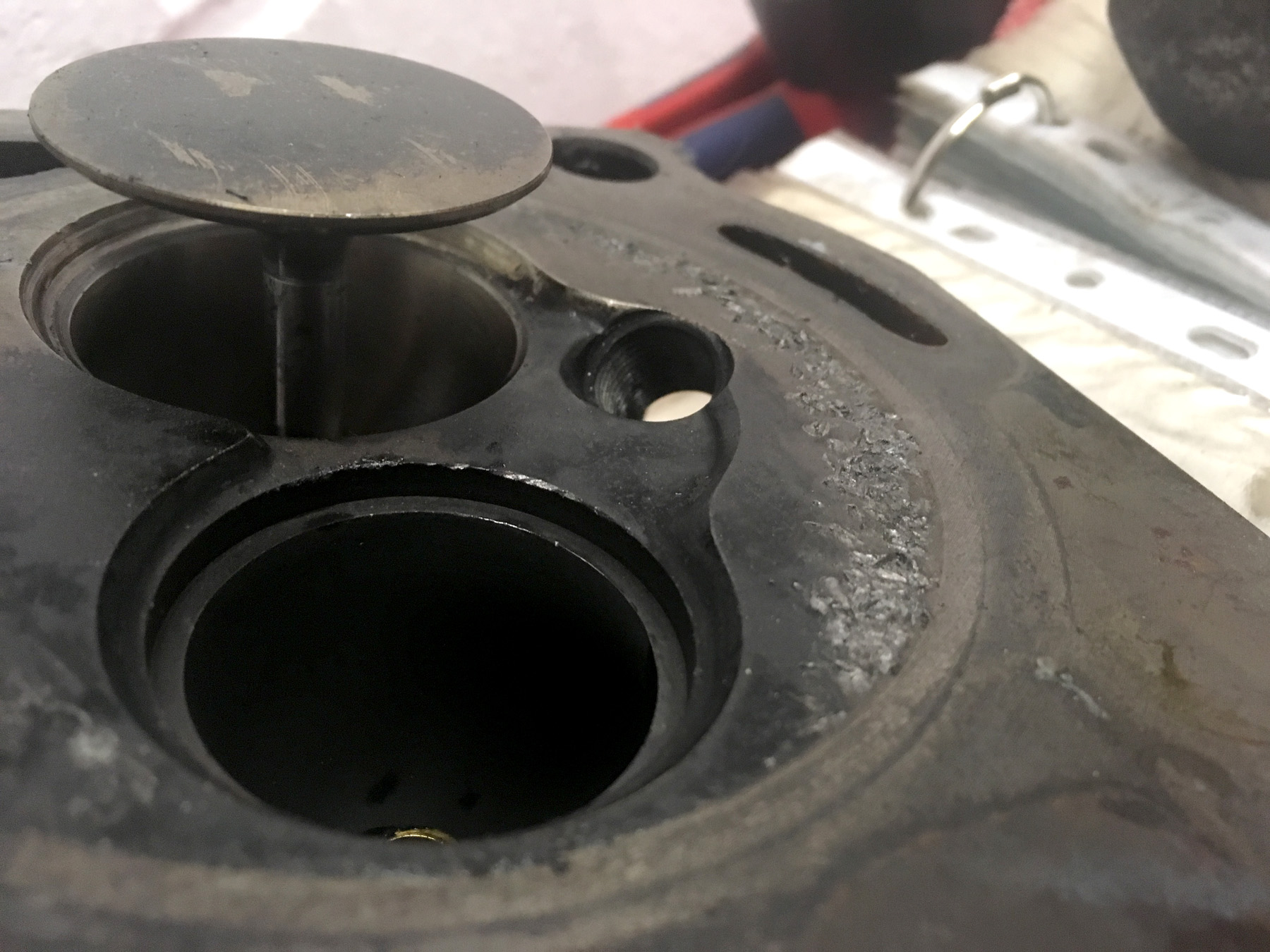

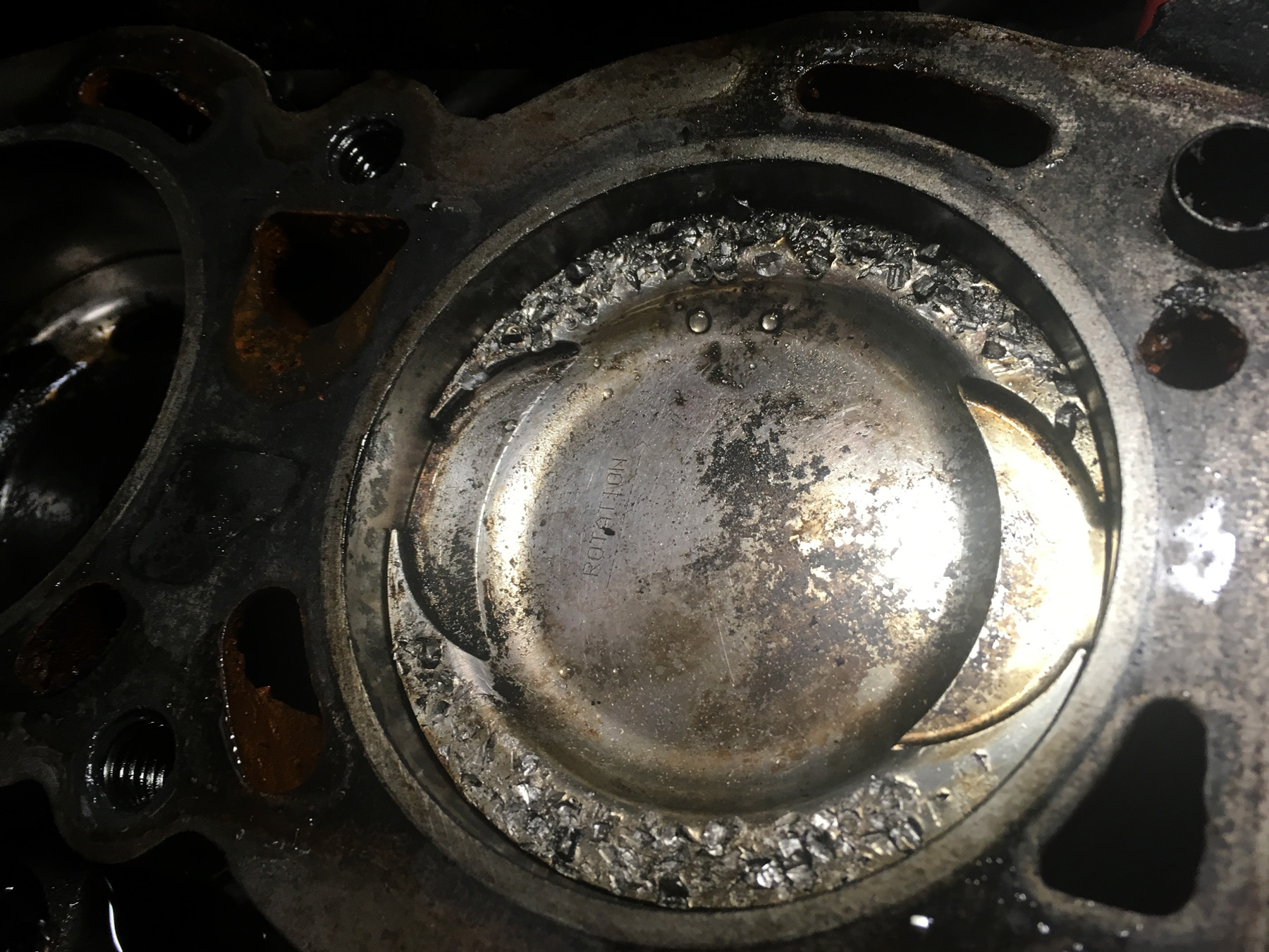

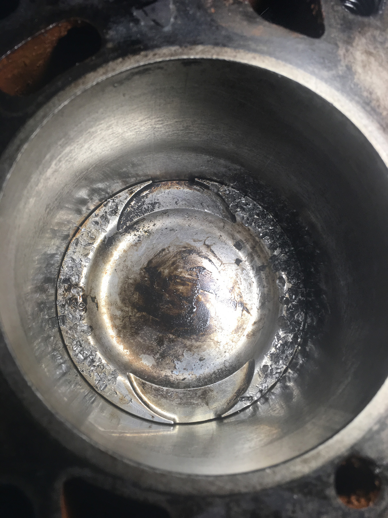

coalnotdole Posted December 27, 2018 Author Share Posted December 27, 2018 Head off HorrorsWith the head off the results were quite a bit worse than I'd hoped. The valve seat has broken up completely with the fragments damaging th head and the crown of the piston. I've studied the piston & valve carefully, theres been no contact beweeen them that be seen and the valve is not bent.I can only conclude that the valve seat inserts were not particularly well fitted (work done on the engine before I bought it) and that last years hot running may have caused one to lossen. but not so much that it was noticable when I refurbished the heads or lapped in the valves.The damage to the piston will mean that will need replacing. I also now don't trust any of the other exhaust seats so will have to get them replaced too.Next step engine out. Strip Down and decide how much remedial work I'm going to need do... Coprolalia, Sigmund Fraud and richardthestag 3 Link to comment Share on other sites More sharing options...

Guest Hooli Posted December 27, 2018 Share Posted December 27, 2018 Fuck! I had a piston much worse than that in my Bonnie & dressing the head & crown resulted in it running fine. The pits quickly filled with carbon so didn't affect the running. The Reverend Bluejeans and Momentary Lapse Of Reason 2 Link to comment Share on other sites More sharing options...

N Dentressangle Posted December 27, 2018 Share Posted December 27, 2018 Buy these: https://www.ebay.co.uk/itm/FORD-ESSEX-V6-3-0-D-port-Cylinder-heads-TVR-Capri-Scimitar-GTE-Gilbern-Hotrod-AC/283314554263?epid=1850483119&hash=item41f6dd0597:g:2M8AAOSwAzxcH9Jq:rk:1:pf:0 Ignore the piston, as Hooli suggests, and bolt it all together. It'll be fine*. Mally 1 Link to comment Share on other sites More sharing options...

spartacus Posted December 27, 2018 Share Posted December 27, 2018 I feel for you, having put all that work in it does genuinely make you feel that a car is being ungrateful!Obviously it's not something that you want to do but is a rebuild just expensive, or hideously expensive?I reckon the head would clean up, I would however, always be worrying about the piston breaking up further if I left it in. Link to comment Share on other sites More sharing options...

DodgeRover Posted December 29, 2018 Share Posted December 29, 2018 In fairness even if you had stripped it completely it's unlikely you would have spotted a badly installed valve seat. Link to comment Share on other sites More sharing options...
