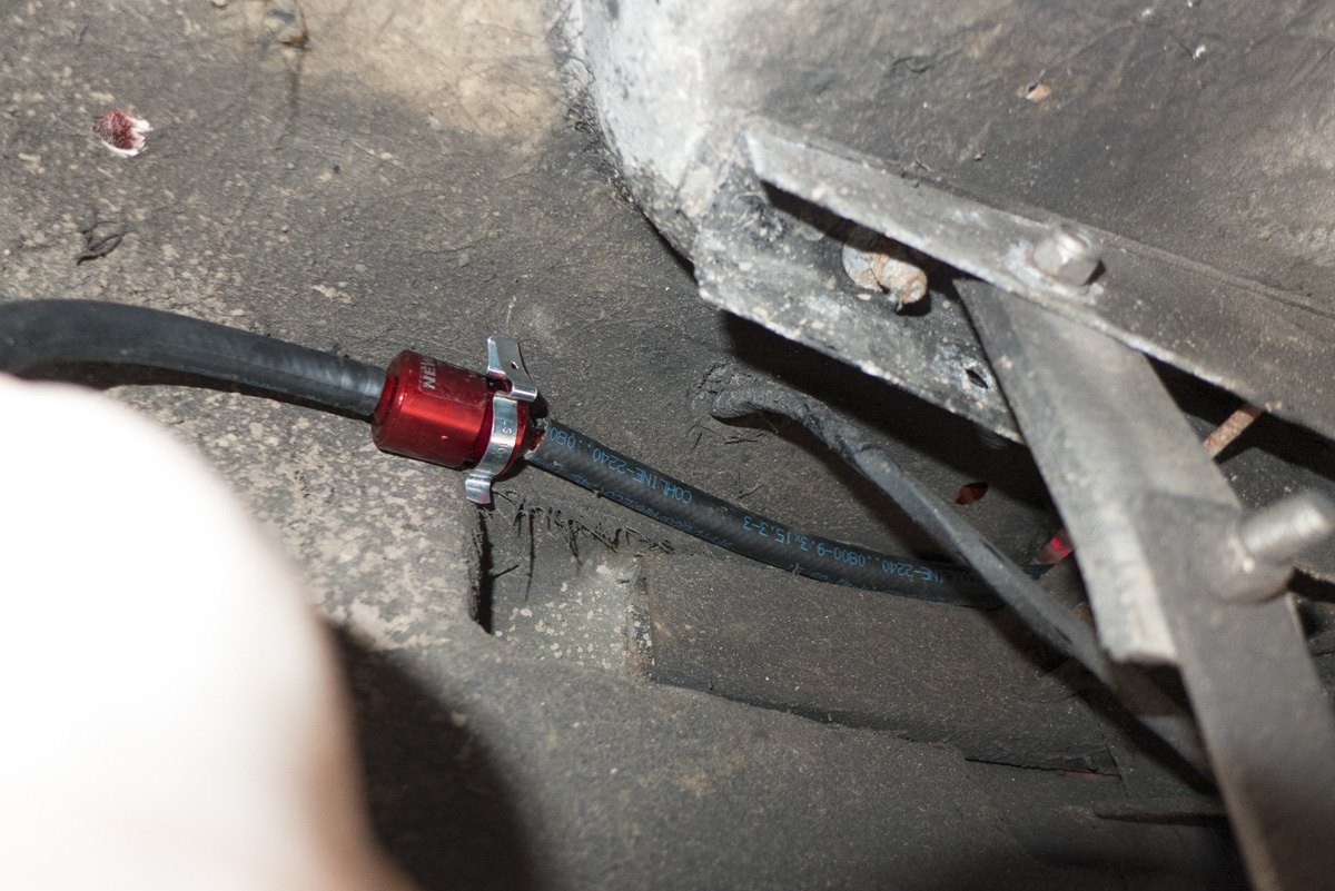

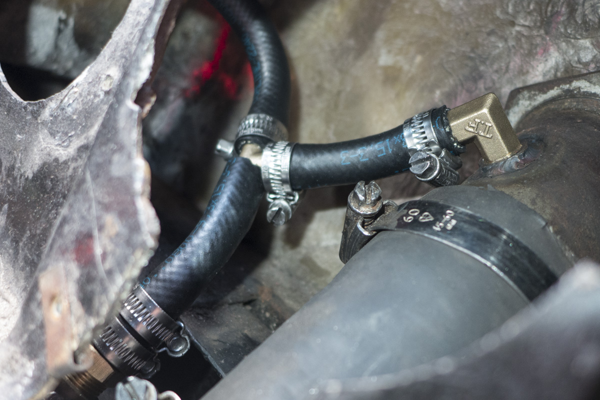

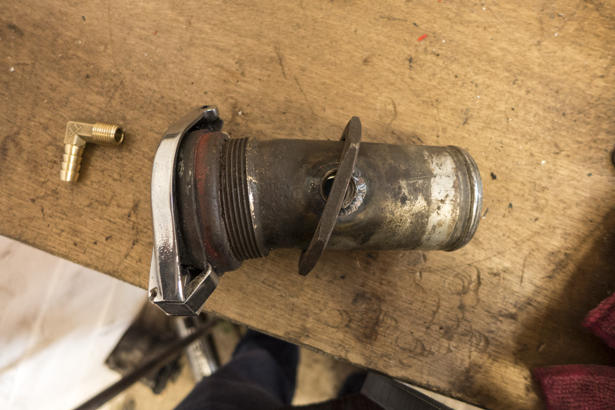

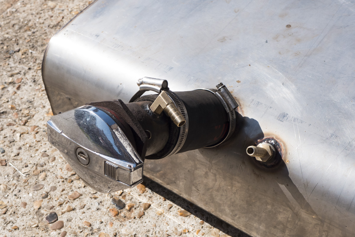

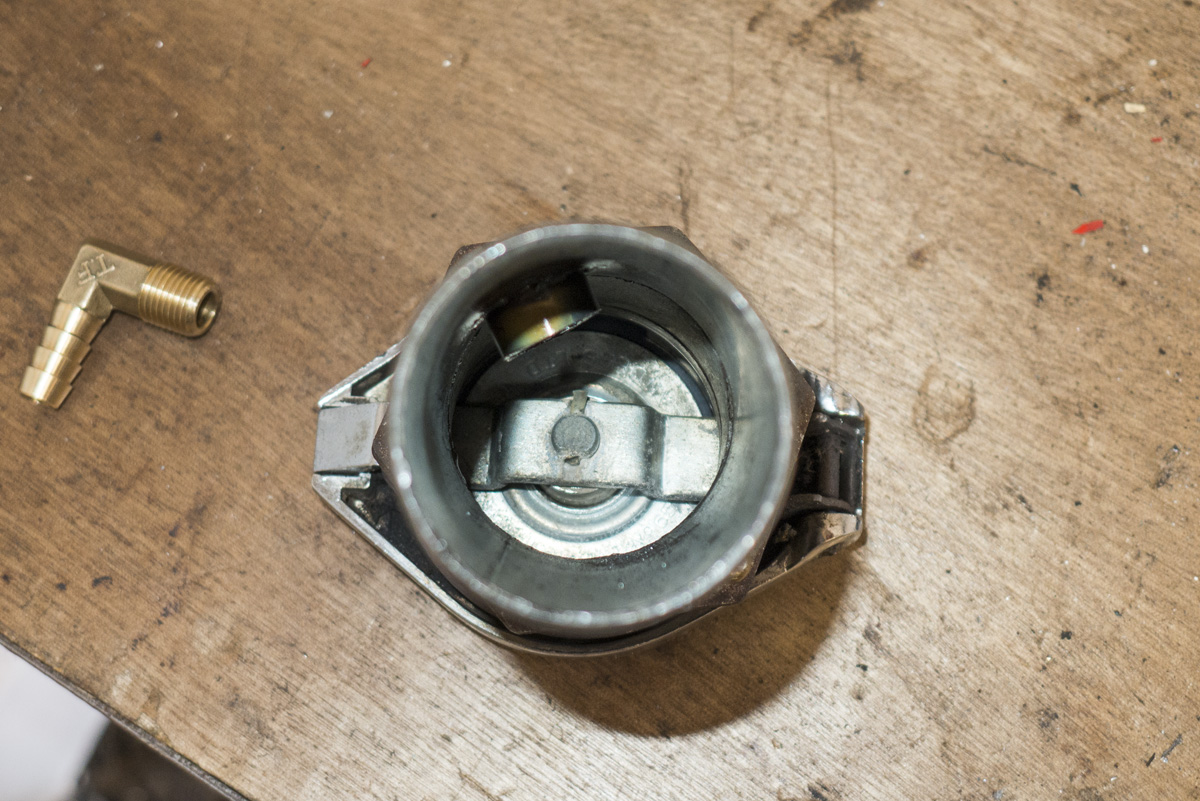

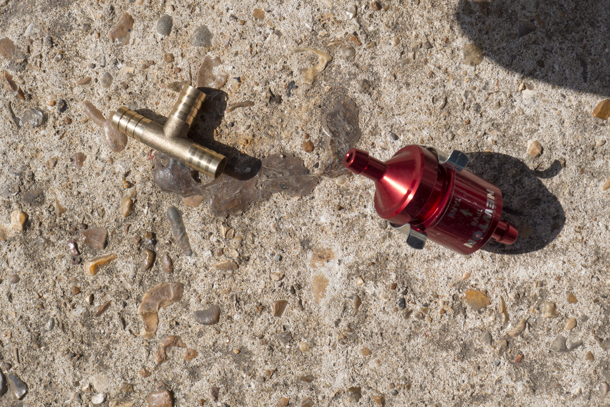

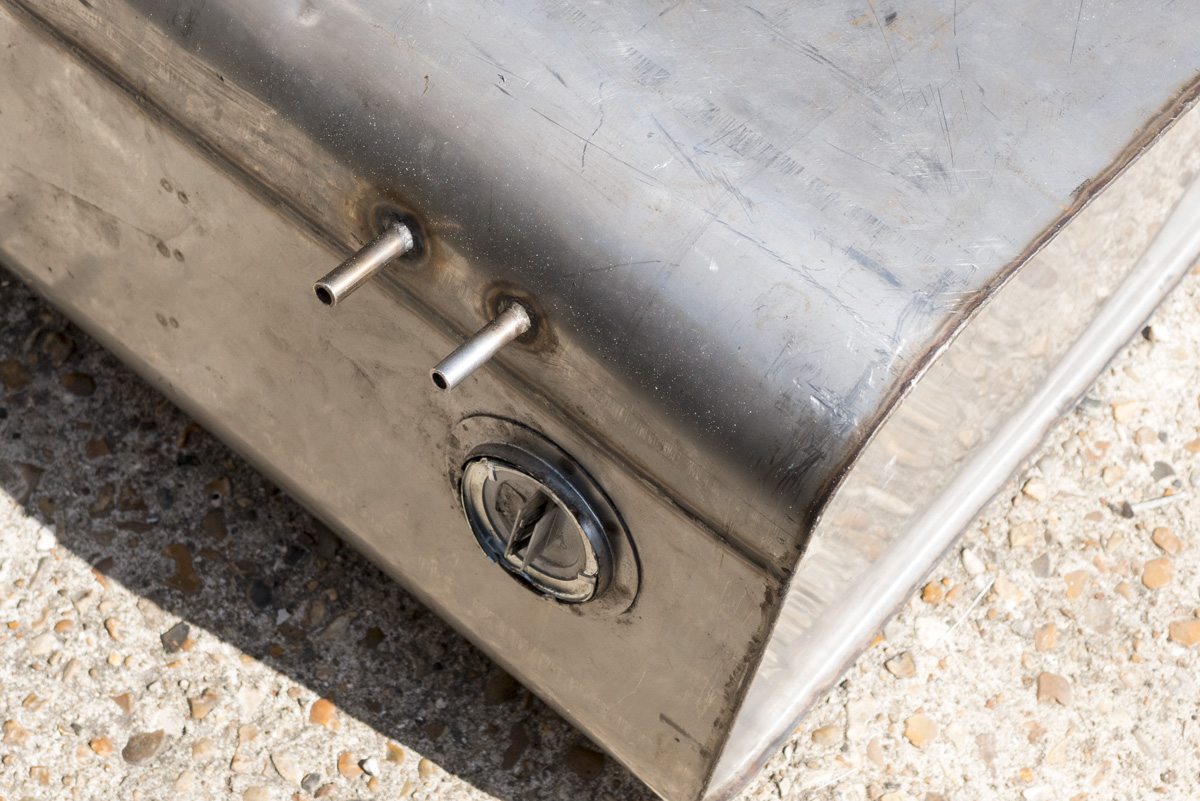

coalnotdole Posted August 11, 2016 Author Share Posted August 11, 2016 Sorry this post isn't as exciting as a shiney engine...I was aware when I stared going down the Fuel injection route that I was going to need to modify the tank to allow for a fuel return. My car has a stainless tank fitted already but as it has been used recently it was still partially full of petrol not ideal for welding to. I was lucky enough that someone in the scimitar owners club had one spare, they are available new but they are not exactly cheap. Fortunately the replacement had been dry for a number of years. I gave it a good clean out and sent it off to get a fuel return line welded in:However I did a bit more reading online and it turned out there were a few other things to consider. Modern cars generally have a tank breather on there somewhere to prevent air pressure problems, the scimitar as standard vents through the filler cap, but I was unsure if this would be ok with the extra flow through the tank. So while the tank was out I decided to also modify it with an extra outlet for a breather valve. While It off It was also decided to modify the fuel filler neck to have an air breather line. The new line will connect the top of the tank to the top of the filler neck and should allow the air pressure to equalise as the tank is filled. It should hopefully prevent the clicking off problem you get at some modern petrol pumps while filling up.The Pressure Release Valve is a Newton TPV8 This is designed to remain closed until the air pressure level is reaches a set level, it then opens. This should prevent the tank from constantly venting a petrol smell from the car, only opening when need. If it does spend a lot of time open and there is a noticable smell I'll look at fitting an activated charcoal filter like you get on modern cars. This should be easy to retofit at a later date.The filler neck has had a BSP Boss welded into it to allow the hosetail to be removed, it allows the retaining nut to pass over it with reasonable clearance.The boss sticks through into the filler neck a bit too much at the moment but it will be filed down before its properly fitted.I then fitted the tank, filler neck and bypass hose to the car to test the theory. Its in a difficult area to photograph so please excuse the shit pictures:The hose at the top left will go to the pressure valve, Which will be hidden somewhere under the boot floor and the outlet from that will be run out somewhere under the car.I took this photo showing a potential location for the valve, I think i will actually move it back towards the filler neck and only the output hose will come though here, but It shows the theory.CheersJoe DeeJay, scdan4, Asimo and 20 others 23 Link to comment Share on other sites More sharing options...

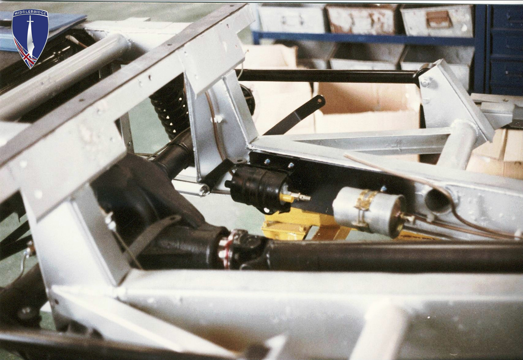

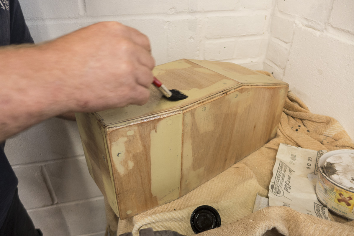

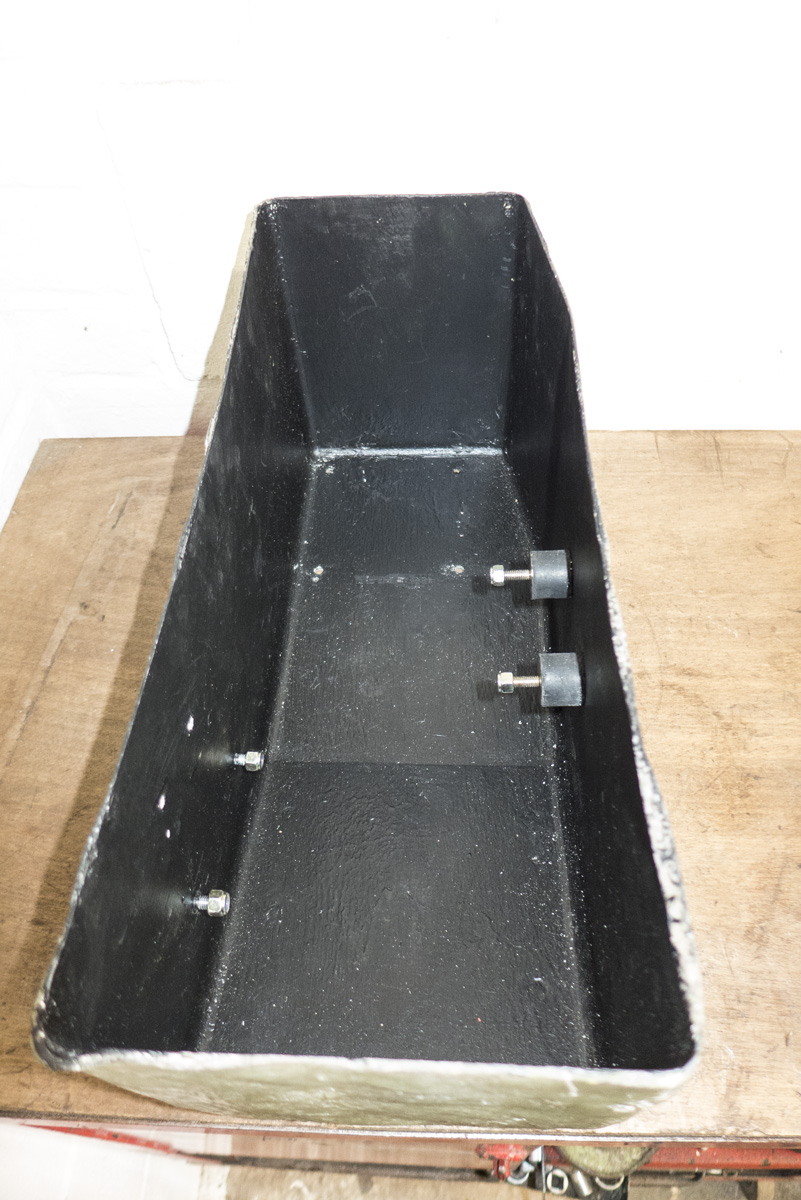

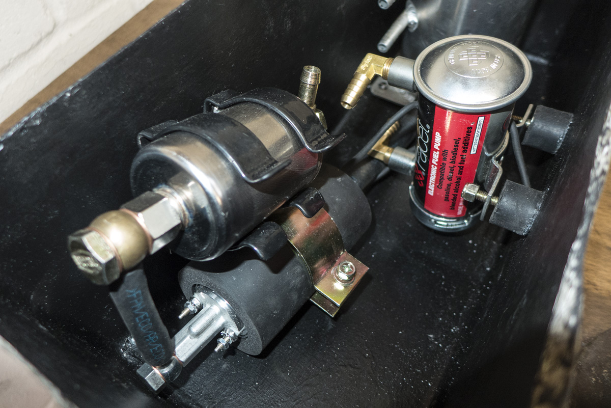

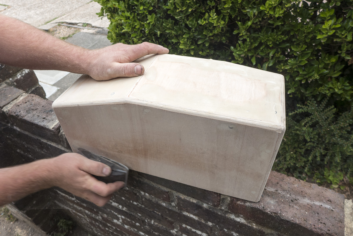

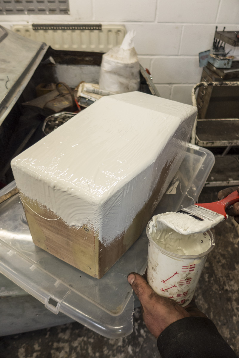

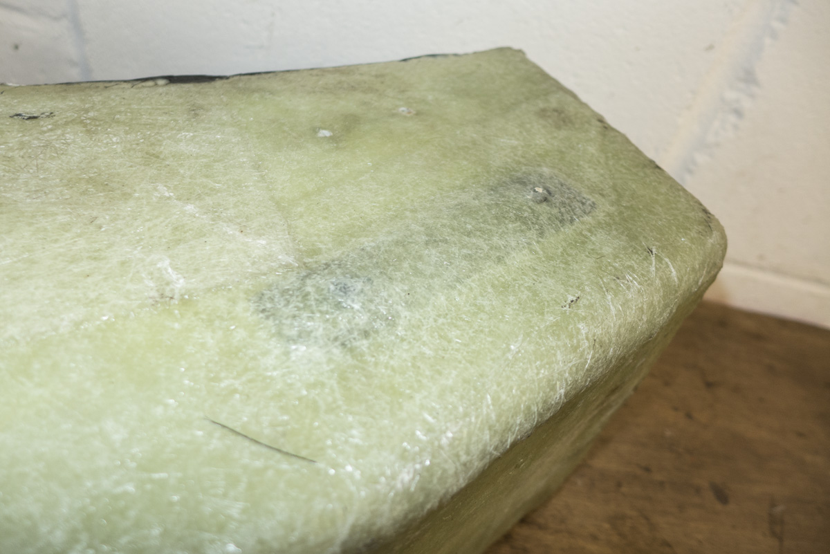

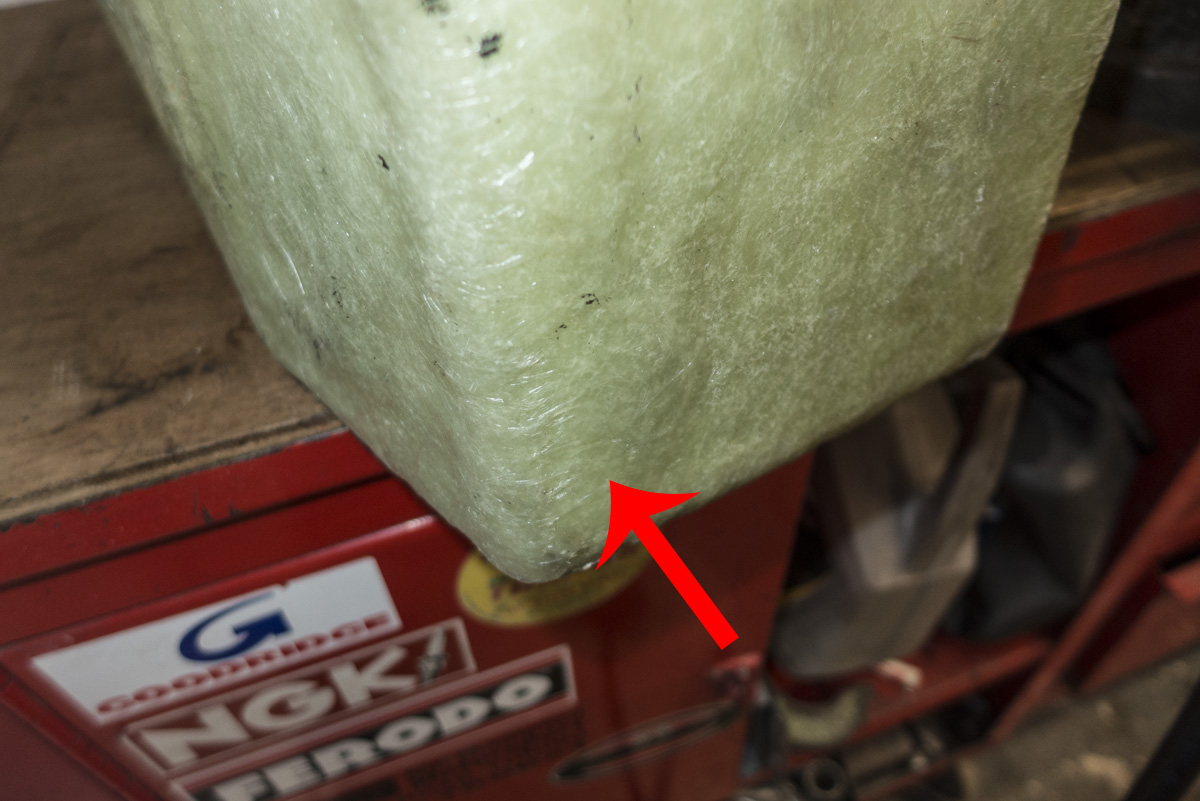

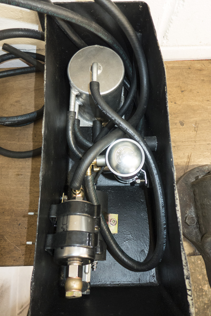

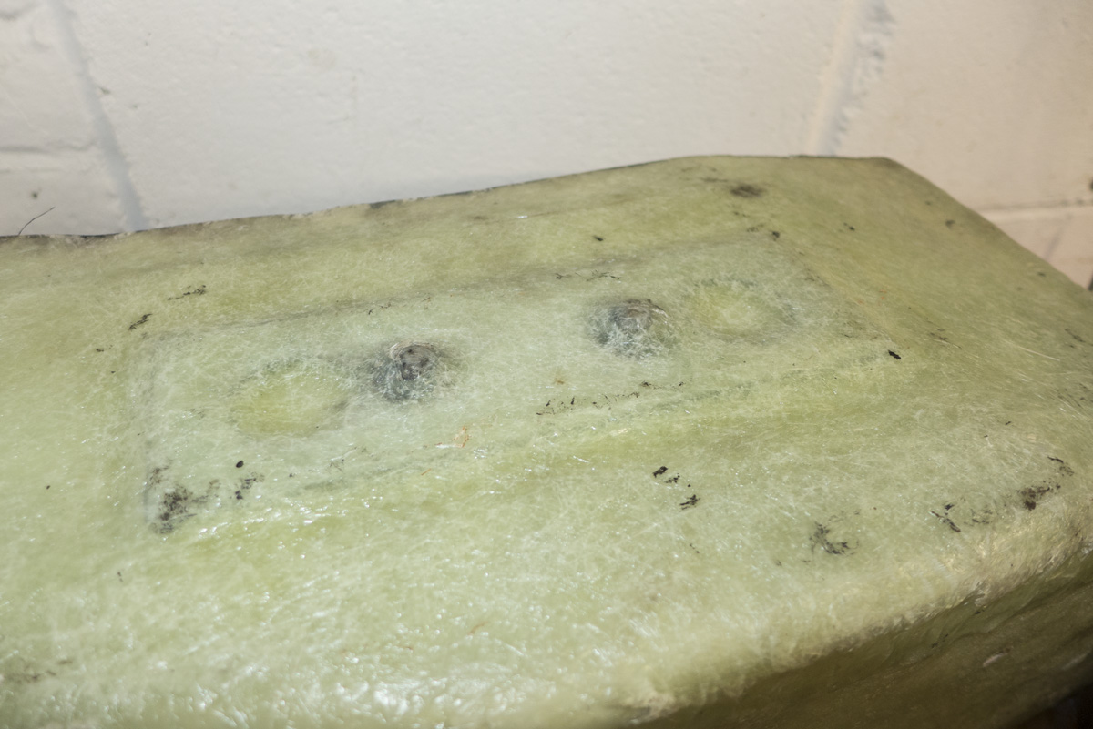

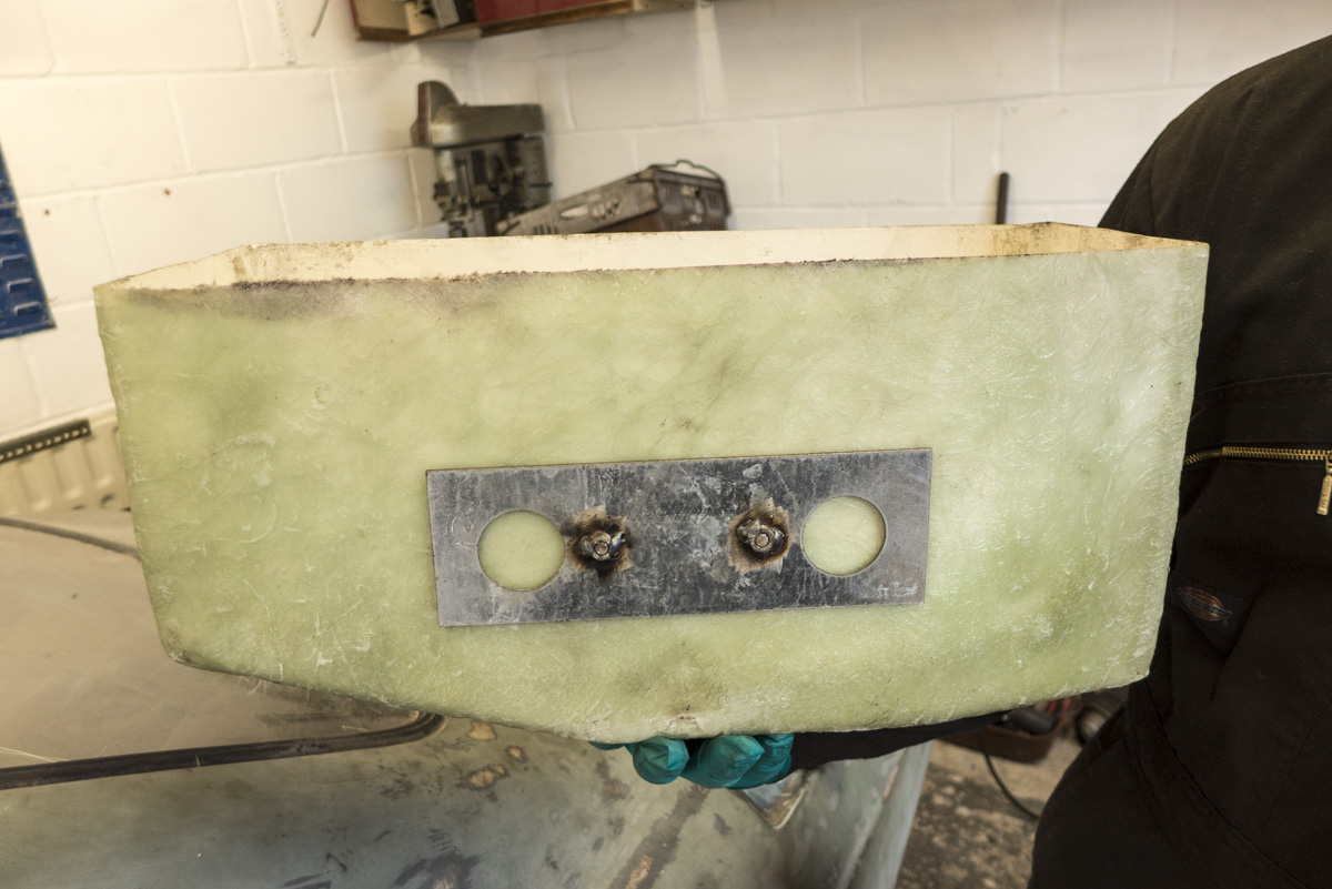

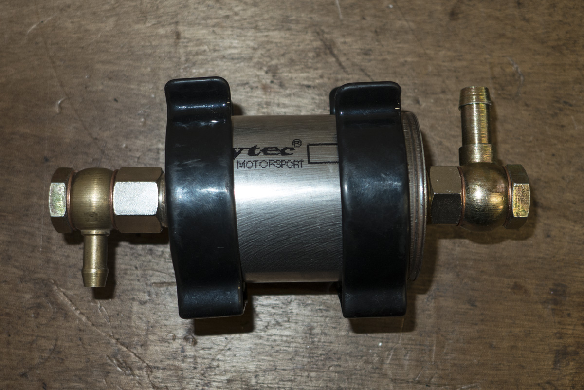

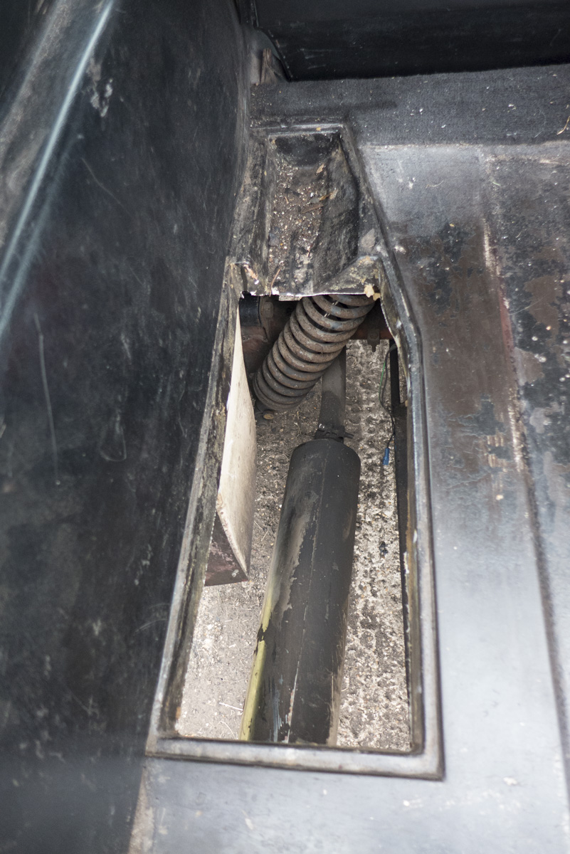

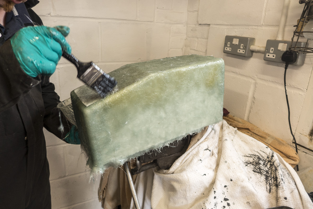

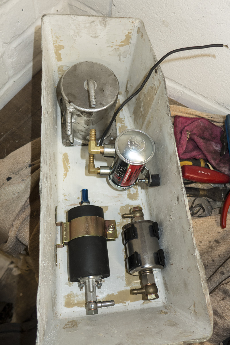

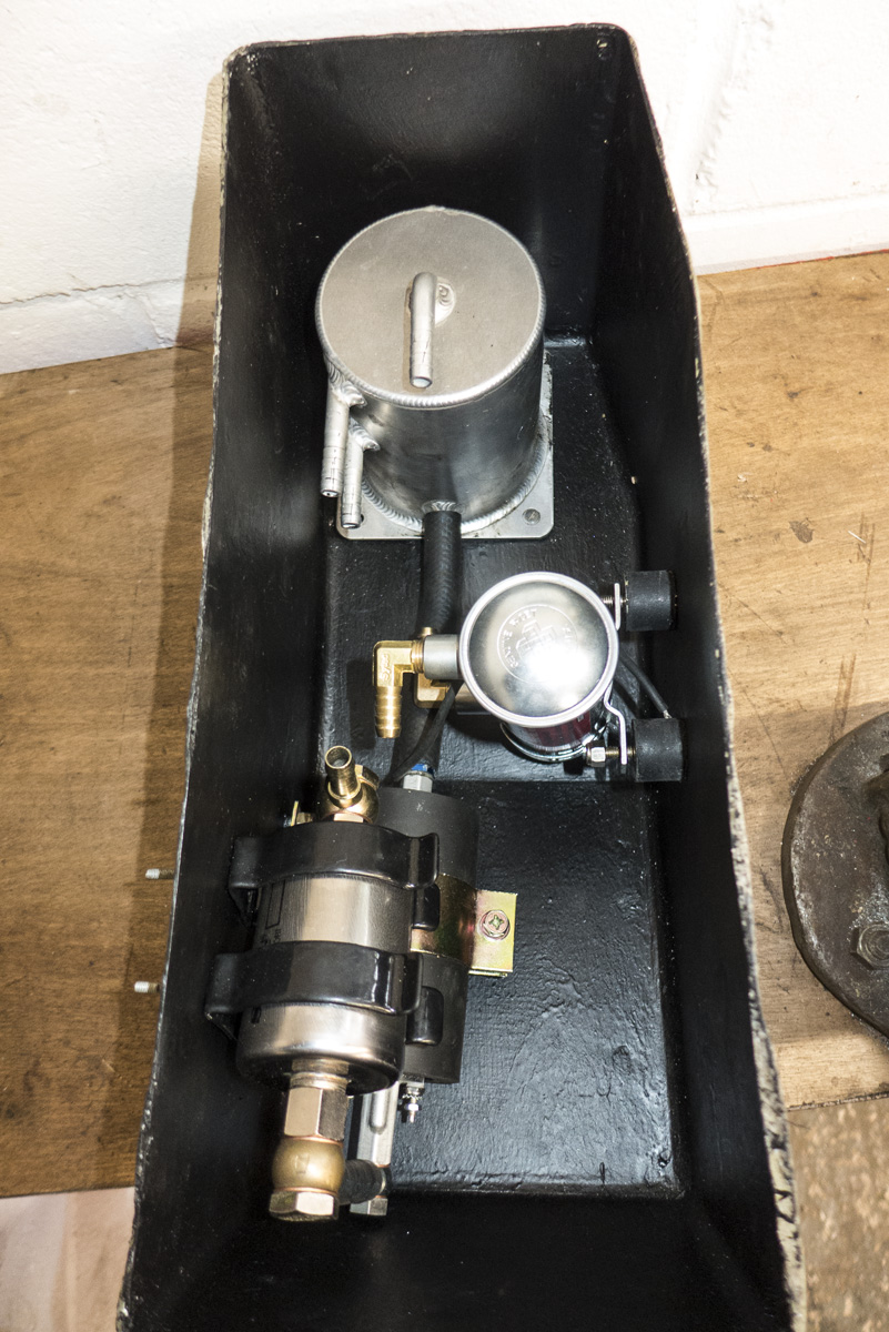

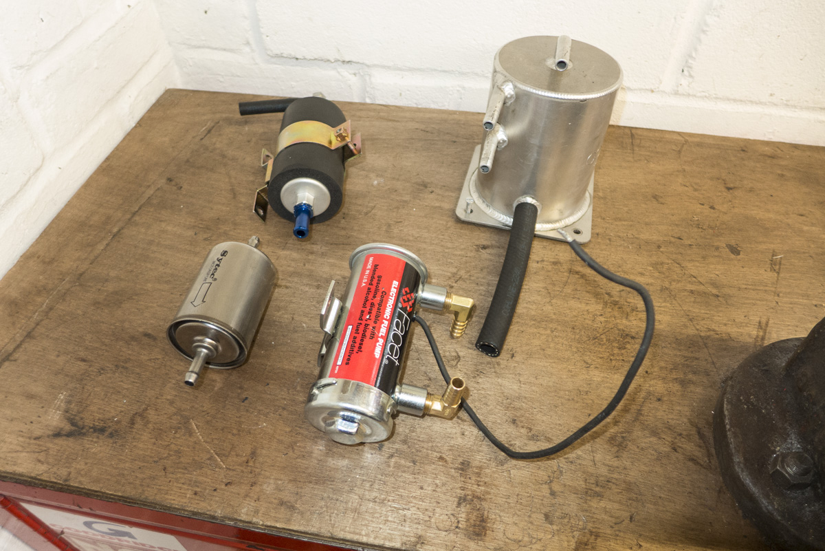

coalnotdole Posted August 13, 2016 Author Share Posted August 13, 2016 The fuel system continued.... With the tank sorted there was still the problem that I had to find room for all of this stuff:(Low Pressure Pump, High Pressure Pump, Fuel Filter and swirl pot.)I knew I'd have to alter the tank but had just sort of assumed that it would be easy to loose the fuel pumps under the car somewhere, but after scrabbling around under the oily horrible mess that is the bottom of my car I realised that it wasnt quite as simple as that. A few options were explored, including mouting the pumps in the dead space above the passenger side boot floor, that location was ufotunately close to the rear silencer which was hardly Ideal, My mate Dave suggested replicating the Middlebridge setup, with the pumps mounted alond the inside of the chasss rail, which would probably have worked ok If it wasnt for the swirl pot.Middlebridge setup:The Middlebridge setup also had the disadvantage of covering all of the pumps in filth and oily muck that inevitably accumulates on the under side of my car. While I don't do the paris-dakkar on my daily commute I do use the car, year round and have driven it through Flood, Ford, mud and snow often enough to know how much shit can get stuck to the underside of the car.After a bit of head scratching It was decided to sacrifice the rear Jack cubby hole and recreate it as a home for the pumps, at least the pumps would be protected from the elements and servicing would be easier. I'll work out a way of putting the Jack inside the spare wheel at a later date. At least then it will be in the same place as the spare when you want to use it!Dave got happy with the Zippy disc / demolition saw:A wooden mould was made, Filled and sanded:waxed:Given a PVA coating:Gellcoat: (application of gelcoat on a coupe is optional)CSM:The mould had to be destroyed in order to get the new section out, unfortunately the filler was a bit old and hadnt properly gone off so some of it stuck to the moulding, Still it will clean up ok. With a moulding complete it was possible to start mocking up the layout for the pumps, this would allow us to create captive nut plates in the places we needed.Dave welded up some nut plates to suit, the steel is actually spare coupé door reinforcement which we had lying around, WWRD?Glassed in:The Gelcoat then strangely turned black... ok I scraped the shit off it and primed it.I'm reusing the entire setup that came with the engine the only real alterations are to the unions, banjo fittings and to the fuel filter.All the fueling parts layed out in their final locations.... The components sit quite low in the box, this is to allow a decent layer of sound insulation to be attached to the lid, I'll also insulate the back of the boot carpet so hopefully the noise of the pumps won't be heard in the front of the car. The space to the right of the high pressure filter has been left deliberatey to allow working space for changing as fuel filter and to allow somehwere to put a multilug connector for the rear wiring loom,The fuel filler lines will probably come through a grommet here but I wont drill it until the new pod is fitted to the car.And finally heres a last post showing roughly what it will look like with all the fuel lines, There is actually a technical error in this photo so full marks awarded if you can spot it. mat_the_cat, drum, Alanism and 17 others 20 Link to comment Share on other sites More sharing options...

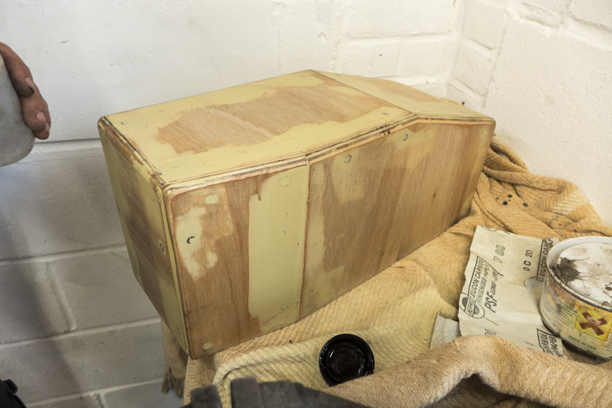

Honey Badger Posted August 13, 2016 Share Posted August 13, 2016 Great update, cant wait to see it running. With the plug for the moulding, next time seal it with 2 or 3 coats of emulsion to seal the wood pores, then use wax, then a good thick coat of polyvinyl alcohol release agent, dont know if which kind of PVA you put on but if its the wood glue type then its no wonder it destroyed the plug. Link to comment Share on other sites More sharing options...

coalnotdole Posted August 14, 2016 Author Share Posted August 14, 2016 Great update, cant wait to see it running. With the plug for the moulding, next time seal it with 2 or 3 coats of emulsion to seal the wood pores, then use wax, then a good thick coat of polyvinyl alcohol release agent, dont know if which kind of PVA you put on but if its the wood glue type then its no wonder it destroyed the plug. Cheers Honey badger, The mould making was done in a bit of a rush over a short weekend so there wasnt a huge amount of prep time, The PVA is a proper release agent of some sort, I bought it from the local boat builder a few years ago when we were doing some grp work to one of the rebels. The decanted it from a huge drum into a tiny plastic bottle. So I'm not 100% sure what it is or its use by date so possibly its a bit past its best. The cheap greek body filler used to fare the mould was probably far more of an issue as it diddnt want to set. This particular moulding is probably one of the least nice things we've made, still it should do the job ok. I always try to take photos when doing grp work as inevitablty its something that lots of people want have a go at, but are put off after bad experiences using the kits sold in motor factors (which are often total shit.) I buy all GRP supplies from out the factory gates of the local boat builder or the local chandlery. anonymous user and Sigmund Fraud 2 Link to comment Share on other sites More sharing options...
