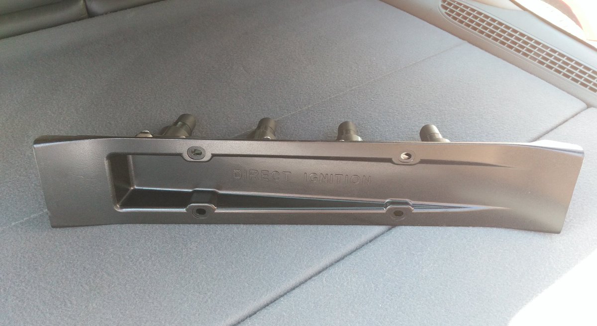

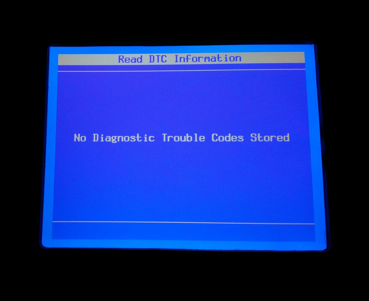

Shep Shepherd Posted September 15, 2016 Author Share Posted September 15, 2016 Update time! Changed the spark plugs and the DI cassette on The Aero today, as despite the fact it has been running fine since its FTP, connecting it to my Tech 2 suggested that it was misfiring a fair bit on cylinders 1 and 2, not enough to affect the running of the car, but enough to show a fault code. As the DI cassette is a known failure point on 'Trionic 7' Saab petrol engines, and in order to build reliability into the car, I set about looking for a reasonably priced replacement while the existing cassette was still working. I eventually sourced one for £140 including p&p (around half the price I would have paid here) from an eBay seller based in Essen, Germany: Although it arrived on Monday, I couldn't fit it until today, as I had to wait for the correct spark plugs to arrive from my favoured online parts supplier: According to Saab lore, fitting a new DI cassette without replacing the spark plugs beforehand isn't a good idea, as even one faulty plug can cause fatal damage to a new cassette, and is often why the ones originally fitted at Trollhattan fail in the first place. At least new plugs are fairly cheap for what they are and removing the old ones revealed their electrodes to be a nice grey-brown colour, suggesting that the engine's in rude health. The cleanest thing in the engine bay. For shame: The old cassette is now in the boot as a 'get you home' spare. Because Saabist ^^ Once I was done, I took the car to ASDA in Shoebury in order to test drive it and refuel it and to buy some cider and ice cream. In the process, I managed to introduce the car to Emma, the Buttery Biscuit Base Sierra: I also got to meet Angrydicky for the first time, as he spotted me photographing the cars, and had a brief-but-nice chat with him about various old crocks including the Sierra, The Aero and The Volvo, which was good Next job is to fit a set of Osram Night Breakers to the car's headlights, which I will do when the sun starts to go down and it's cooler outside. I've had them in every car I've owned since The Volvo and they really do make a vast difference when driving in unlit places at night, especially when the lights are on main beam. Should be easy to do, as you can get easy access to the headlight bulbs on a 9-5 to remove and replace them, unlike some cars I care to mention. Uncle Jimmy, Coprolalia, Rusty_Rocket and 6 others 9 Link to comment Share on other sites More sharing options...

Shep Shepherd Posted September 17, 2016 Author Share Posted September 17, 2016 Replacing the DI cassette and spark plugs was a resounding success: So was replacing the car's existing headlight bulbs with Osram Night Breakers. The headlights are now almost as bright as the ones fitted to modern cars, especially on main beam Barry Cade 1 Link to comment Share on other sites More sharing options...

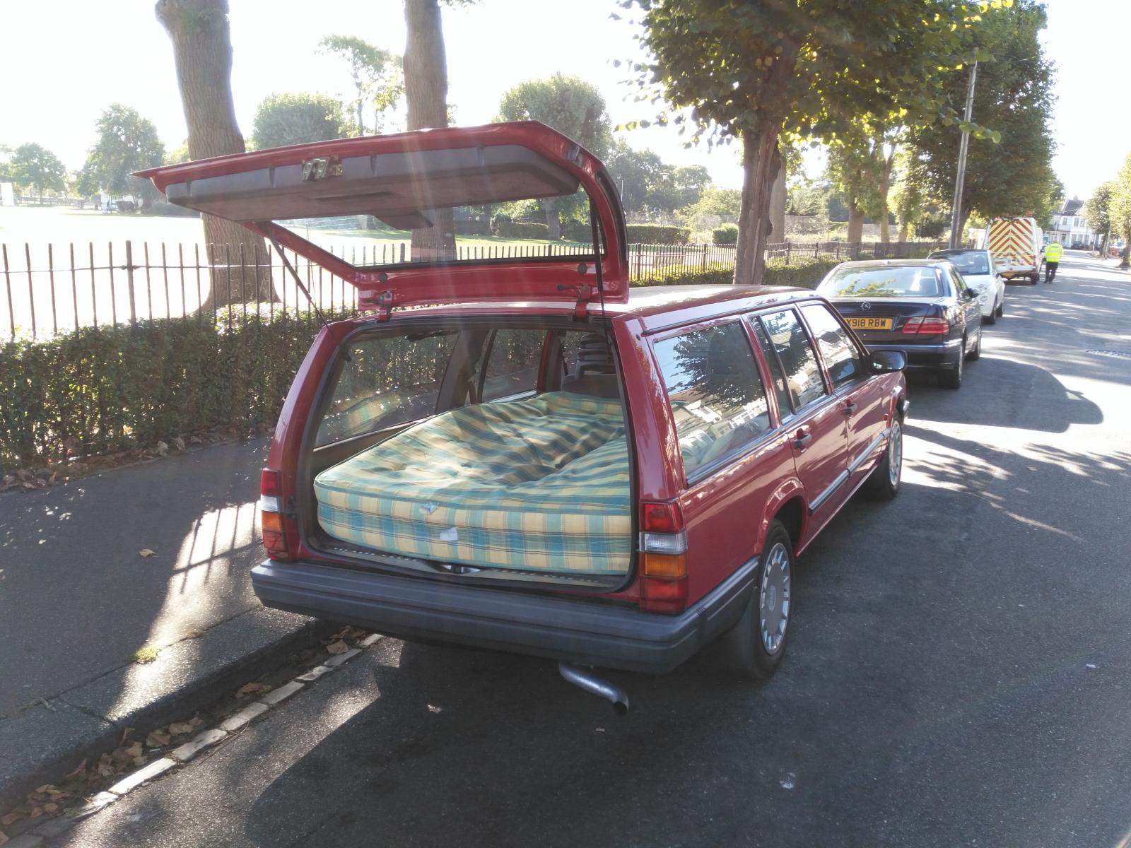

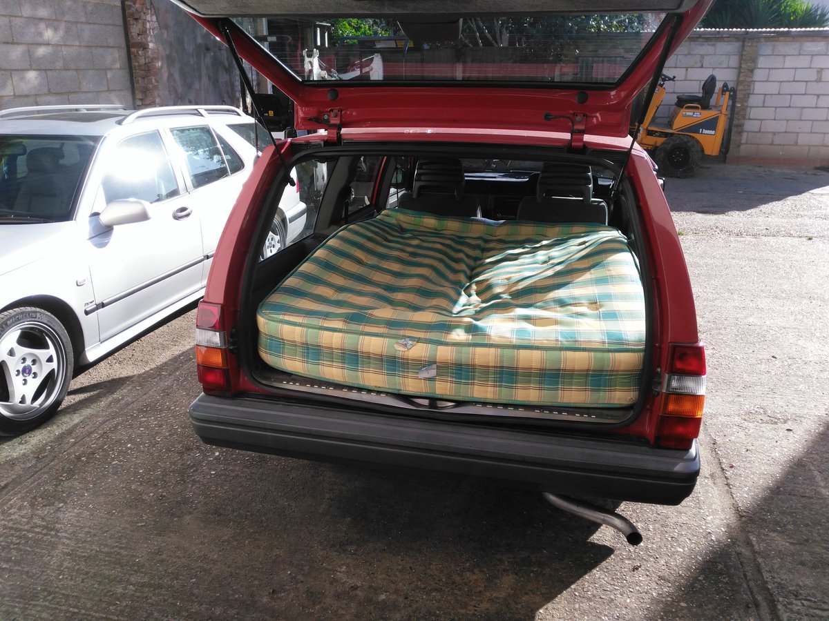

Shep Shepherd Posted September 23, 2016 Author Share Posted September 23, 2016 The Aero might be a fab car, but its size and shape means it's bordering on being a 'lifestyle' estate car, so there's no way that you'd be able to get a tip-bound double mattress in the back of it without a huge struggle, which is where The Volvo comes in: Despite having owned it for almost 13 years, the car's load carrying capacity never ceases to amaze me Link to comment Share on other sites More sharing options...
alfetta Posted September 23, 2016 Share Posted September 23, 2016 Done that in a 80's 'classic' saab 900 hatch. got a fridge freezer in there too. Shep Shepherd 1 Link to comment Share on other sites More sharing options...
