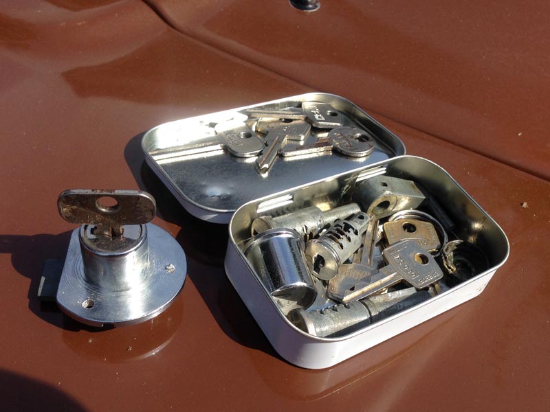

Conrad D. Conelrad Posted August 17, 2016 Author Share Posted August 17, 2016 This thread was decimated by the board kerfuffle, and I can't be arsed re-creating it. So here's a summary of the events so far, as I remember them. The photo of the interior is gone, so here it is again: 1981 Vanden Plas 1500 Interior by Conrad Conelrad, on Flickr After only four days ownership I took it for an MOT, where it failed on both rear wheel bearings. Not bad, except it only passed the emissions by the skin of its teeth. A bit of carburettor adjustment has hopefully remedied this, plus its inability to better 24mpg. But more importantly, there was no key for the glovebox. I was going to knock the barrel out re-arrange the pins, but I didn't have to - it has the same key number as my Rover's doors. Sorted! I made it up some better foglights from the spares box. The old ones have this lovely Allegro branded glass, so I'm keeping the unbroken one. The interior lights were not working. When I got under the dash I discovered that someone had cut their feed wire, and when I re-connected it, they shorted and blew the fuse. It still happened with all the light units removed, so it was a fault with the wiring. Yesterday while removing the headlining trim I noticed one oversized screw holding the driver's side sun visor in place. Could someone have driven this over long screw through the wiring? Yup. And with that, the thread is up to date. Next post: fixing this, which is what the headlining does when you drive with the passenger window open. Dippy, trigger, Junkman and 21 others 24 Link to comment Share on other sites More sharing options...

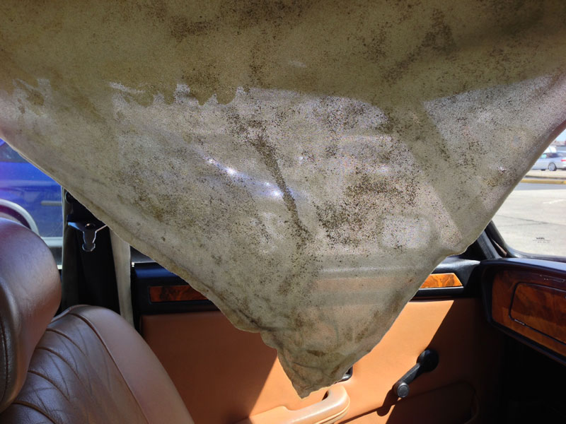

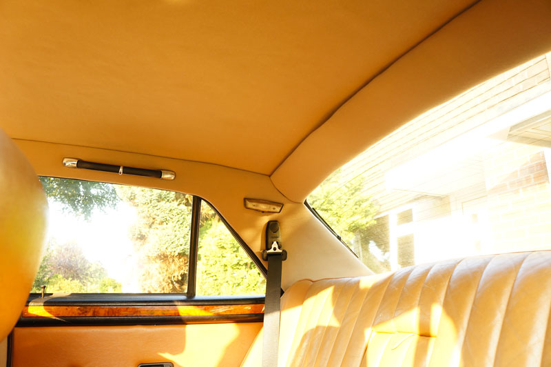

Conrad D. Conelrad Posted August 18, 2016 Author Share Posted August 18, 2016 Alright, the headlining. Not only did it lovingly stroke the top of your head, it was filthy and ruined from previous owner's attempts to glue it back. All of the side trim pieces were baggy, stained, and marked. Out it all comes: I hunted down the most appropriate replacement cloth - three meters of 'mushroom' brushed nylon with foam backing - and got stuck in to several hours of removing staples, measuring, cleaning spray adhesive off the cat, cutting material, getting cat hair off the material, gluing etc. Here is the result: There are a few loose ends to tidy up, but considering I've never done anything like this before it's not half bad. There are a few wobbly bits, but most of the blame lies with the 35 year old wobbly cardboard substrate. The headlining itself isn't as smooth as I'd have liked, but, again, the fibreglass(?) panel was rough and damaged. There is also a small crease by one of the sun visors which I will see every time I drive the car. Still, just a bit better than it was. Oh, and once it was all finished I reconnected the battery and the fuse box started smoking like a poorly prepared barbecue because I've shorted out the lights again. lmao Bucketeer, Shep Shepherd, Junkman and 30 others 33 Link to comment Share on other sites More sharing options...
Skizzer Posted August 18, 2016 Share Posted August 18, 2016 That looks STUNNING! Fantastic job. oldcars, Conrad D. Conelrad and tooSavvy 3 Link to comment Share on other sites More sharing options...
nacho man Posted August 18, 2016 Share Posted August 18, 2016 /\/\ looks brill!!!!! Conrad D. Conelrad 1 Link to comment Share on other sites More sharing options...
Ghosty Posted August 18, 2016 Share Posted August 18, 2016 That's a world of improvement.Does it blend in as well as it looks to? Link to comment Share on other sites More sharing options...

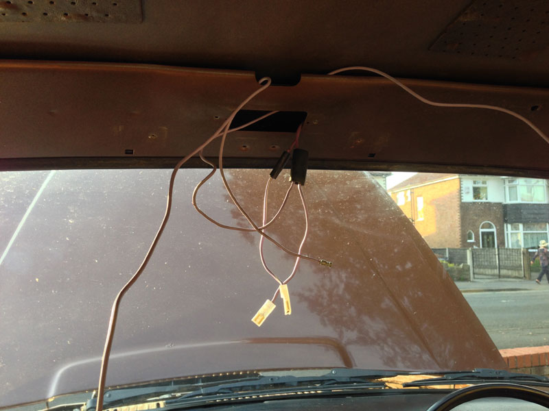

Captain Furious Posted August 18, 2016 Share Posted August 18, 2016 That is a wonderful job on the headlining, doffed cap in your direction That interior light wiring, ordinarily it would be clear that it is the bodgery of some shaved ape, but in this case it may well be factory, am I right? Link to comment Share on other sites More sharing options...
Conrad D. Conelrad Posted August 18, 2016 Author Share Posted August 18, 2016 Oh no, now I mustn't smoke in it anymore, mustn't I? Oh, please smoke in it. It smells like a week old Auris now. Yeah, do you wanna do the Piazza's head lining if I get the material in? Sure, why not. How bad could I fuck it up? That's a world of improvement. Does it blend in as well as it looks to? Yes! It's slightly lighter and beiger than the original, and goes with the seats a little better. That is a wonderful job on the headlining, doffed cap in your direction That interior light wiring, ordinarily it would be clear that it is the bodgery of some shaved ape, but in this case it may well be factory, am I right? All that purple wiring? Which runs over razor sharp bodywork edges? With piggyback junctions in inconvenient places? That's factory, of course. Captain Furious, Cleon-Fonte, Junkman and 3 others 6 Link to comment Share on other sites More sharing options...
Jon Posted August 18, 2016 Share Posted August 18, 2016 Despite someone on here warning me that spray on glue would not be up to the job of sticking a headlining successfully to the backing card, I proceeded anyway and as a result, the Visa's headlining has sagged monumentally again at the back. I've got visitors from the UK coming out next month, so let me know what product you used and I'll ask them to bring some of it out. Despite living here almost 6 years, I still wouldn't know where to look for certain things like this. I think it's fair to say that this looks great, and not even in an ironic hipster-ish sense. Link to comment Share on other sites More sharing options...
