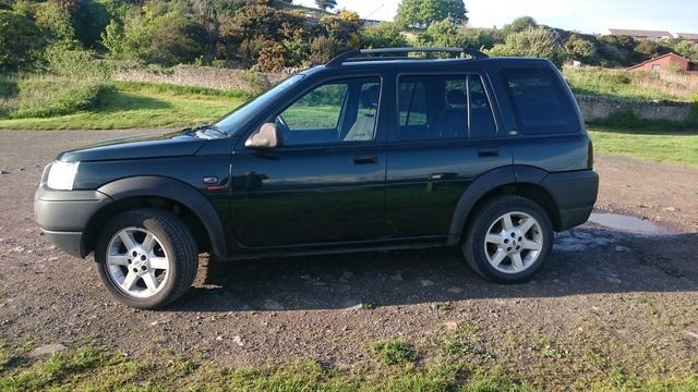

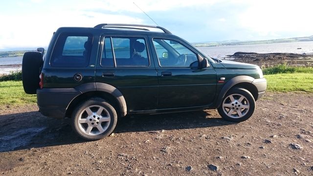

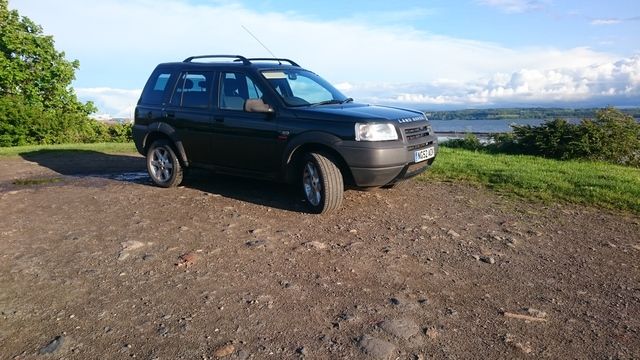

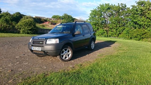

dome Posted June 25, 2016 Author Share Posted June 25, 2016 Well, now that the Locost is functioning (mostly) I suppose I'd better pay this thing some attention. Today I fitted the new drivers window regulator which was pretty straightforward. I then cleaned out the idle control valve as it was idling fairly shit. It's a lot better now. I then gave it it's first proper was in my charge. It's Saturday night, treat yourselves to this beauty... Cavcraft, phil_lihp, Lacquer Peel and 1 other 4 Link to comment Share on other sites More sharing options...
