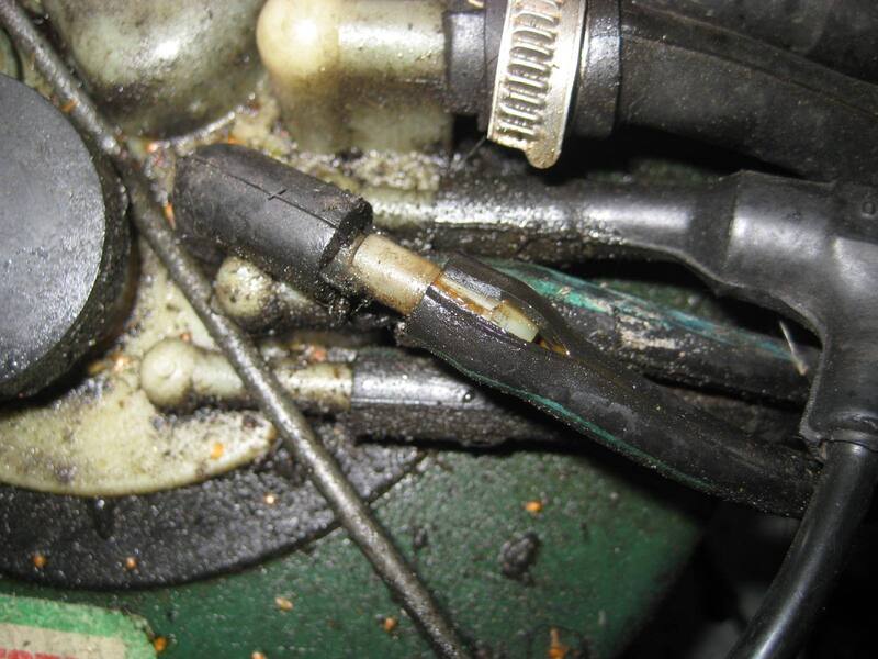

strangeangel Posted January 22, 2017 Author Share Posted January 22, 2017 Getting at the pressure release screw wasn't too bad. I moved some pipework... Link to comment Share on other sites More sharing options...

strangeangel Posted January 22, 2017 Author Share Posted January 22, 2017 Hoses off the reservoir next, spotting another little problem in the process! Link to comment Share on other sites More sharing options...
