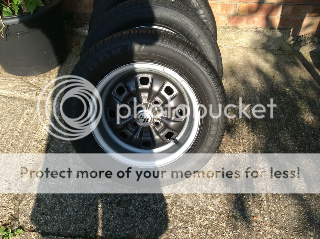

danthecapriman Posted August 25, 2016 Author Share Posted August 25, 2016 I've finally got some suitable wheels for this.I wanted to go back to the 'sport' style steel rims this car had on it originally. They were the 5x13 type just about all old Fords seemed to have at the time but they were rusty and battered so like an idiot I threw them in the scrap skip preferring instead the mk3 'Laser' 4 spoke alloy wheels.I do really like the alloy 4 spokes but they don't fit the look I'm going for with this car. So, I looked for a set of the sports steels to go back on the car, but being an inch narrower than the alloys wondered about the look of them. I also seem to remember when I had these wheels originally the car didn't feel as good on corners. The skinny tyres seemed to roll a bit and weren't that grippy.The answer was to find a set of the 5.5x13 deep dish 'sport' steels, they look exactly the same but have a much better look and are wider too.As it turned out these weren't that easy to find! I think they might be popular with the Escort lickers too which means they are a bit more pricey!In the end I asked a few Ford specialists to find me some but also kept an eye out myself. IMG_0266 by Dan Clark, on Flickr IMG_0267 by Dan Clark, on Flickr These ones came from Germany in the end, three of them are almost like they've never been used and are extremely clean for their age. I'm still going to get them fully stripped and powder coated though and I have a decal set coming too for the black inlays around the air holes in the wheel centres to give them the as new look the rest of the car will get, aswell as a set of nice new tyres when the time comes.I'm dead pleased with these, I think they're a lovely looking wheel and should finish the car off nicely.Luckily I kept my original wheel nuts and stainless centre caps which will be cleaned up and in the case of the nuts be re chromed. Hopefully the week after next I'll be going to see the car again to swap these wheels for the Laser alloys which I'll shift on. Skizzer, eddyramrod, Shep Shepherd and 10 others 13 Link to comment Share on other sites More sharing options...
fordperv Posted August 25, 2016 Share Posted August 25, 2016 I love dartboards, are you going to have them all silver or are you going with black inserts? danthecapriman 1 Link to comment Share on other sites More sharing options...
oldford Posted August 25, 2016 Share Posted August 25, 2016 For some reason I think that the Capri wheels were all silver. The decals on the face of it seem a good idea, however you'll still need the black the edges. Whenever I've painted these wheels, I've done them black first, then masked the black parts and painted the Silver. I wonder if you could follow the same route with the powder coating, but using the decals as the masking medium with masking tape on the edges? danthecapriman 1 Link to comment Share on other sites More sharing options...

Tamworthbay Posted August 25, 2016 Share Posted August 25, 2016 Every one I remember had the black painted, including all of mine. The laser alloys were silver but had black bits painted in on some others. Maybe that's what they are thinking of perhaps? Link to comment Share on other sites More sharing options...
danthecapriman Posted August 25, 2016 Author Share Posted August 25, 2016 I love dartboards, are you going to have them all silver or are you going with black inserts?For some reason I think that the Capri wheels were all silver. The decals on the face of it seem a good idea, however you'll still need the black the edges. Whenever I've painted these wheels, I've done them black first, then masked the black parts and painted the Silver. I wonder if you could follow the same route with the powder coating, but using the decals as the masking medium with masking tape on the edges?I'm going to have the little black inserts, I think it makes them look a lot less plain with them.My old 5x13 versions I had when I bought this car did have the black inserts so it's a feature I'd like to retain, also, if you look at the pic, the wheel in the centre of the stack at the bottom still has them.I will as you say have to get some satin or matt black paint to do the edges with as the decal won't cover it. Not caught this thread in a while. I admire your ethos with this, should look excellent and 'right' when you're done. I'm amazed how solid it appears to be in those post-blasting pics, not at all what I expected to see of a Capri.Yeah, I've nothing against modified cars at all but I just think with this one being a fairly unusual base spec and such an early car it'd be nice to get it back to as close to original as possible, while putting my own stamp on it by picking the colour I want most etc.It does seem to have survived remarkably well for such an old Ford, especially as it's lived near the sea most of it's life before I bought it. It's not low mileage either at 140k odd. It's a hell of a relief though! I was shitting myself before it came back from the blasters, wondering what, if anything, would come back! I'm sure my Capris had black painted bits in the wheels, although as neither was a new car at the time that may not have been original, one did have the very nice trim-rings on it which I think were original, as it was a swish GL no less.I did consider trim rings. But it didn't have them when I first had it, and being an L model I thought it might be a bit too bling! Link to comment Share on other sites More sharing options...

Essex V6 Posted August 26, 2016 Share Posted August 26, 2016 I'm sure my Capris had black painted bits in the wheels, although as neither was a new car at the time that may not have been original, one did have the very nice trim-rings on it which I think were original, as it was a swish GL no less.They definitely came with black inserts originally Link to comment Share on other sites More sharing options...

oldford Posted August 26, 2016 Share Posted August 26, 2016 Looking at some 1980/81 &1982 brochures the 5" sports rims had the black bits and the 5.5" sports rims were all silver. It was the MK3 GL models that had the 5.5" wheels, though the February 1980 brochure shows the GL as having the 5" wheels with the black bits. Link to comment Share on other sites More sharing options...
Tamworthbay Posted August 26, 2016 Share Posted August 26, 2016 My GL was an 81 had the 5.5 rims (with 205s squeezed on) and black bits painted in. Link to comment Share on other sites More sharing options...
danthecapriman Posted August 26, 2016 Author Share Posted August 26, 2016 The deep dish 5.5 sports came out late 72 on the Mex and RS1600. All silver, no black bits. From summer 73 the RS2000 had them too, some had graphite centres with silver rims.Mk1 and Mk2 Cappas never had the deep dish sports wheels from the factory, only the standard offset 5.5, even 3.0 models, although theoretically they are period correct dealer options and the black bits do look better IMO. Don't know why Henry didn't just offer these as standard as they couldn't have cost any more to make than the narrower-looking 5.5s.Mk2 RS Esccorts - Mex, RS1800 bda & RS2000 base-spec had the deep dish sports steels, all silver. As did Mk3 Cappa 2.0GLs around 1981 W-reg to use up old stock.Trim rings look fake bling shite.Fantastic Cappa thread by the way, thanks for your time posting. Tin of black enamel and a steady hand will have your wheels looking ace.This is about my understanding of things.No mk1 or 2 Capri had these wheels from new, but as you say they were an optional extra dealer item so anyone could of gone into a Ford dealer and bought a set for a Capri, Cortina or Escort.This seems to be why I've found these wheels hard to find and more expensive than I'd like as they are part of the Escort Mexico/RS bollocks, hence the tax is higher on them! Mine did have the standard 5x13 version with the black bits but I'm going to use these as it retains the original appearance but also gives me the advantage of the wider rim. The laser alloys it did have fitted were 6x13 so it's not too different. Besides that I love these wheels and with the black bits added they'll look great on the car. Skizzer and eddyramrod 2 Link to comment Share on other sites More sharing options...
danthecapriman Posted August 26, 2016 Author Share Posted August 26, 2016 From summer 73 the RS2000 had them too, some had graphite centres with silver rims.Funny you mention this bit. I also now have these! Same wheel but in this (IMHO rather unattractive) colour scheme.I said I'd found it hard to find them and that I like them so when these also came up I bought them too! These are a set of 4 so I still need to find another one for a spare.I'd planned to use the best condition 5 wheels for my car then sell the other 4 but they are all in very good straight nik so it didn't matter in the end. I'm going to keep the tyre less ones and get them reconditioned for my mk2. These ones will need the same treatment so I'm not gaining anything by mixing and matching them.I don't know weather to keep them, find a spare to make a set of 5 then recon them or just sell them tbh.Plus I've still got to go get the Laser alloys back so I'm flush with Capri wheels at the moment! NorfolkNWeigh, eddyramrod and holbeck 3 Link to comment Share on other sites More sharing options...
Tamworthbay Posted August 26, 2016 Share Posted August 26, 2016 Funny you mention this bit.I also now have these! Same wheel but in this (IMHO rather unattractive) colour scheme.I said I'd found it hard to find them and that I like them so when these also came up I bought them too! These are a set of 4 so I still need to find another one for a spare.I'd planned to use the best condition 5 wheels for my car then sell the other 4 but they are all in very good straight nik so it didn't matter in the end. I'm going to keep the tyre less ones and get them reconditioned for my mk2. These ones will need the same treatment so I'm not gaining anything by mixing and matching them.I don't know weather to keep them, find a spare to make a set of 5 then recon them or just sell them tbh.Plus I've still got to go get the Laser alloys back so I'm flush with Capri wheels at the moment! if you are selling the steelies as well let me know..... danthecapriman 1 Link to comment Share on other sites More sharing options...
NorfolkNWeigh Posted August 26, 2016 Share Posted August 26, 2016 MuthaN had a 1975 N reg 1600 XL in red with a black vinyl, from when I was 14 to 18. I painted the sports wheels with black gloss and nicked some trim rings off a brand new Cortina GL on the forecourt of our local Ford dealership. I liked to think it looked like those RS steels. When I started driving it at 17, I put 51/2j 'Lotus' Cortina* steels on it with 185/70s. Proto OldSkoolford Racist style.In the 80's you could buy templates to mask the black and silver from the blokes at car auctions that sold giant cans of tyre black, seat covers and stickers that said 'Car of the week' or ' Heated Rear Window'. eddyramrod and danthecapriman 2 Link to comment Share on other sites More sharing options...
