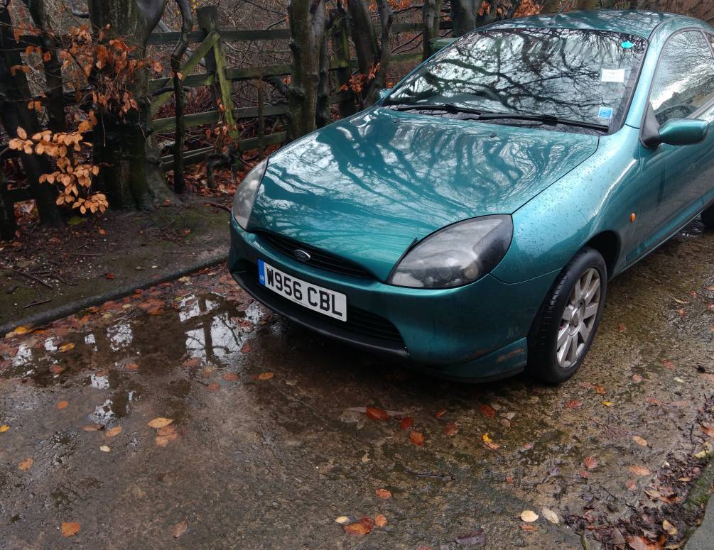

The Moog Posted November 26, 2017 Author Share Posted November 26, 2017 Yesterday the puma decided to signal it's displeasure at being the only car on fleet by screeching when turning left. It was a bit too much noise to ignore. So braving the miserable weather I set to it. God that puddle is right where I need to be. Jacked it up and lobbed stand underneath. The wheel was really stuff to turn. Wheel off. Brake disc is sticking which isn't great. It has had new calipers (which I rebuilt) and new pads. Discs are a few track days old. They don't look or feel warped. Jacked up the other side and put it into gear Passenger side was fine Driver's not so A job I think for the warmer weather. At this point I just got on with the investigation. It looks like the braided line had popped out of the holder and was rubbing on the wheel. Couple of cable ties and all back together. Test drive and it has stopped screeching. Still grinds a bit turning left but that is the strut brace I think. Coprolalia and Skizzer 2 Link to comment Share on other sites More sharing options...

The Moog Posted November 26, 2017 Author Share Posted November 26, 2017 Hope you left enough slack for the steering to turn when fully extended? I've seen that mistake & it made a right mess (in their y-fronts) when the brakes had gone missing.Yep tested full lock both ways. It is just running through a cable tie loop so enough flex in it J4mes 1 Link to comment Share on other sites More sharing options...
