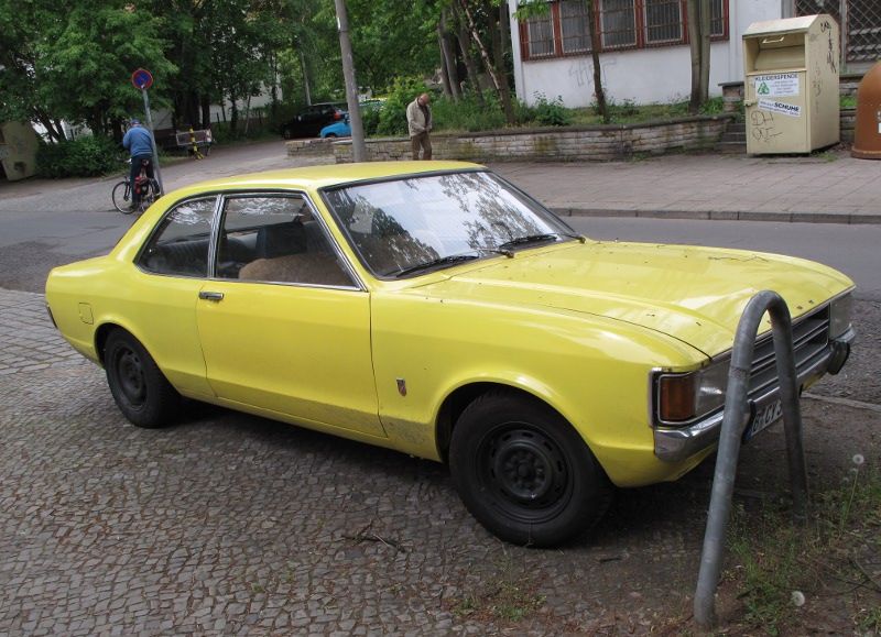

fotorabia Posted July 5, 2015 Share Posted July 5, 2015 Still a few floating around Berlin..or Germany in general.project for sale in Bremen.,,not the one pictured!http://suchen.mobile.de/auto-inserat/ford-granada-bremen/211691208.html?enforceChannel=Mobail anonymous user, trigger and vulgalour 3 Link to comment Share on other sites More sharing options...

PiperCub Posted July 5, 2015 Share Posted July 5, 2015 Never knew a 2 door saloon existed. Thought they were all coupes. You live and learn. Link to comment Share on other sites More sharing options...
