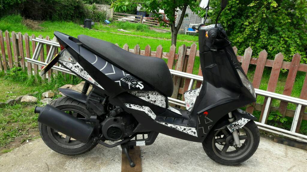

strangeangel Posted December 11, 2017 Share Posted December 11, 2017 crank is bent Do not like Link to comment Share on other sites More sharing options...
Dave_Q Posted December 11, 2017 Author Share Posted December 11, 2017 Yeah I know, still it's better to find out now than when I try to start it up. I will just have to do the mains on the other one, parts aren't expensive although I haven't got a suitable puller for the flywheel. You haven't got one by any chance? I think the flywheel thread is M26x1. Link to comment Share on other sites More sharing options...
strangeangel Posted December 11, 2017 Share Posted December 11, 2017 You haven't got one by any chance? I think the flywheel thread is M26x1. No, pretty sure nothing I've got will fit that, unfortunately. On the upside they can be had for a tenner off teh 'Bay and, as you say, mains and seals for it won't break the bank. Link to comment Share on other sites More sharing options...

Dave_Q Posted December 13, 2017 Author Share Posted December 13, 2017 Had an hour stripping down the 2 rank ped engines, I haven't got a flywheel puller yet so I stripped the variator sides on both of them. Pros:Gearboxes seem to be OK on both and there is one set of good variator parts between the 2. Cons:On the one with the non-bent crank, the end of the crank sheared off with the nut when trying to undo it. The spline was damaged where the outer plate of the variator sits, so had it not sheared off it wouldn't have been usable anyway. Link to comment Share on other sites More sharing options...

Dave_Q Posted December 18, 2017 Author Share Posted December 18, 2017 Minor progress tonight. Got the cases split and the crank out. Here is the leaky main seal confirming my ghetto inner tube test diagnosis. I am picking up a heat gun tomorrow to install the mains, so I sorted out a couple of snapped off bolts on the generator cover. Filed the snapped bolt flatish and centre punched. Drilled it out. The new hole came out a bit off centre, but I managed to tap it OK. With some minor "clearancing" to the hole on the plastic cover, this will go together nicely. Cavcraft, UltraWomble and strangeangel 3 Link to comment Share on other sites More sharing options...

Dave_Q Posted January 13, 2018 Author Share Posted January 13, 2018 Slow progress on this but the engine is finally ready to go back in. Malossi YO air filter. Cheaper than standard and still a big improvement on the cone filter that was on it. It took a couple of goes to get the mains seated properly, the first time it was really stiff turning over as one wasn't quite pressed all the way in. I actually built it all the way back up before deciding to go back and fix it properly, so I ended up needing a second top end gasket set but they're only cheap. The thing better run OK now or it will be off to ebay SPURS O RAEPERS as I don't think I've got the will to strip it down again. strangeangel and Bucketeer 2 Link to comment Share on other sites More sharing options...

Dave_Q Posted January 17, 2018 Author Share Posted January 17, 2018 Sorry shit moped fans, you'll have to bate that breath a while longer. A combination of child activities and weather means it's not back in yet. Here's a boring indoor update. I ended up with 2 exhausts for this, an Arrow and and a Leo Vince. I want to use the Leo Vince for maximum performance and ped cred, but it looks like it's been subject to a precision* paint job in the past. 5 mins with some thinners and a cloth later: In a world where I cared more I might try and derust the expansion chamber and paint it or something, but this is not that world so I left it there and went for a sit down. UltraWomble, Bucketeer and strangeangel 3 Link to comment Share on other sites More sharing options...
Dave_Q Posted January 20, 2018 Author Share Posted January 20, 2018 Progress today, sorry no start up video as I got it all fitted, pressed the button and found the battery was flat. Had a hitch with the exhausts, tried to fit the Leo Vince but it would't go. It seems to be longer. Bit odd as most places list all Piaggio/Gilera 50s as fitting the same exhaust, that one is off an NRG and it's clearly a bit longer. Never mind, it should fetch a few quid on ebay. Battery on charge, startup hopefully tomorrow depending on weather and battery. Link to comment Share on other sites More sharing options...

Dave_Q Posted February 4, 2018 Author Share Posted February 4, 2018 Still no start for this flipping moped. Have had a few goes but not firing, definitely got a good spark as tested it, but it won't run even on brake cleaner. I did think I might have cracked it when I noticed that the brake cleaner spray was pulsing back out of the inlet leading me to suspect the reeds. Rubbish picture but you shouldn't be able to see light there. I adjusted them and got them to look like they're sealing but it still won't run. It could probably do with new reeds but I reckon they're not the problem, I reckon I've done something fundamental wrong in the assembly and the cases still aren't sealed right. Link to comment Share on other sites More sharing options...
DodgeRover Posted February 4, 2018 Share Posted February 4, 2018 Have you checked the flywheel key hasn't moved? Piston isn't in back to front is it? Arrow points to exhaust port. I can't imagine you've cocked anything up that badly tbh, did you ever have this running previously? Link to comment Share on other sites More sharing options...
