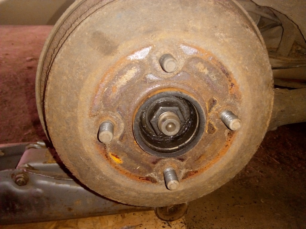

dave21478 Posted November 22, 2016 Author Share Posted November 22, 2016 I havent updated this thread in about a year and a half because....well, the bloody car just quietly gets on with the job of being a car and never needs anything.I think in that time I have put some tyres on it and done an oil change, but thats pretty much it. Oh, front discs and pads too.Obviously I hotted up the tunez early on with a Kenwood headunit and speakers, cheapy amp and sub box. I do that to all long-term cars because I am mentally still 17 and pumping out mid 90's dance tunes is just the way I roll. And have rolled. Since the mid 90's. Over twenty years ago. fuck.Anyway, the car is blandly dependable.....A few squeeks from the tailgate, the clutch is getting a bit juddery....I sometimes think its down on power, but then I realise its only a wee 1.6 and its probably pretty average. Even the aircon still works.There is a fist-sized rot hole in the middle of each sill and they are crispy along about a third of their lengths.....Thats not an issue here, and neither is the rot in the chassis rail near the rear spring mounts. Weld it? not weld it? I think not, TBQH. We will see the state of play in April when the current CT runs out, but I reckon it will be time for a change and the MGF can come out of hibernation and have the Escort insurance swapped onto it. In the meantime it wil be my winter beater again. I even have a set of proper winter tyres for it on spare rims. The reliability streak was SHATTERED recently when a rear wheel bearing started getting grumbly. I was just going to leave it till spring when it is likely to be bridged retired, but its got oppressively loud so I thought I better do something about it. Wheel off... That hubnut is proper tight, but my cordless impact rattled it off after a few seconds.Drum off...Clean enough in there...nothing to be concerned about. The inner oil seal needs pulled out then the taper roller bearings inner parts just fall out, leaving the outer races pressed into the drum, requiring knocked out.....Note, one goes out towards the rear and the other to the front. One came out easy with a hammer and drift, the other wasnt having it. Top tip....run a fat bead of weld around half the circumference of the inner race (dont weld it to the drum though, you plum!) The heat helps dislodge the parts and as the race cools it contracts and pretty much just falls out. Aaaand the new part is completely the wrong size. Obviously. So reassembly will have to wait. Lacquer Peel, Stanky, Jim Bell and 2 others 5 Link to comment Share on other sites More sharing options...

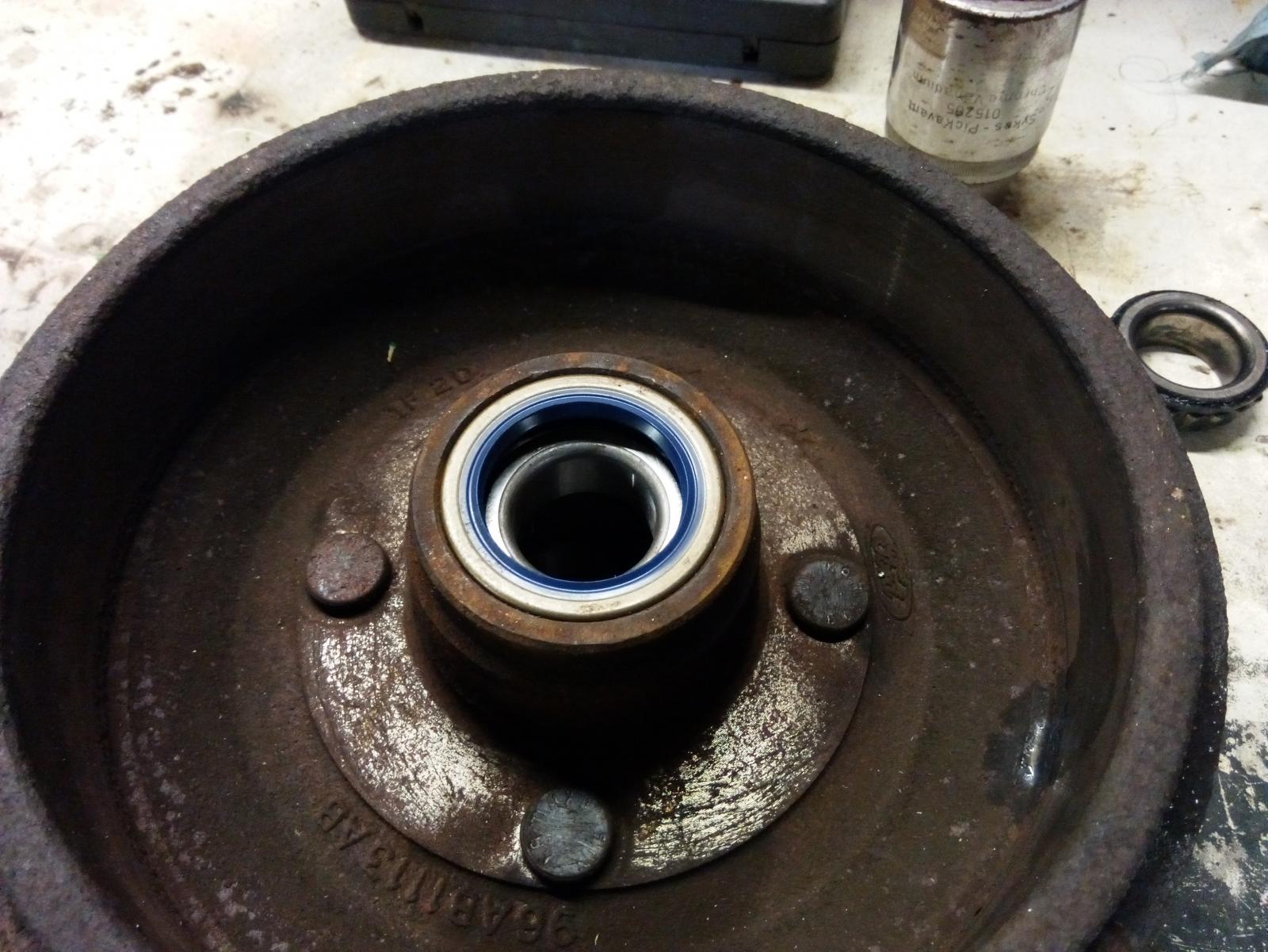

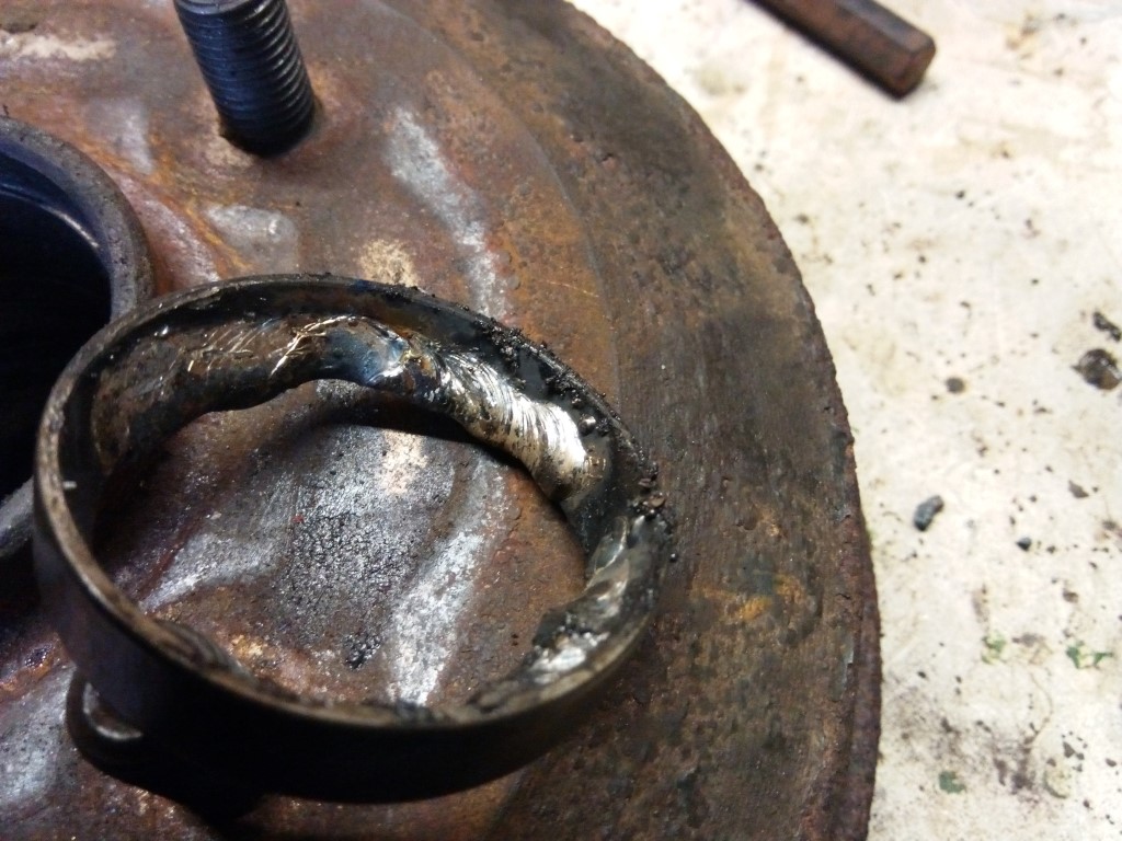

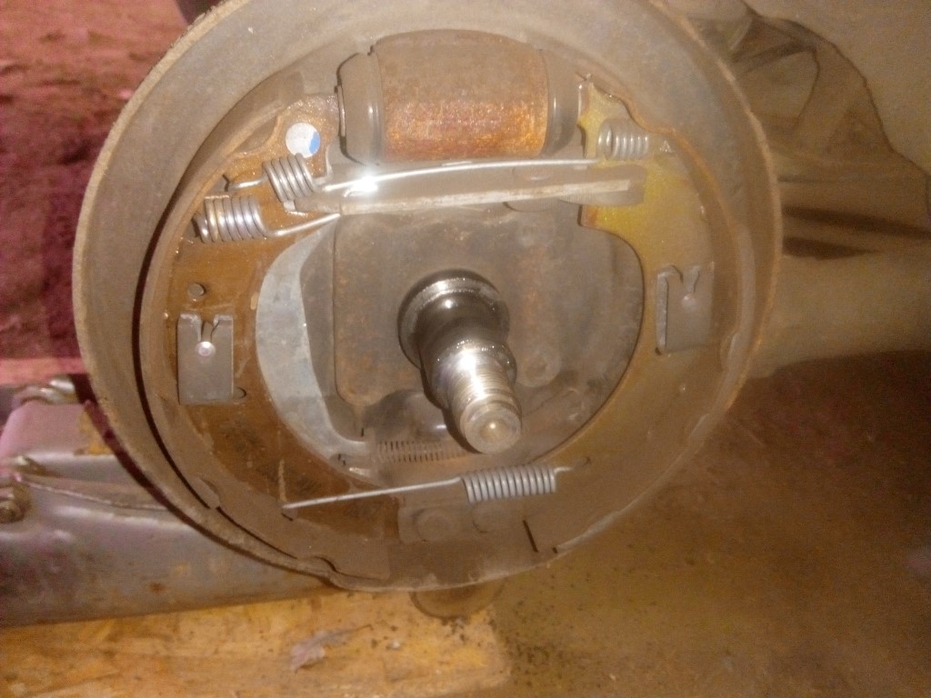

dave21478 Posted November 28, 2016 Author Share Posted November 28, 2016 The right bearing finally turned up so I got this back together.Clean up the hole where it mounts in the drum and press the outer race into place. I dont have a press (might make a wee one this winter actually) so just tap them in. In this case a 1 1/2 inch socket is a nice fit. It presses on the outer race so no damage to the bearing itself. Knock the oil seal into place... and then flip over to do the other side of the bearing. Once they are snug give it a bit of grease, put it back on the car and tighten the hubnut. 260NM in this case, according to Autodata. Went for a run and its nice and quiet. BorniteIdentity, DeeJay, RobT and 4 others 7 Link to comment Share on other sites More sharing options...
