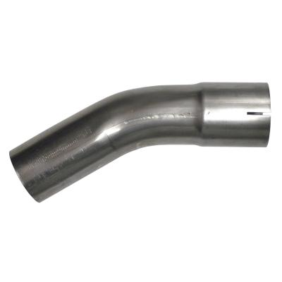

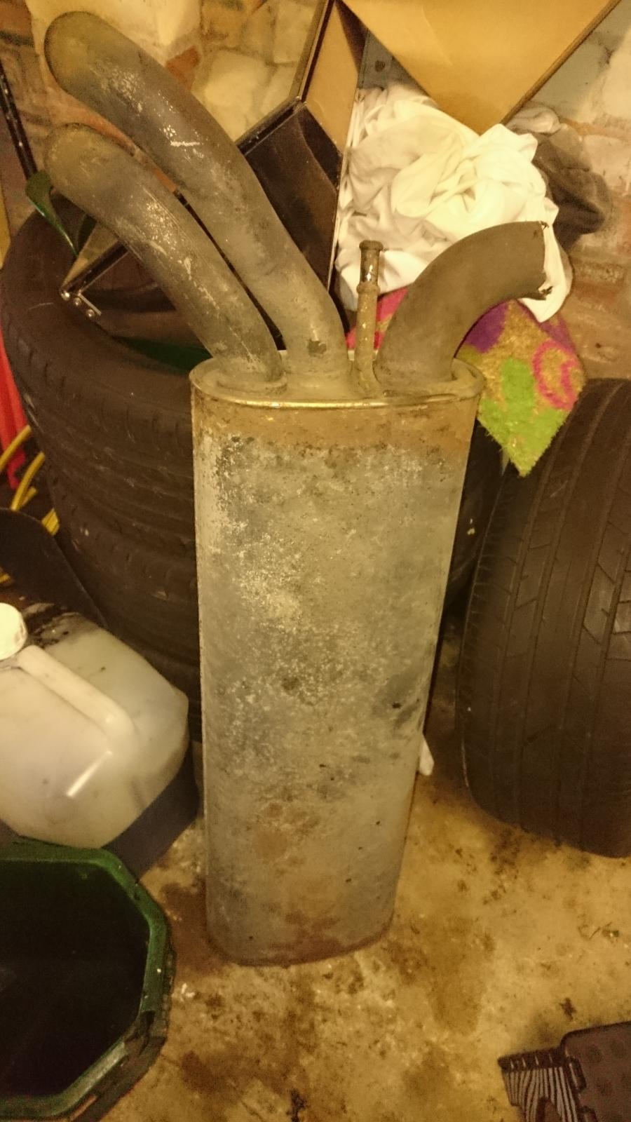

dome Posted May 7, 2015 Author Share Posted May 7, 2015 Been gathering together bits and bobs to get this thing the way I want it-all of the stuff I meant to do when I first got it but somehow the cylinder head shitting itself got in the way of things... First up, viton o rings for the fuel pump with copper washers-the original ones don't last long on veg and start to leak-I have the special tool which I bought for my previous Mercs so this should be easy enough. At the same time I'll do the fuel tank strainer-a new one has been bought and I'll keep the old one to swap over if it clogs up on veg. Second thing is the back box-one of the mounts has rusted off A new rear section is £ far too much. One of these cost me £15 posted Yes, it's a bit of pipe with a 30 degree bend. Back box chopped off and that will be made to fit with some quality* engineering. It won't be visible from outside and won't be too noisy, at least for me in the drivers seat. Finally last night I picked up these bad boys Staggered 18" AMG alloys for £ far too little. They seem round and have mostly legal tyres. I wanted to go for 17"s but these came up locally at the right price. Had to order different wheel nuts which I'm waiting for and then they'll bolt on. Hopefully won't be too bling as they are standard Merc alloys and it's bound to look better than the current 16" alloys. Am away his weekend but this is my mission for the next week or so. Will check out the brakes/suspension too when I'm swapping wheels as there's a clunk from the front that sounds like a drop link. If this goes to plan then a couple of cheeky mods from the Merc forums using strategically wired resistors will give it an EGR delete(handy when running on veg) and more boost. In the midst of all this I managed to buy a Ford Fusion TDCI with a blown turbo-got it home on the Sunday, turbo off that night, striped it on Monday and ordered the parts and rebuilt the turbo and did 100 miles on the Tuesday night Just waiting for the V5 to come in and I can flog it! mercrocker and Junkman 2 Link to comment Share on other sites More sharing options...
dome Posted May 11, 2015 Author Share Posted May 11, 2015 Made a start to the next stage of work on this in between the horrible showers today. Mr. Grinder, meet Mr. Old and Knackered Backbox. New "tailpipe" fitted succesfully-makes it look vaguely respectable and directs gases in the right direction. Verdict-Sounds good with only a slight noise increase in the cabin. Seems to have given it a bit more oomph too. Win. Link to comment Share on other sites More sharing options...
320touring Posted May 11, 2015 Share Posted May 11, 2015 Nice one:) got a link to where you got the pipe? I need to sort out the polo exhaust... Link to comment Share on other sites More sharing options...
dome Posted May 11, 2015 Author Share Posted May 11, 2015 Got it from thes guys-pretty cheap and decent quality. https://www.merlinmotorsport.co.uk/s/exhausts/jetex-performance-exhaust-systems-parts Link to comment Share on other sites More sharing options...
Lacquer Peel Posted May 11, 2015 Share Posted May 11, 2015 Someone has done that with the back box on my Volvo, but welded a straight piece of pipe in its place. I could do with a down swept finisher because all the stour goes on the bumper. Turbo diesels don't need much in the way of silencing and do go better without a restrictive back box. Link to comment Share on other sites More sharing options...

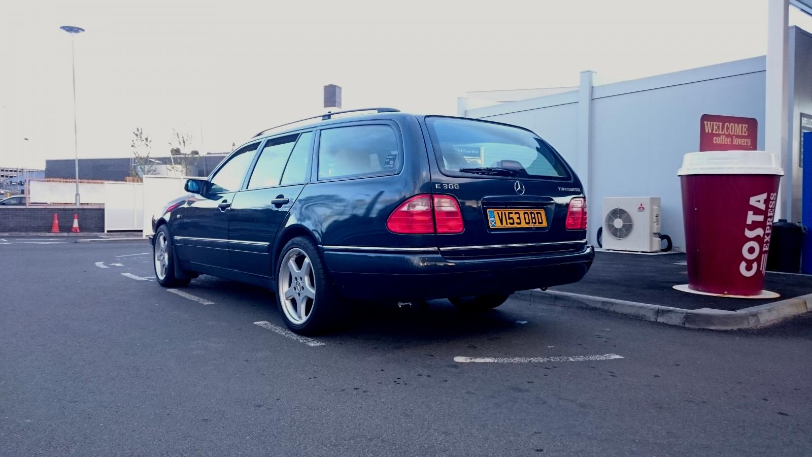

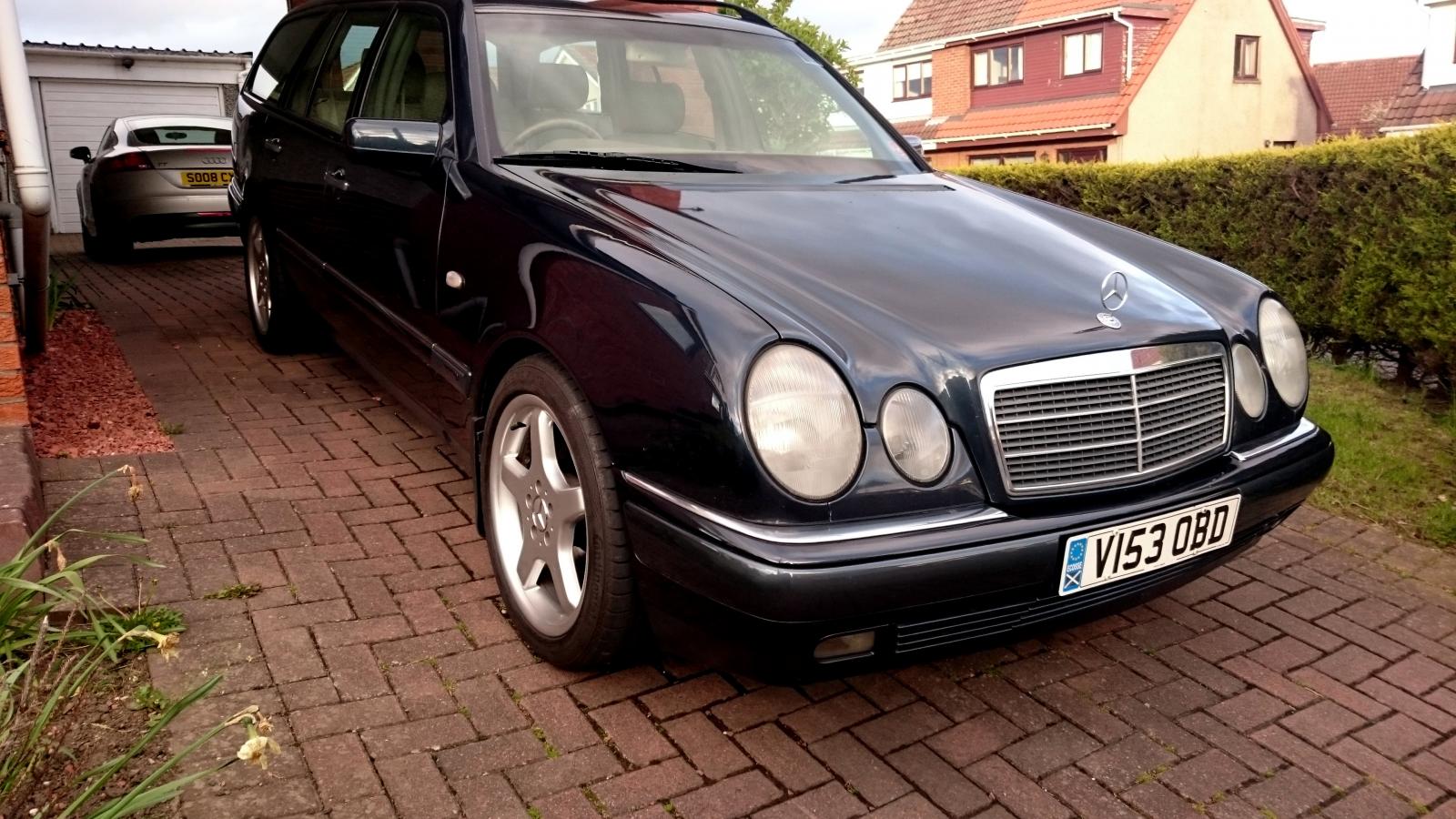

dome Posted May 12, 2015 Author Share Posted May 12, 2015 Got the alloys on-looking a lot better than on the old wheels and it feels like it's sharpened the car up a bit. New exhaust is almost too quiet from inside but it does have a nice almost V8 like burble going on. A couple of quick pics after fitting them cort16, nacho man, billyboy406v6 and 3 others 6 Link to comment Share on other sites More sharing options...
320touring Posted May 12, 2015 Share Posted May 12, 2015 "Aaah yeah, bitches be cray fo mah wagon!" "Amma fry der chip furrem fore they know what hittem, BAAAYM!" Looks good chief dome 1 Link to comment Share on other sites More sharing options...
dome Posted May 12, 2015 Author Share Posted May 12, 2015 "Aaah yeah, bitches be cray fo mah wagon!" "Amma fry der chip furrem fore they know what hittem, BAAAYM!" Looks good chief Cheers. I'm going for the antique drug dealer look. With the added aroma of chips... Link to comment Share on other sites More sharing options...
320touring Posted May 12, 2015 Share Posted May 12, 2015 Cheers. I'm going for the antique drug dealer look. With the added aroma of chips...I shall order the chrome arches post haste. dome 1 Link to comment Share on other sites More sharing options...
