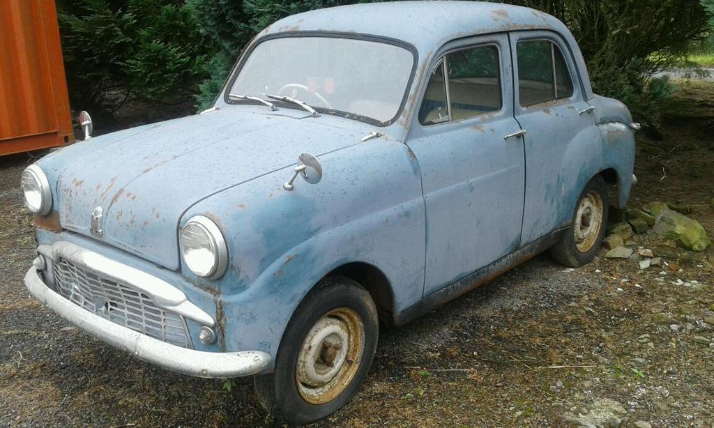

captain_70s Posted August 16, 2016 Author Share Posted August 16, 2016 Great to see, what's the plan for it?Found somebody local who has a shed, a MIG welder and the belief he can add more patches to the patchwork underside in a manner that will achieve much MOT passness. He also drives a '96 Clio with an 8-track player so you know he's sound. The chap who owns the Cornhill Yard of Dreams has said he can shift it on his low loader to said shed. The move is provisionally pencilled in for the weekend.... In other news I rented a garage for that Princess I failed to buy so I've got to find something terrible and worthless but worthy of preservation to put in it so I'm not wasting my money 'cause it's a 6-month lease. Logic*. anonymous user, oldcars, purplebargeken and 9 others 12 Link to comment Share on other sites More sharing options...
oldcars Posted August 17, 2016 Share Posted August 17, 2016 Found somebody local who has a shed, a MIG welder and the belief he can add more patches to the patchwork underside in a manner that will achieve much MOT passness. He also drives a '96 Clio with an 8-track player so you know he's sound. The chap who owns the Cornhill Yard of Dreams has said he can shift it on his low loader to said shed. The move is provisionally pencilled in for the weekend.... In other news I rented a garage for that Princess I failed to buy so I've got to find something terrible and worthless but worthy of preservation to put in it so I'm not wasting my money 'cause it's a 6-month lease. Logic*.Great new, it lives on. Good luck with it. Link to comment Share on other sites More sharing options...

captain_70s Posted August 22, 2016 Author Share Posted August 22, 2016 Can the green Trump not make it all the way there?It is deaded. Oil leaked all over the starter motor killing it and the clutch master cylinder has died. Also the MOT expired nearly a year ago and it's languished in my parent's garage ever since. I do having a savings account entirely dedicated to it, kind of ironic that the 1850 project is moving faster for no cost... Should be pretty easy to find your house next time I'm up Cullen way... It's quite distinct, I chose the house purely based on its aesthetic value and location... Actually turned down a flat+garage a few streets away! Coprolalia 1 Link to comment Share on other sites More sharing options...
Roostybroon Posted August 22, 2016 Share Posted August 22, 2016 Clearly need something insultingly twee to sit in front of my obnoxiously cute house, dirt cheap and MOT exempt is preferable.Ahem. I'll just leave this here.https://i.ebayimg.com/00/s/NjE0WDEwMjQ=/z/klYAAOSw9NdXuadv/$_86.JPG https://www.gumtree.com/p/other-cars/standard-blue-saloon-car/1184114738 Link to comment Share on other sites More sharing options...

captain_70s Posted August 28, 2016 Author Share Posted August 28, 2016 Removed petrol tank in order to access the dent in the rear panel better, found that the boot floor had ceased to be. The grinder was applied until metal that looked vaguely weldable was found. The guy had also bare metaled one of the wheelarches, fiberglassed the holes and given it a quick going over with some aerosols just to see how it'd look. Not a bad result actually! The hole under the rear screen was also repaired in a way that didn't involve jamming some mesh in the hole and fiberglassing it because that'd be a bodge and I don't* do* bodges* Then it was dark and cold because the fire started with the petrol drained from the fuel tank had died, so we jammed a foxes' tail in the headlight hole and called it a night. Angrydicky, Jim Bergerac, Supernaut and 7 others 10 Link to comment Share on other sites More sharing options...
Lacquer Peel Posted August 28, 2016 Share Posted August 28, 2016 I passed through Cullen the other day, your house does look bereft without rusty British tin but good to see progress with it. captain_70s 1 Link to comment Share on other sites More sharing options...
purplebargeken Posted August 28, 2016 Share Posted August 28, 2016 That boot floor does look a tad errrr, threadbare. Ouch. Link to comment Share on other sites More sharing options...
captain_70s Posted August 29, 2016 Author Share Posted August 29, 2016 That boot floor does look a tad errrr, threadbare. Ouch.More metal was removed today, what's left is fairly flimsy but probably workable. A Skoda Fabia roof panel will probably become the boot floor at some point tomorrow. We also applied well over a tin of Isopon P40 to the bootlid and it is now vaguely more bootlid shaped. I'll post before, during and after shots once it's painted. I feel the passenger side should be clear lacquered to show how artful and seamless the integration with what was left of the metalwork is. Link to comment Share on other sites More sharing options...

captain_70s Posted August 29, 2016 Author Share Posted August 29, 2016 Sellotape and carrier bags are an unusual materials group for masking an area to be painted.I find regular tape comes off easier if you're masking trim, actual masking tape seems to tear and leave bits everywhere. The car is being fixed using whatever is lying around the yard, the is essentially no real budget for it. The only reason it's being getting bangered or broken for parts is because I've found somebody who is a good welder and is willing to help me out at no cost! Everybody else who's looked at it has advised binning it, and that's BEFORE it was known that the boot floor didn't exist! If we can get it MOT'd and roadworthy that'll be enough for me. Rusty_Rocket, Coprolalia, Skizzer and 6 others 9 Link to comment Share on other sites More sharing options...
