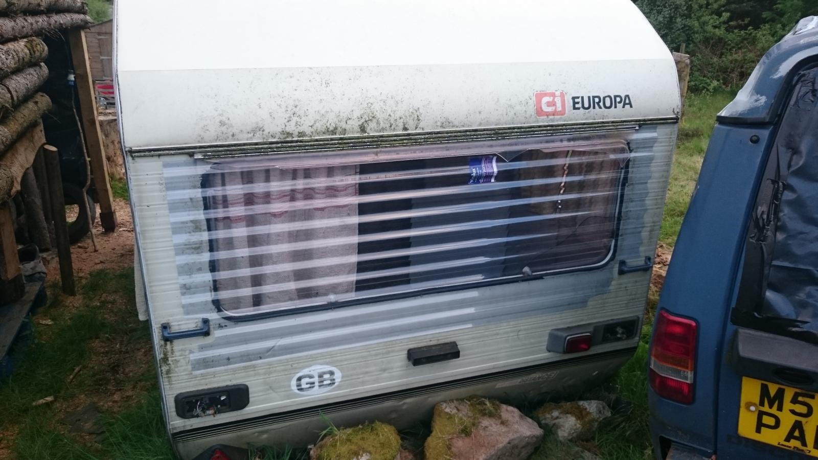

mat_the_cat Posted October 8, 2015 Author Share Posted October 8, 2015 I'm getting there with the wood now! I've been keeping an eye out for a rear door window plus driver's side quarter glass, and the latter came up on eBay recently for £20 delivered. So I decided to replace the PVC sheeting currently keeping (most of) the rain out: To be fair, the 'repair' has lasted over 5 years - even the original tape has remained sticky! But the sheet has a few pinholes in it, so had to go. So, after a bit of fiddling and heaving, job done! One of the hinges has failed on the rear door, and I'd imagine the window is a bit of a pain so a complete rear door might be the quickest fix. Found one locally but they want £75 for it - ideally I want a tatty one which is less desirable to anyone else! CGSB, catsinthewelder, Lacquer Peel and 3 others 6 Link to comment Share on other sites More sharing options...

dieselassist Posted October 8, 2015 Share Posted October 8, 2015 disco 2 rear door hinges are the same; in terms of fittement - fitted one to my dick'so - only difference is is, the hinge's pin is not exposed on the disco 2... it looks like this is getting nearer, n nearer 'road going' fettle status' if yr considering a whole new rear door; if it were me n it was just a fire wood lugger, id pop rivet a bit of 'cut to size' galvanised sheet/Perspex etc.... still you should be able to get a cheaper good rear door; lots of these 'first shape one' being broken due to cab rot.... Link to comment Share on other sites More sharing options...
mat_the_cat Posted October 8, 2015 Author Share Posted October 8, 2015 it looks like this is getting nearer, n nearer 'road going' fettle status' if yr considering a whole new rear door; if it were me n it was just a fire wood lugger, id pop rivet a bit of 'cut to size' galvanised sheet/Perspex etc.... It's partly down to the fact I'm doing a fair bit of reversing to load/unload, as one area doesn't have space to turn around in. (I suppose I could clear a bit more, but that's more work!) So not being able to see through the back is a pain although Perspex would do. Plus, as you say, it all nudges it back towards being within fettling distance of being roadworthy... Good to know about the hinges, but will ideally find a cheap door with them still attached. Link to comment Share on other sites More sharing options...
catsinthewelder Posted October 8, 2015 Share Posted October 8, 2015 There's a Disco breaker at Newcastle on Clun who's pretty sound, I need to ask him for a headlight surround anyway so I'll ask if he's got any tatty back doors knocking about. Are you down this way anytime soon? The other question being does a Disco rear door fit inside a Disco? mat_the_cat 1 Link to comment Share on other sites More sharing options...
John F Posted October 9, 2015 Share Posted October 9, 2015 The other question being does a Disco rear door fit inside a Disco? Yes it does, I had to move one in mine a while ago. Link to comment Share on other sites More sharing options...
mat_the_cat Posted October 9, 2015 Author Share Posted October 9, 2015 There's a Disco breaker at Newcastle on Clun who's pretty sound, I need to ask him for a headlight surround anyway so I'll ask if he's got any tatty back doors knocking about. Are you down this way anytime soon? That would be great, cheers. But best not to go ahead with anything right now though...cash may be rather tight all of a sudden! catsinthewelder 1 Link to comment Share on other sites More sharing options...

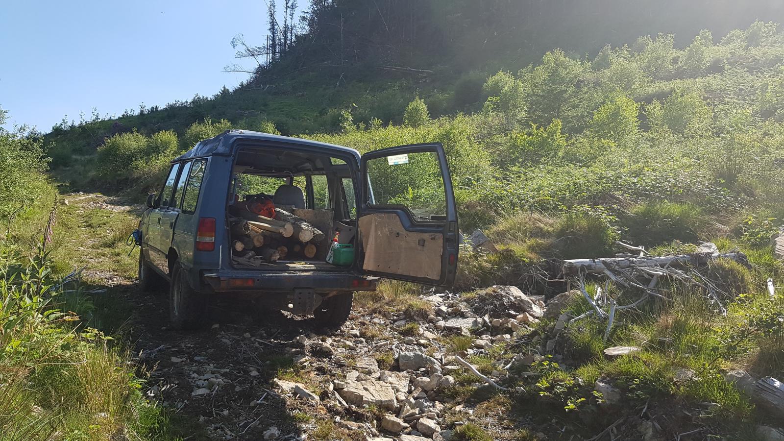

mat_the_cat Posted January 31, 2016 Author Share Posted January 31, 2016 Today I've been using this to collect some wood that I'd felled and cut up early last year. Hopefully once Spring arrives it can dry out and be put under cover. I think I may be over the maximum payload! But it still took 5 trips to end up with this lot. As a reward for all the hard work I've bought a cheap rear door for it on eBay, so I'll hopefully collect that some time this week and get it slightly more watertight... CGSB, UltraWomble, DVee8 and 2 others 5 Link to comment Share on other sites More sharing options...

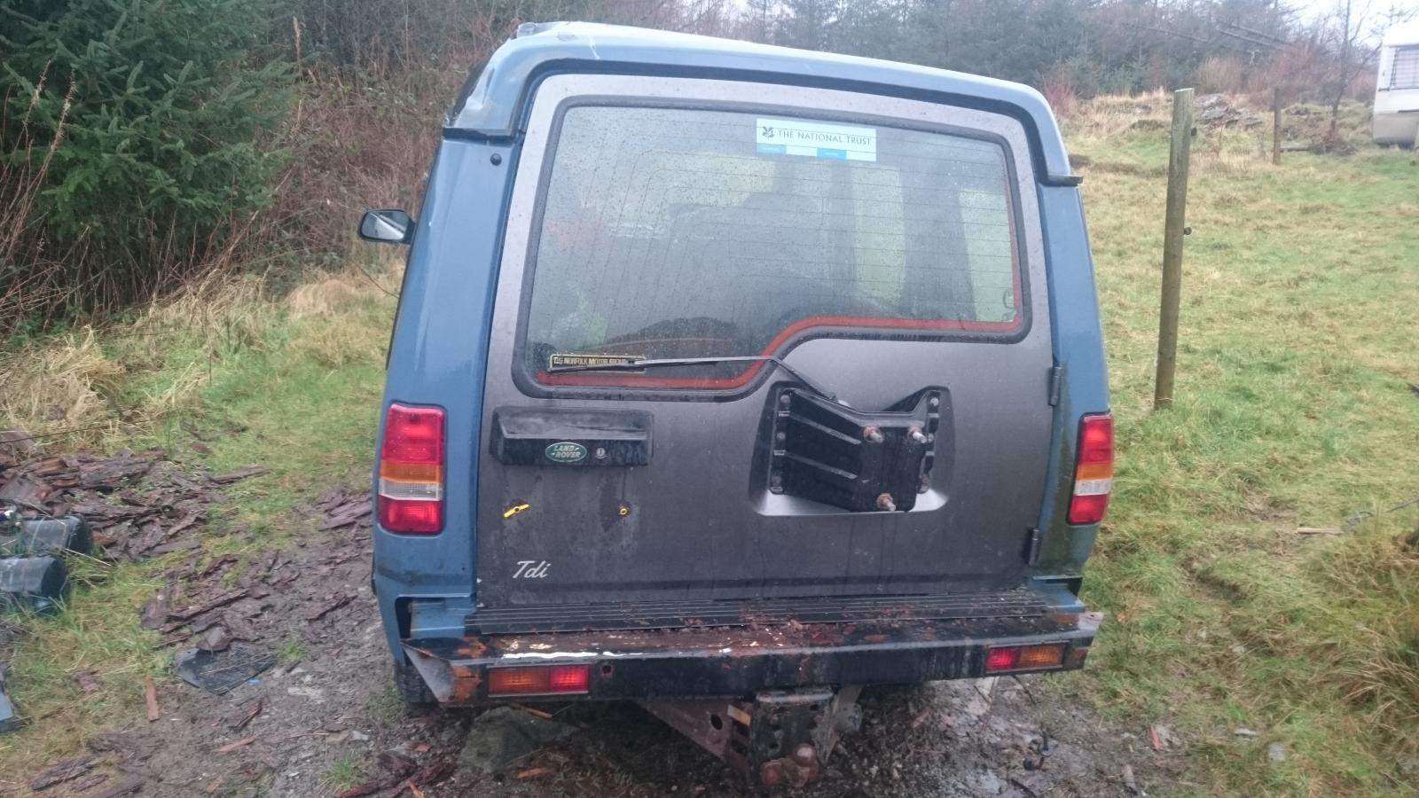

mat_the_cat Posted February 5, 2016 Author Share Posted February 5, 2016 Door collection is tomorrow, but in the meantime I've been making a change to the fuel system. Instead of the 3.9 kg cylinder tucked under the bonnet... ...I wanted to run it from a larger cylinder as the little ones are hugely expensive to fill in comparison. I also wanted something a little more permanent than a jubilee clipped connection from the flexible hose to the rigid pipework. Trouble is, anything made for the task (i.e. for an LPG forklift) was more expense than I wanted to pay. I'd be looking at £60-70 just in fittings! All I really wanted was something to go from a W20 gas thread (like M20 but with a different pitch on one side of the thread to the other) to an 8 mm pipe, but everything I could easily find was designed to go to a domestic low pressure vapour regulator. However, I had a couple of threaded T pieces in my 'it'll come in handy box'. Handily an 8 mm pipe was a reasonable fit down the middle of this, so a little bit of soldering later I had my coupling sorted! Sigmund Fraud, Rusty_Rocket, UltraWomble and 3 others 6 Link to comment Share on other sites More sharing options...
mat_the_cat Posted February 6, 2016 Author Share Posted February 6, 2016 New door is on! And it's STILL raining... drum, John F, CGSB and 4 others 7 Link to comment Share on other sites More sharing options...
