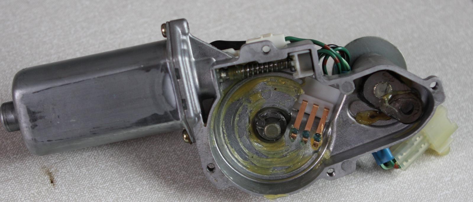

Asimo Posted April 29, 2017 Author Share Posted April 29, 2017 Rear wiper and spoiler fixed!Hardly a priority. The rear wiper has never worked, apparently a common problem. It doesn't matter much as vision through the rear window is minimal anyway. The boot spoiler moulding was loose and rattly so the reasoning was when the inside trim is out to gain access to the spoiler fixings, remove and bin the wiper motor and plug the hole. A new motor - £259.05+vat - was not an option.Curiosity had me taking the wiper motor apart, I had been told that the gears always strip, and that was certainly what it sounded like. On inspection however it was obvious that the worm and wheel were not aligned correctly. The connecting rod between worm wheel and wiper crank has plastic thrust buttons on it which press on the lid of the gearbox to hold the worm wheel against the worm but these couldn't do their job because a scruffy edge to the gearbox casting was holding the lid too high.A quick file of the casting and now the lid sits properly and holds the gears in correct engagement. The second time I reassembled it had it parking correctly. A used Transit wiper blade and job done. The spoiler was loose at both ends which rattled and put me off using automatic car washes. A bit of a fight to remove the internal tailgate trim to allow access to the single functioning faster, a nut in the centre. The fragile moulded bridges which hold two clips and two captive nuts had all broken free from the spoiler. Anew one would be £176.19+vat so bodgery was called for. Thanks to recycling regulations, plastic parts have a moulded in identifier of what plastic type they are and this spoiler is ABS. This is good news because ABS is really easy to weld with the solvent used for ABS plumbing fittings. Careful solvent welding had all the bits back in the right place. Further reinforcement with Gripfill, the bodgers friend, and now stronger than when new.I'll do the important jobs like fluid changes, thermostat, brake inspection another day. alcyonecorporation, forddeliveryboy, cort1977 and 5 others 8 Link to comment Share on other sites More sharing options...
r.welfare Posted April 30, 2017 Share Posted April 30, 2017 Good bodge. Had a similar issue with my wife's Qashqai, the plastic trim that doubles as a boot handle has similar moulded bridges that snap over time (which explains why you see quite a few of them with gaffer tape around the handle). Will look out for the plastic identifier next time, as repair preferable to the £80 replacement cost. Link to comment Share on other sites More sharing options...

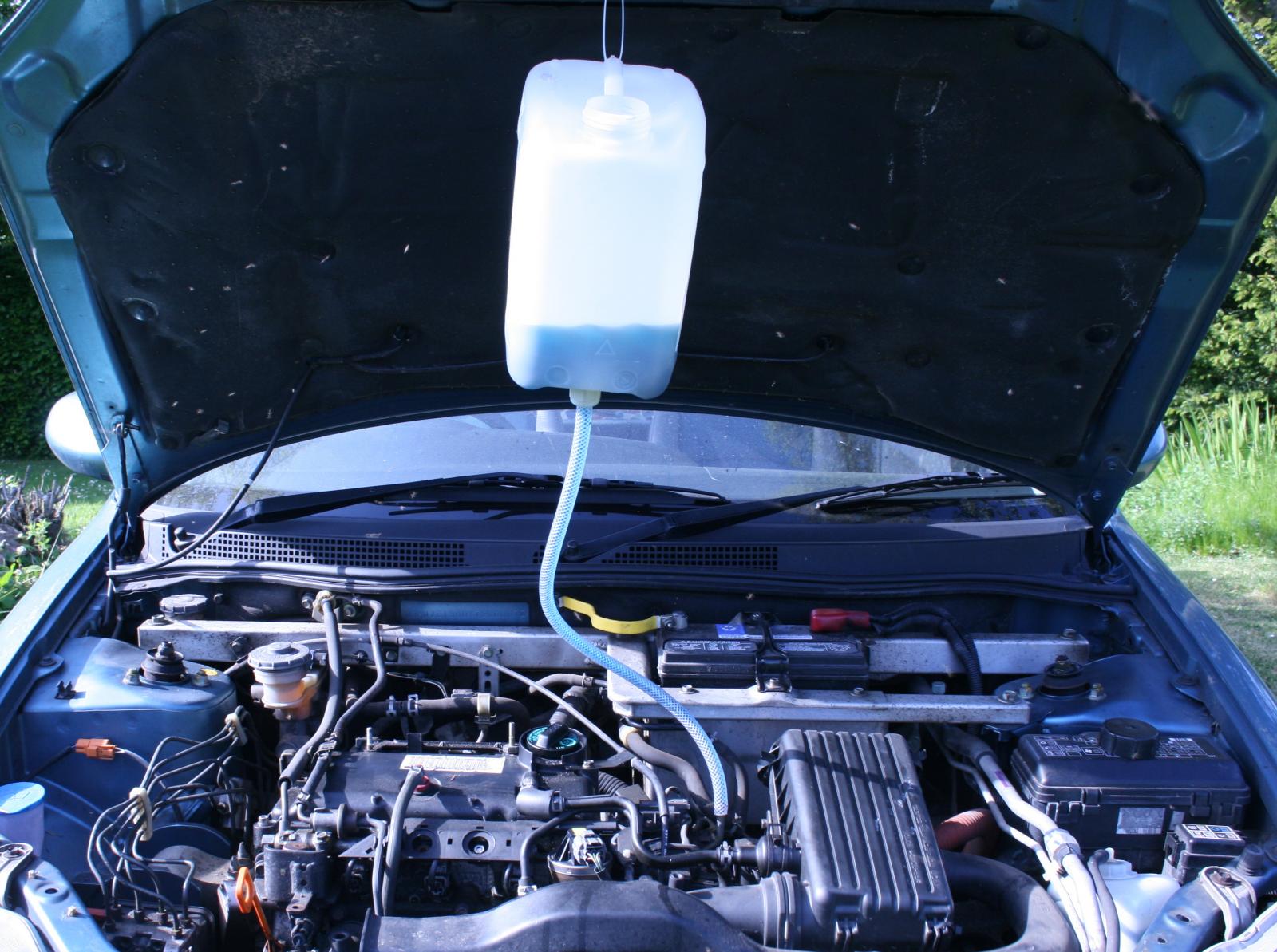

Asimo Posted June 13, 2017 Author Share Posted June 13, 2017 Service time. Thermostat: old out, new in. Why is everything so clean? New fluid in, bubbles out. To Gaydon to hang out with other Insights. To Shitefest to hang out with proper cars. Copyright @ TriggerPics Slow day at work. Let's use their resources... Honda rear springs out, £20 Daewoo Matiz springs in. Look close and you can see Matiz coil is from thicker wire. Stiffer! It fits. The internet was right. Doesn't bottom out so readily now with the stiffer Matiz springs. Feels a bit underdamped instead but I can cope with that for now. Amazingly, just an hour to change both springs. Nothing went wrong, didn't even have to take the wheels off. Lacquer Peel, Skizzer, Vantman and 3 others 6 Link to comment Share on other sites More sharing options...

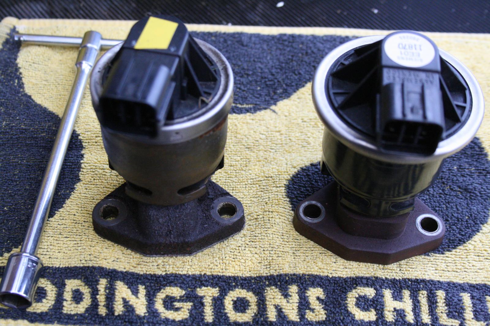

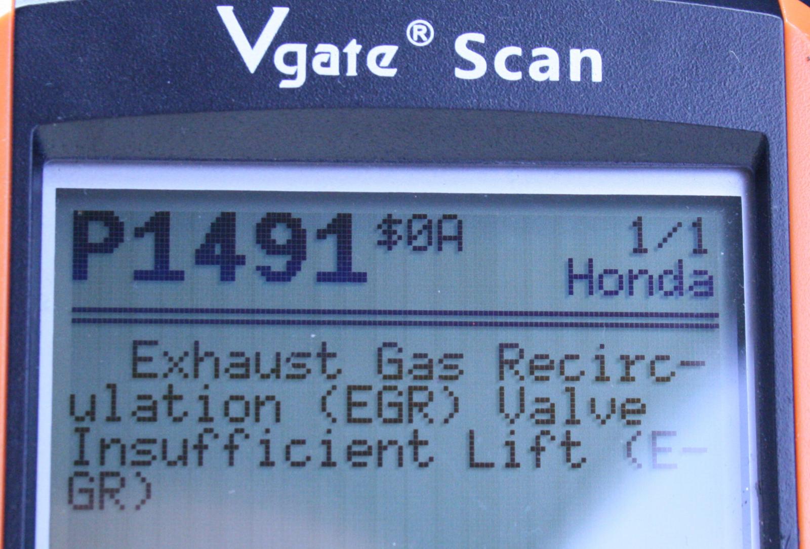

Asimo Posted October 21, 2017 Author Share Posted October 21, 2017 Last year, back in post 90, I bodged the EGR valve by squirting the variable resistor track with contact cleaner. Repeated this a few times since but now get no improvement so replace the EGR valve it is. The obvious symptom is lurching and rough running about half way through warming up, ie it drives ok for a mile or so then is horrible to drive for the next three miles, then mostly ok. Why bother to replace not delete the valve? It is possible to ignore the EGR valve, to delete it just by unplugging it. Which of course gets you an EML light but does improve the driveability. It seems also to lose about 5mpg. EGR is used in this engine as one of it's many tweaks to enable very lean running for max economy. Since the whole point of this car is it's very low fuel consumption I want to keep the engine working exactly as Mr. Honda intended. As related in the "Grin" thread the other day, I failed to buy a replacement EGR valve from Honda because they wanted full price up front - £337 - with up to 10 weeks delivery and no option to return it. I decided to get hold of a similar valve from a newer Honda and try and use the variable resistor track from it to repair the Insight's valve. The cheapest eBay had to offer was from an '07 1.8 Civic, delivered in two days for £12.95. It did look more or less the same, the solenoid resistance and the feedback resistor measured exactly the same. The only obvious difference was that the gas port was smaller, but gas is still going to flow, it might just have to flow at a higher speed! Why not just try it as it is? - if it doesn't work go back to the original plan and try and make a good valve from the two. Popped it on, remembering to swap the gasket from old to new, test drive and it seems to work perfectly!!!No hesitation or stumbling at any point in the warm up phase, completely normal once hot and (something I hadn't noticed until suddenly it isn't there) now no longer a little flutter felt when the engine goes from normal to super-lean running. Need to get some miles in now to see what effect - if any - this fix has on fuel consumption. As for the money I saved, that is going on a set of those low rolling resistance Michelins. Jim Bell, Fat_Pirate, mjrose78 and 10 others 13 Link to comment Share on other sites More sharing options...

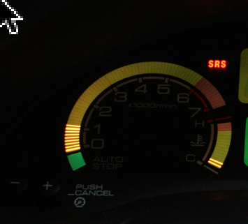

Asimo Posted January 10, 2018 Author Share Posted January 10, 2018 Bollocks The nagging little lamp of exploding-cushion irritation has returned. I blame the stupid miserable damp climate; the detonator thingys change their resistance slightly with humidity which pushes them out of spec. for the self test.Special OBD box with custom magic for talking to ancient Honda Hybrids ordered. somewhatfoolish, Jim Bell and Volksy 3 Link to comment Share on other sites More sharing options...
406V6 Posted January 11, 2018 Share Posted January 11, 2018 On many cars, particularly PSA models, the airbag comes on because of dirty / corroded contacts in the connectors causing high resistance whcih fails the self-test. In mine it was the connectors under the seats after being left out in damp conditions. A few disconnect / reconnect operations and all was fine. Link to comment Share on other sites More sharing options...

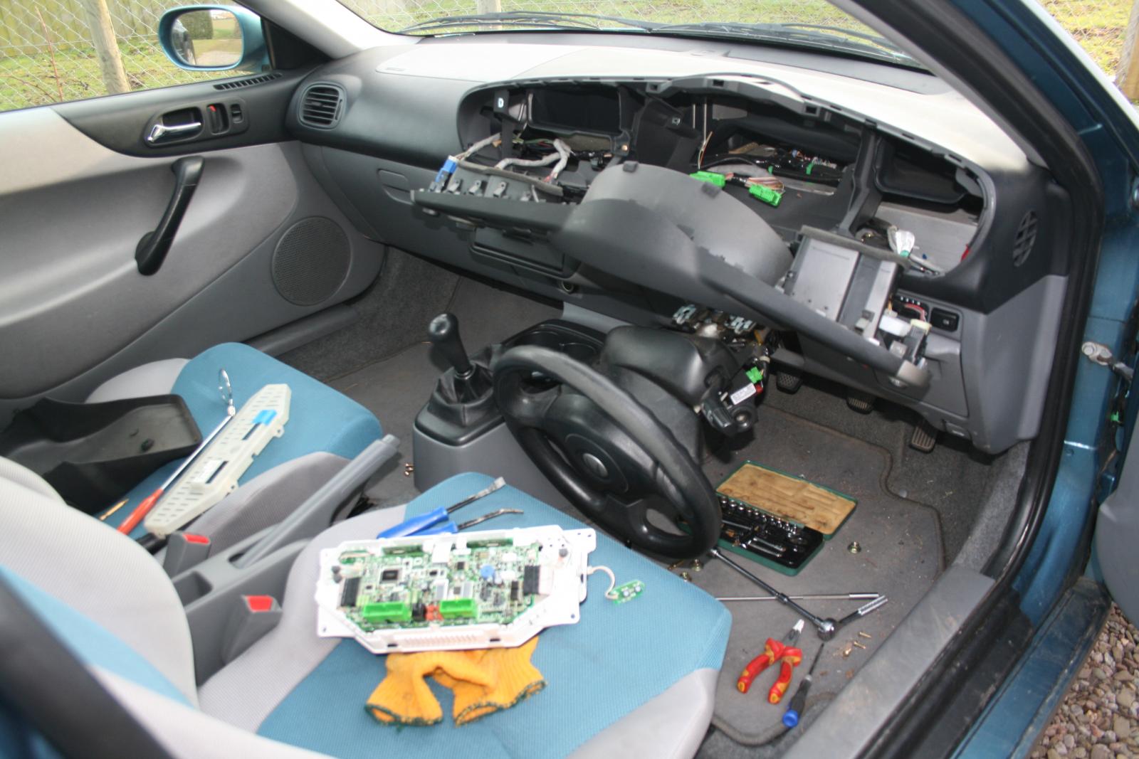

Asimo Posted January 12, 2018 Author Share Posted January 12, 2018 There is a work around for mot purposes (see back a page or two in this thread) but I do want a code reader that will do everything on the car rather than just the generic read / reset. The instrument circuit board is difficult to remove apparently, and I do need to get in there to replace the trip-reset switch which has failed - said to be a very common fault with these. Since I did the full discharge / recharge cycle over the Xmas drinking period the battery has cheered up a lot, giving full boost on acceleration without wimping out once so far. Link to comment Share on other sites More sharing options...

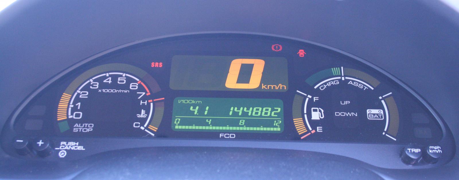

Asimo Posted February 24, 2018 Author Share Posted February 24, 2018 Fixed the trip, miles/kilometres and dash lighting brightness switches.Usual problem with dash jobs - lots of concealed plastic clips, only one of which broke.Tiny switches were the conductive rubber pad type and a common failure. A multitude of tiny switches are available. I cannibalized two from a wheelmouse but they were just too tall to fit.Pack of ten superior switches with a nice positive click from RS for 62.5p each.Kilometres Miles While I was in there I pulled the bastard buzzer out. Wish I'd done that sooner! forddeliveryboy, loserone, Sigmund Fraud and 5 others 8 Link to comment Share on other sites More sharing options...

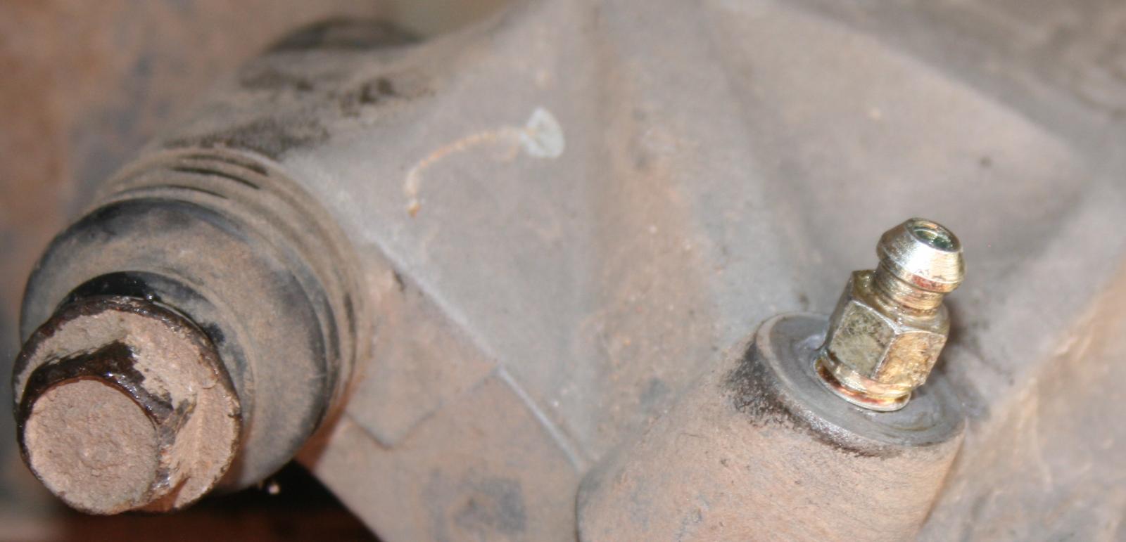

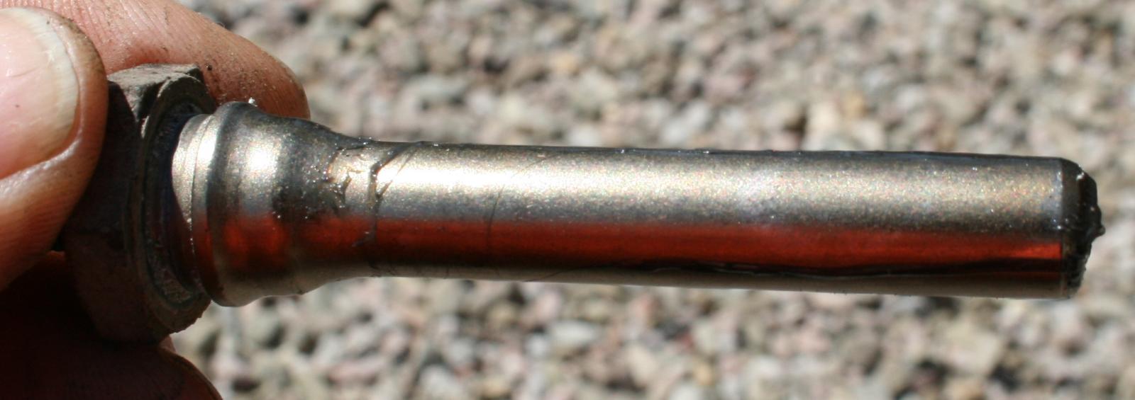

Asimo Posted May 6, 2018 Author Share Posted May 6, 2018 First opportunity for maintenance for months so a quick look at the brakes, prompted by Captain 70s' fight with Civic calipers. No fight here, as easy as could be. Pads don't look much different to last time I checked, light weight and regenerative braking! Discs are ageing from rust rather than wear. I wonder if they are original? They are certainly Honda parts. Slider pins look like new. Added a bit of silicone grease just for luck. Bleed nipples like new also! A blob of grease in there should keep it that way for another 18 years. Spilled my coffee in the boot. Full cup. Good job I take it black, no sugar and hot sun has dried it out already. dollywobbler, Sigmund Fraud, Vantman and 2 others 5 Link to comment Share on other sites More sharing options...

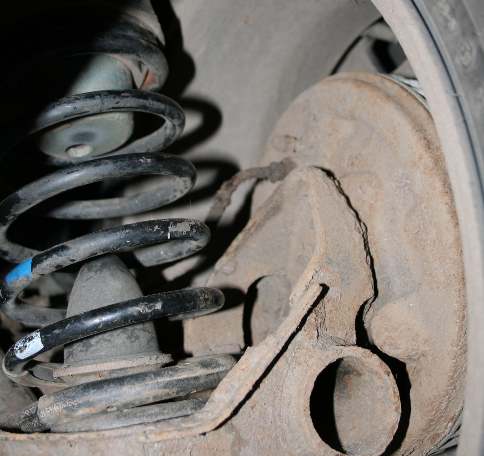

Asimo Posted June 8, 2019 Author Share Posted June 8, 2019 Another year, another 12 tank-fulls and another PASS. Only MOT preparation, or maintenance* since last summer was a quick headlight polish with T-cut. The rear brake pipe advisories came with an "I mean it" this time so they will be done in a couple of weeks. (First advised three years ago). So not much to report. Which doesn't make for interesting reading but does make for happy shiteing. *** I am not counting drive battery maintenance. It needs a "balancing" charge every month or so to keep things healthy, and the IMA fault codes at bay. dome, somewhatfoolish, skattrd and 8 others 10 1 Link to comment Share on other sites More sharing options...
