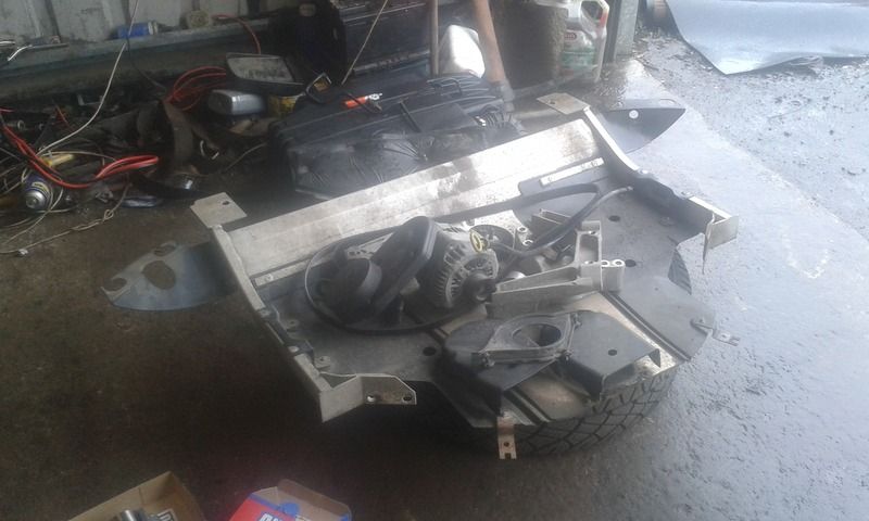

How much stuff do you need to remove to get at the front timing belt on a KV6 Freelander?
Lots. You also have to drain the engine oil, and the back belts need the inlet manifold removing too, which makes it the ideal time to service it and change the spark plugs.
Should be back together tomorrow sometime.

Yeah, it's all easy enough, and there is plenty of access once you have made a huge pile of everything that was in the way.
Owner says the dealer that supplied it serviced it and changed the plugs 5000 miles ago! I don't think the inlet manifold has been off in at least a decade, so I'll look tomorrow to see if there are 3 shiny new ones in the front bank and the factory plugs in the back one.

Yeah, it's all easy enough, and there is plenty of access once you have made a huge pile of everything that was in the way.Owner says the dealer that supplied it serviced it and changed the plugs 5000 miles ago! I don't think the inlet manifold has been off in at least a decade, so I'll look tomorrow to see if there are 3 shiny new ones in the front bank and the factory plugs in the back one.
Scary also see every V6 Grand Voyager!

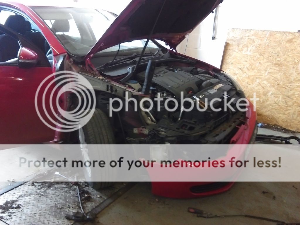

Been doing a fair bit at MIRA recently, service and repairs on the site utility vehicles. Also had to go into major surgery on two of the taxis, '09 octavia at 301,000 has shot it's piston rings, lots of comedy gold pulling the lump out in the street and dumping it in the boot of my Rover to send it for rebuild. The other was a straightforward head gasket at 304,997 miles
