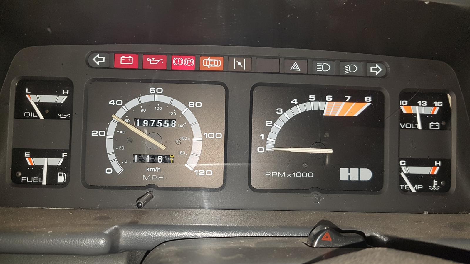

mat_the_cat Posted August 13, 2018 Author Share Posted August 13, 2018 I started to investigate the fuel gauge and speedo at the weekend, but on putting the electronic speedo drive into test mode found that the needle moved fine, so I suspect the problem may lie with the speed signal. There is a flashing LED on the unit to signal when it has received a pulse; problem is this is impossible to see whilst driving unless I rig up a camera. As you can also see, the fuel gauge is now working so I have to wait for that to fail before I can investigate! Talbot and mrbenn 2 Link to comment Share on other sites More sharing options...
dollywobbler Posted August 14, 2018 Share Posted August 14, 2018 Someone left a comment on the video about this asking why it hadn't been modified for power. I patiently explained that power isn't really the point. It sounds awesome and probably has twice as much torque as it would have had when new. It's fine as it is I reckon! mat_the_cat, Lacquer Peel, michael t and 1 other 4 Link to comment Share on other sites More sharing options...
mat_the_cat Posted August 28, 2018 Author Share Posted August 28, 2018 The fuel gauge is now working - was just a poor contact so an easy fix. The speedo drive is still under investigation! I jacked a rear wheel up last week and let the engine idle in gear while I checked the drive unit for the flashing LED denoting a signal. Nothing. So it looks as though there is no signal being generated until some time into the journey. To further prove this I connected my rather elderly 'scope up to the sensor, and went for a drive. Amazingly, the internal (Ni-cad!) battery still holds a charge so I was able to check out the signal on the move. With the speedo working, I get the pattern below: I've not yet been able to monitor with the speedo inoperative, but would expect a flat line like in the first photo, although it's possible that under certain situations, electrical noise could swamp the signal, hence the reason for carrying out the checks. Richard, Talbot, Lacquer Peel and 2 others 5 Link to comment Share on other sites More sharing options...
mat_the_cat Posted September 6, 2018 Author Share Posted September 6, 2018 Right, during the period of time there is no speedo, there is no signal from the sensor, and as a double check (could have just done that anyway!) at that time it is infinite resistance. New one on the way so should be an easy fix. Surprising that it starts off open circuit and then begins to work - normally such sensors fail the opposite way round. I went out for a run in the hills earlier this week, and the light/scenery was rather nice so I took a few photos. This was on getting back to the car...twilight, and quite a welcoming warm interior as the temperature was dropping rapidly. michael t, Lacquer Peel, RayMK and 7 others 10 Link to comment Share on other sites More sharing options...
