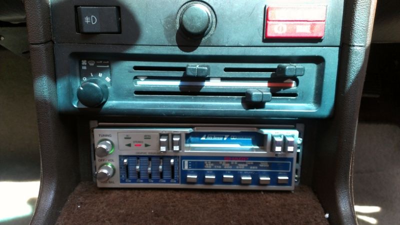

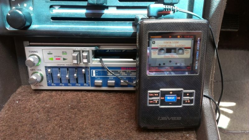

garethj Posted May 25, 2013 Author Share Posted May 25, 2013 I've ordered a new ignition coil, new set of HT leads, new distributor cap and new rotor arm. As Dan says, you've just got to work through this stuff. But I've focussed on the more important things - some bangin choons, or whatever the 1980s equivalent was. I found a period stereo on ebay which didn't work, I removed the keyring from inside the tape mechanism but it still didn't power up. I took the bottom cover off and the main power track on the PCB was burnt through. I plugged it into a current limited power supply, soldered a join onto the track using some nice old solder with loads of lead and switched it on. The lights on the front came on, woo-hoo! Of course I didn't have any speakers plugged in, the connectors were the old DIN style with a spade connector and pin in one housing, I ordered a pair and put it all together in the car. This is the result And this is how it'll mostly be used, not always with Body Rock by Maria Vidal playing, but usually. This is my shite mp3 player, an iRiver H340. I had my first one about 10 years ago and it's a proper geek's music player, it plays all sorts of formats, the battery lasts for ages, when you plug it into a PC it recognises it just as a USB drive (no dedicated software needed) and best of all it's got a line input for recording from any source. You can only get them second hand now but because they sound so good and they have the features, they go for over £100 a time. Link to comment Share on other sites More sharing options...
Danblez Posted May 26, 2013 Share Posted May 26, 2013 Zomg blast from the past. We had the exact stereo in our family 1985 Volvo 240 Gl. I seem to remember it sounding pretty decent. Link to comment Share on other sites More sharing options...
Lacquer Peel Posted May 26, 2013 Share Posted May 26, 2013 One of my first mp3 players was an iRiver, I think I ordered it from America! I would like to fit a Volkswagen LT straight 6 diesel to a Porsche 924. Make it a proper LT sports. Link to comment Share on other sites More sharing options...
