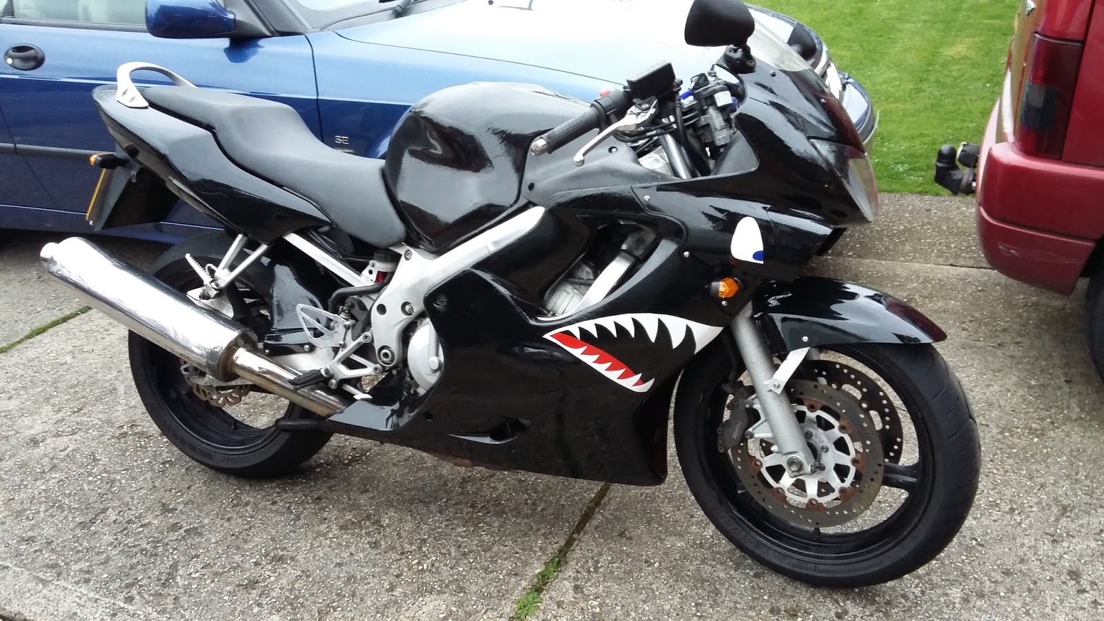

Fat_Pirate Posted April 5, 2017 Share Posted April 5, 2017 I've got the CBR600 road-legal, but road-fit it is not. The handlebars/wheel are still not straight and I now suspect the bottom yoke is bent. The right-hand fork is around 2cm forward of the left - and it's the same if I swap the forks around. I find this hard to believe as it's a hefty bit of cast iron - surely the forks would bend first? I can't see any marks on those and they spin/move up and down through the yokes smoothly. Any suggestions? Bent headstock also sounds unlikely as it's a massive alloy box section. Here it is, it's STILL ANGRY. Link to comment Share on other sites More sharing options...
Tamworthbay Posted April 5, 2017 Share Posted April 5, 2017 Drop the fairing off and get measuring. Bent stuff can show itself in weird ways and be a pain to track down. Link to comment Share on other sites More sharing options...
Barry Cade Posted April 5, 2017 Share Posted April 5, 2017 Same for me. I order mine from Oponeo - stuff always arrives on time, and on the one occasion I had a problem (a split appearing in a side wall after a few months) the tyre was replaced with a minimum of fuss.Was it an Avon per chance? Got sick of sending those back. Link to comment Share on other sites More sharing options...
DodgeRover Posted April 5, 2017 Share Posted April 5, 2017 I've got the CBR600 road-legal, but road-fit it is not. The handlebars/wheel are still not straight and I now suspect the bottom yoke is bent. The right-hand fork is around 2cm forward of the left - and it's the same if I swap the forks around. I find this hard to believe as it's a hefty bit of cast iron - surely the forks would bend first? I can't see any marks on those and they spin/move up and down through the yokes smoothly. Any suggestions? Bent headstock also sounds unlikely as it's a massive alloy box section. Here it is, it's STILL ANGRY. Are the top and bottom yokes lined up? The top one isnt however many degrees to the left/ right of the bottom is it?On a competition bike I would be loosening the pinch bolts etc, then holding the front wheel between my knees and giving the handlebars a tweak till it was back in alignment.If its bent enough to be 2" out of line between the legs then its going to go down the road turning one way or the other Jerzy Woking 1 Link to comment Share on other sites More sharing options...
blackboilersuit Posted April 5, 2017 Share Posted April 5, 2017 Bottom yokes are forged steel and can actually bend quite easily. As can frames and swing arms and fork legs if the bike crashes in the wrong way. I've ran over kerbs that smashed the wheels up but didn't damage the forks and also had a lowside that bent the forks but left the wheels and fork lowers untouched. Expect the unexpected and assume nothing. As mentioned above it can be a real pain to track down what's bent and it may be more than one thing. Time to get the string, tape measure and straight planks of wood out. Link to comment Share on other sites More sharing options...
