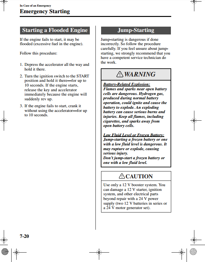

The claim that fully pressing down the pedal will turn the pump off is something i hear from time to time and not sure if its true or not,but pedal mashed into the carpet has never worked for me on these.
They were mardy so and so's when new never mind when the starter motor/battery are weak or the engines compression has dropped away and the plugs are worn or injectors gummed up.
It may clear some fuel out but being bi rotary and not multi pistoned i have always struggled to get these to restart after their owners have churned them over until the battery is near flat and unleaded is dripping from the tail pipe.
Ideally removal of the spark plugs and drying them with a blow torch or better still fitting new ones is the way to go but access to the four plugs is a bitch.
The Mazda dealer down here in Crayford would get the flooded ones going by putting their back wheels into the mot brake rollers to ''bump start'' them rather than be seen tow starting them down the high street.
Overfueled vehicles are a biggy for us,many get started for just a few seconds to be moved away from the garage to get the mower/kids bikes out or to shift to a parking spot nearer the house then monday morning they don't fire first go and flood up.
Just to check my sanity, I did double-check the manual:
It got to have worked, otherwise my RX8 would have flooded even worse! :D
It also works on the mk3 MX5 - but it definitely does not work on my Smart Roadster or Laguna II. So I guess its a manufacturer specific thing.

I see what you mean but it doesn't say it cuts the fuel pump though,is it not just a case of having the throttle wide open lets more oxygen in to dilute the dense fuel mix already in the engine?
Most times flooded piston engines will restart with the throttle pedal held down and cranked over untill they pick up.
The next flooded RX8 i go to i will pull the pump fuse and measure the current draw with foot off and foot right down on the pedal (while cranking) to see what results i get.
True, maybe because if they mentioned fuel pump it'd confuse people?
I know if I try starting, say the Laguna, at full throttle, it'll start and race the engine. While when I tried it on the RX8 and MX5, it just turned over and over until you released the pedal a smidgen (i.e. off max) it'll then fire into life.
