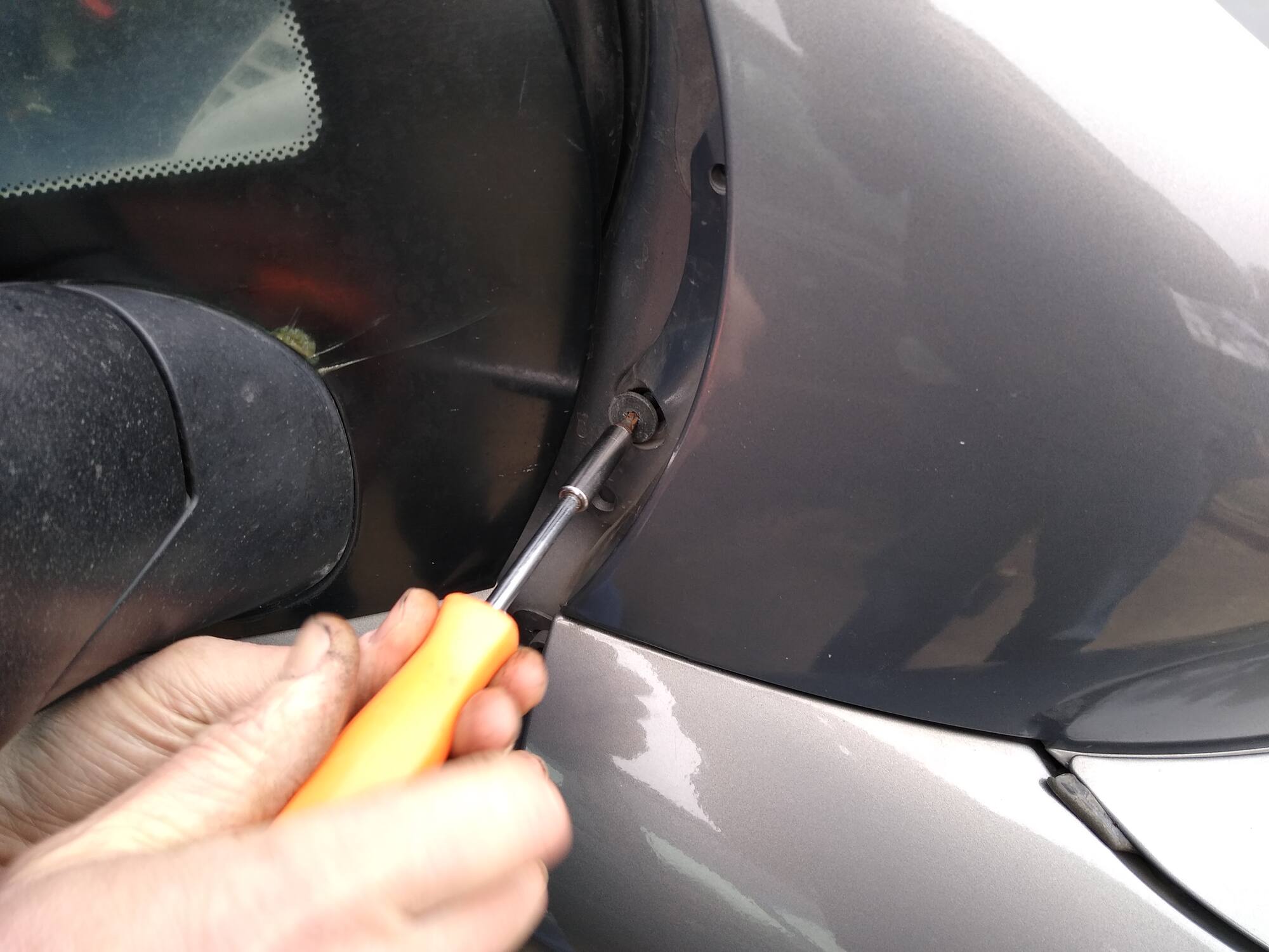

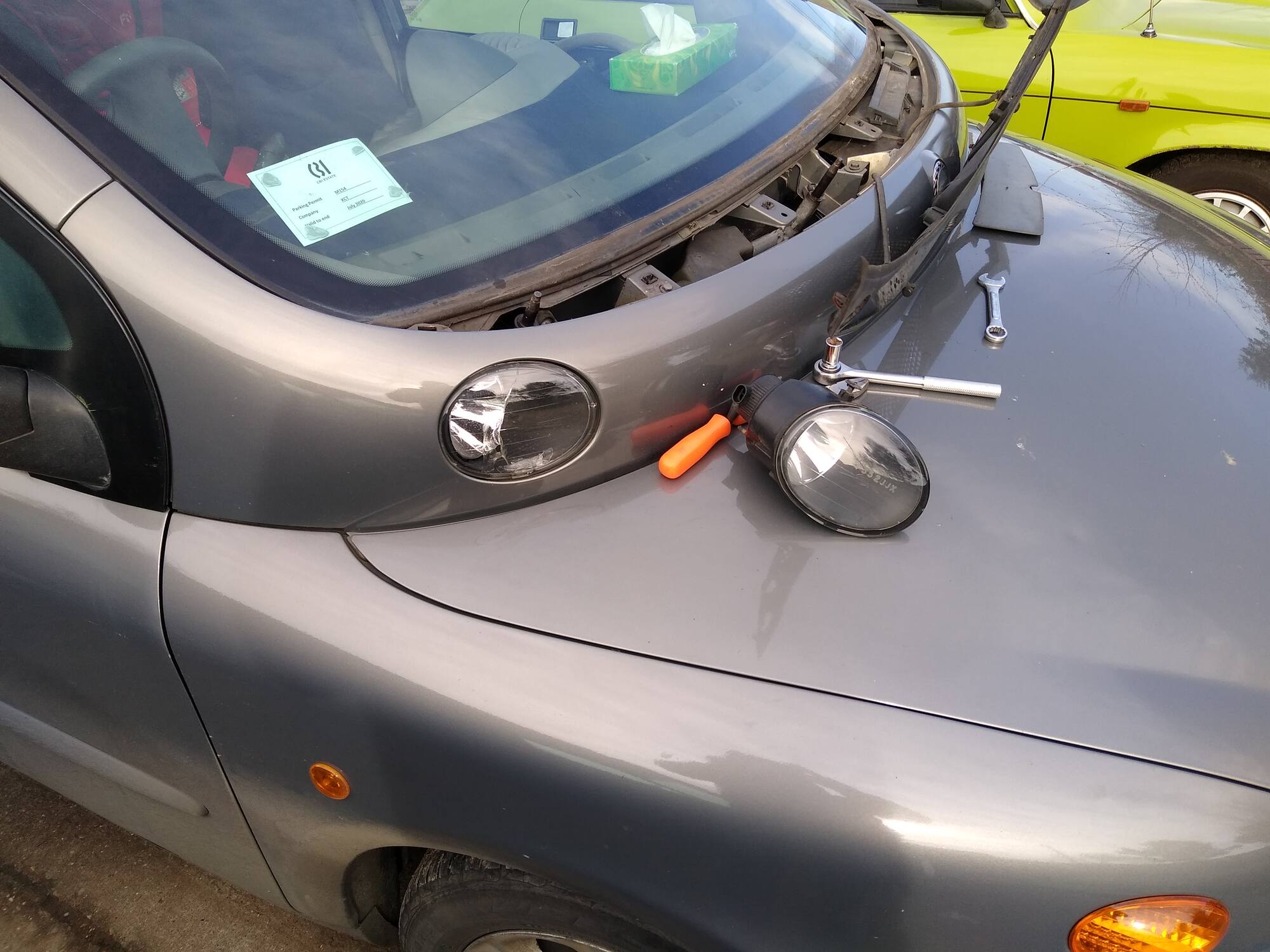

Craig the Princess Posted February 10, 2020 Author Share Posted February 10, 2020 While he was doing that I was trying to get the switch to work I started to get the Multipla top level headlight out as a stone had smashed it. Not being able to find anything online access looked difficult. So start by removing the trim strip at the scuttle. This was a massive pain in the arse as the wiper arms had seized onto the splines. After wd-40 and whacking them with a hammer they eventually gave way. And... still no access! Looks like the panel below the windscreen has to come off. Bugger. Ok, well three 10mm bolts at the top, two more at the bottom with the bonnet open. Then a couple of star fixings in the door shut. And nothing, still attached. Removal of the to panels next to the windscreen revealed the final two fixings. This allowed removal. Should have put that on a rag as the concrete had scratched it a bit. Then removal of the headlight is easy. One star fixing, remove the wire and push it forward. Almost too easy. In fact you can get to that fixing without removing all that stuff. It is almost back together now, I'm not going to try and remove it again as that would be far too depressing. Skizzer, Jim Bell, GrumpiusMaximus and 3 others 6 Link to comment Share on other sites More sharing options...
