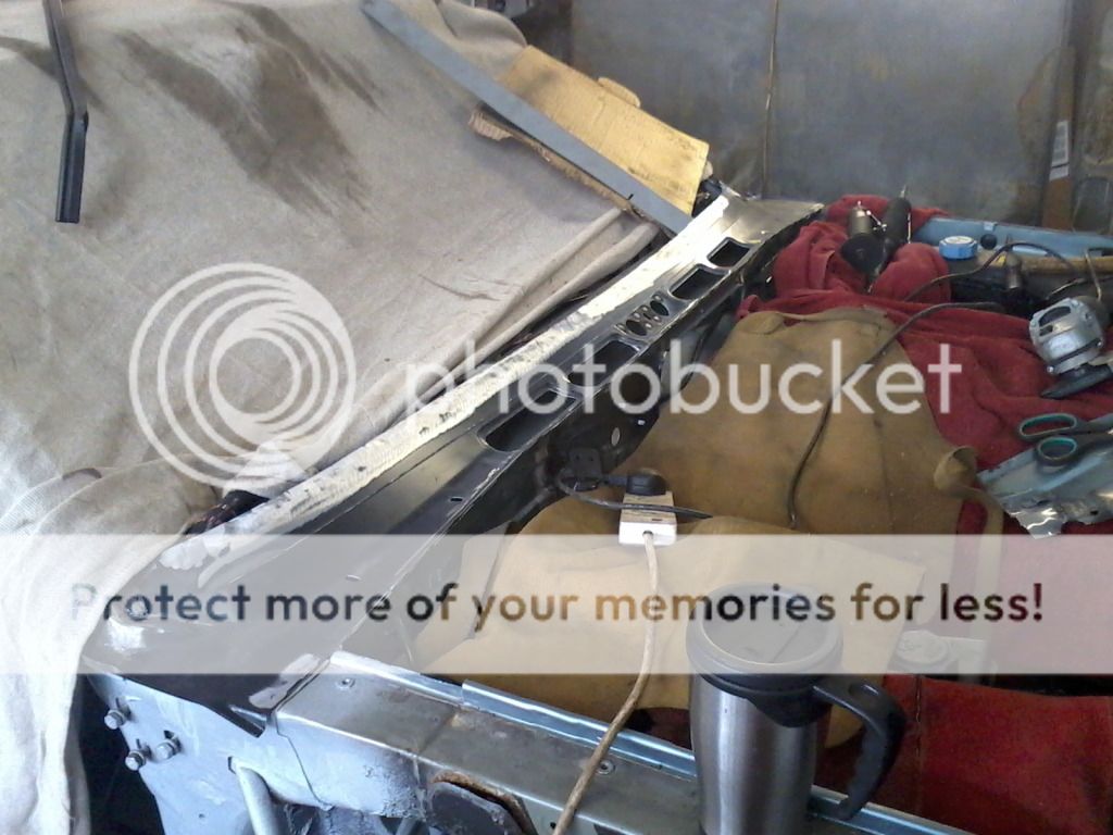

(I’m not completely following the exact sequence of the work, rather grouping areas of the restoration together in order for my thread to be easier to understand.)
Dave and Gray took the wings off so the rust can be assessed. The inner wing/top of the plenum seems to be a serious rust site on late XJ40s and X300s.

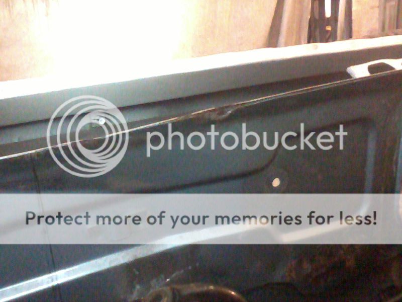

Closer view of typical rust on these cars. When water leaks in here and is found in the footwells. Strangely, my car didn’t leak. This was later found to be because the inner panel was still sound.

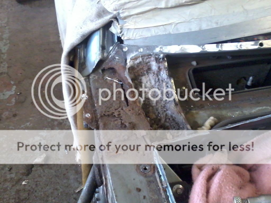

It’s all properly crusty and flaky here and very weak. I kept this flake as a souvenir.

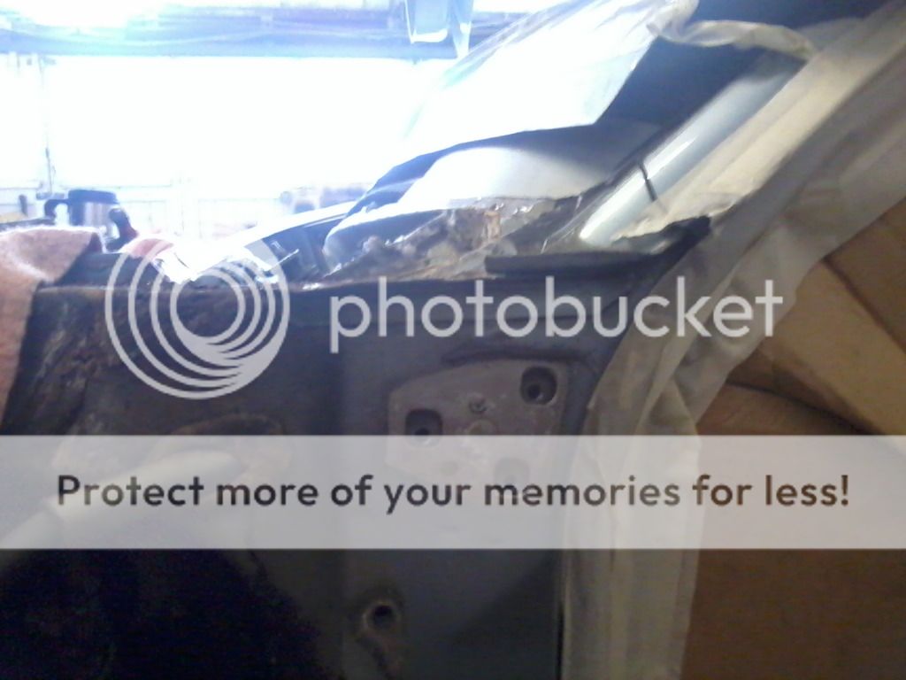

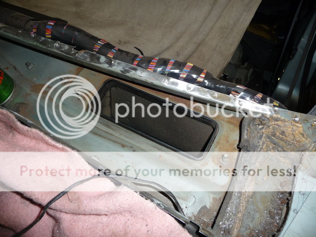

I was worried about what is going on inside the bulkhead cavity, under the scuttle. I poked my finger down the hole here and felt the rust flakes give way down below with a crunch. Not good.
Posted Image
Because of this Gray removed the scuttle top panel to view the inside of the bulkhead, which turned out to be in excellent rust free condition. I was very relieved indeed!
The brown staining is dust and rust flakes on the metal and sitting on top of the seam sealer. It can be vacuumed off easily to reveal bright paintwork.
Posted Image
I was very pleased to see that the top panel is as far as the rust reaches. Despite the brown look on the photograph, the ‘compartment’ floor and sides are not rusty. The discolouration is a mixture of rust flakes and dust. The crunching sensation must have been my finger compressing the flaked remains of the top panel which had dropped through into the cavity. Some of the rust was close in texture to soil. For some mad reason, Jaguar filled this small compartment with a strange white foam. It seems to be hygroscopic! On mine it was a rancid gloopy sludge.

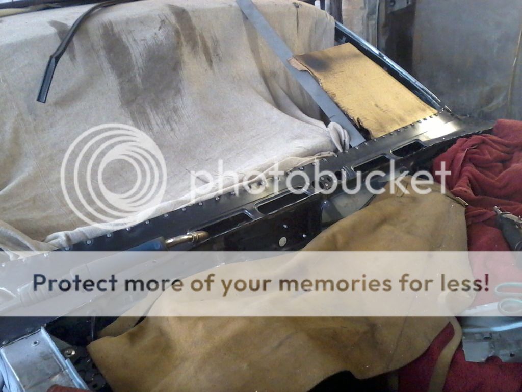

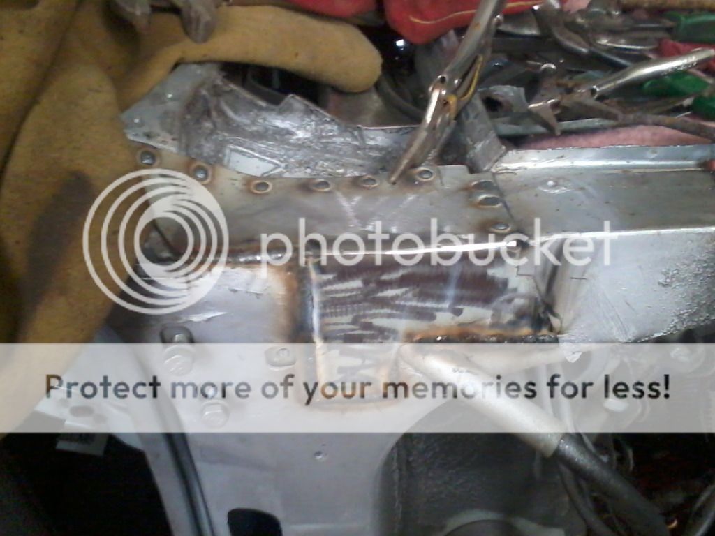

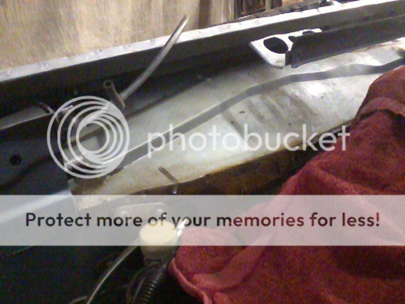

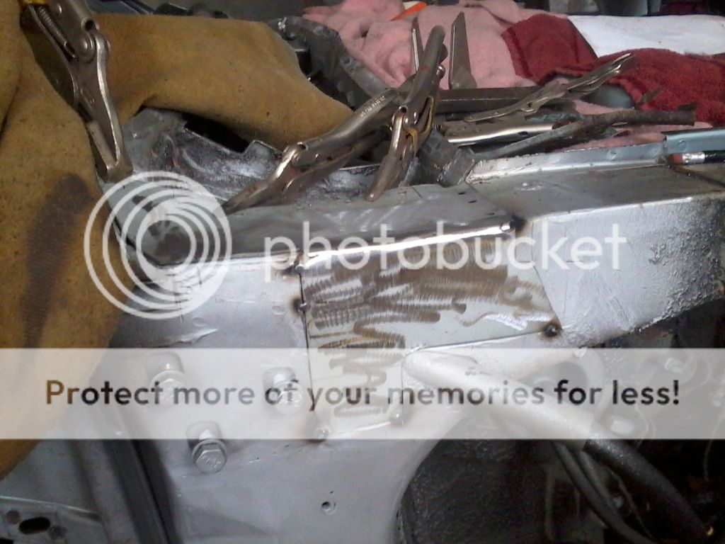

The top of the right hand inner wing was badly rusted. These are built up from several overlaid metal pieces by Jaguar in the XJ40’s original construction. Gray built up the layers in an identical way to Jaguar when he reconstructed them.
With the rusty plenum top removed, this was revealed:

First layer built up: Gray cut out all the rust, then welded the first metal layer of the right gauge/thickness and ground it back in preparation for the following layer. I seem to have lost the ‘cut out’ photo! :oops:
Posted Image

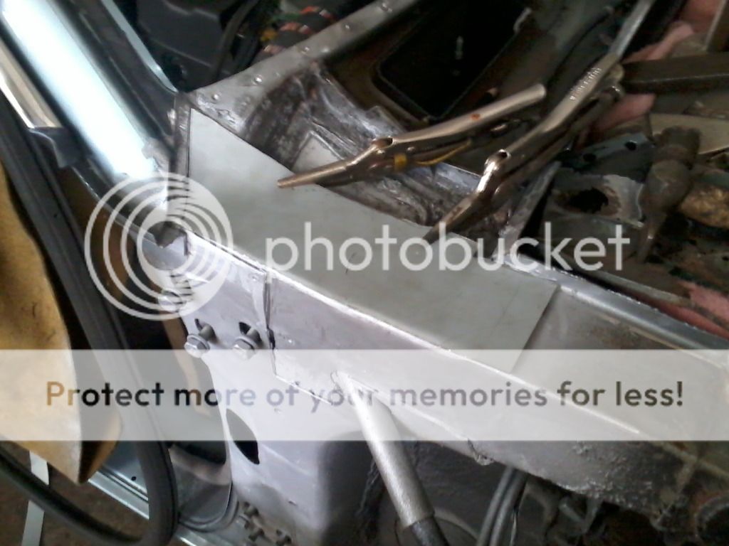

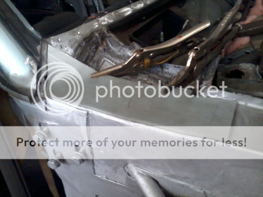

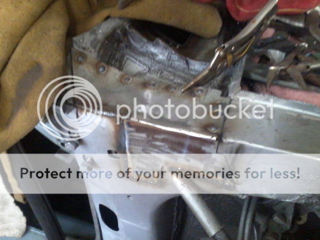

Gray shaped and fitted the next layer:
Posted Image
Posted Image
With side piece tacked on now:
Posted Image
Posted Image
And now welded:
Posted Image
Posted Image
Gray then ground down the welds in preparation for the next layer to be built up:
Posted Image
And zinc sprayed again:
Posted Image

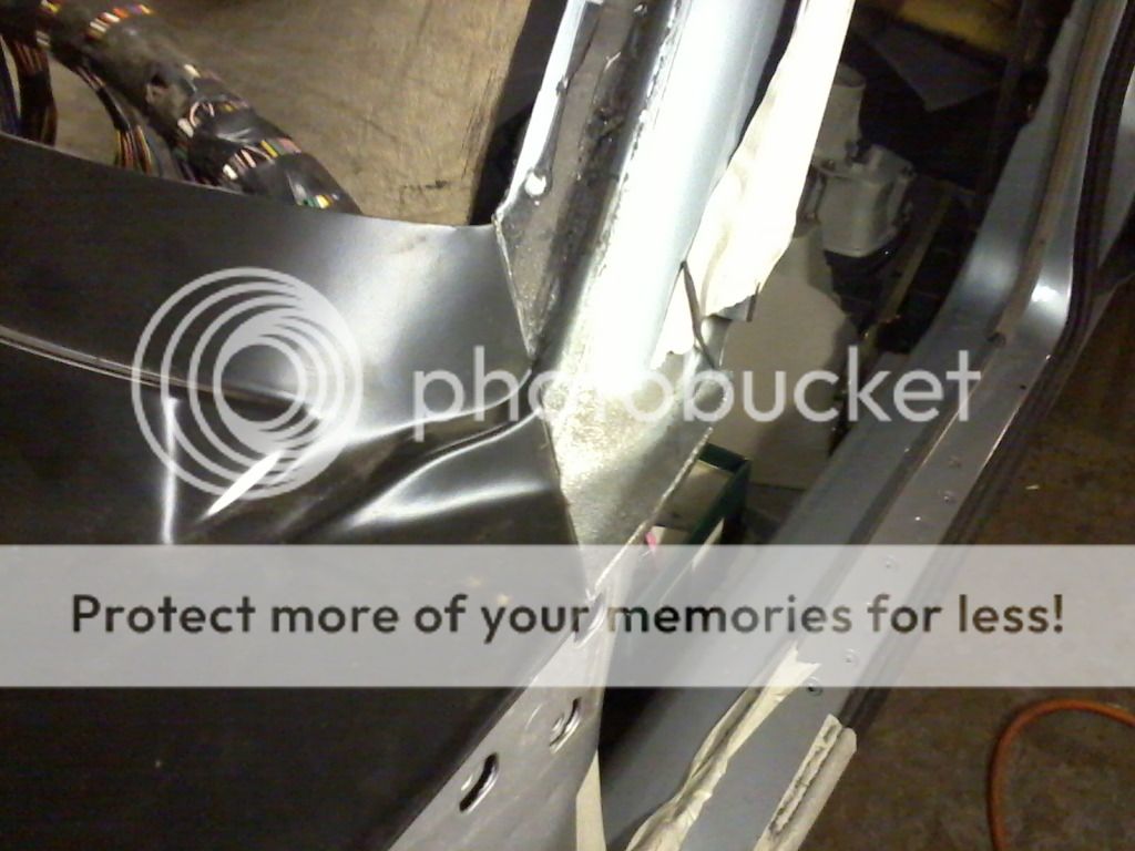

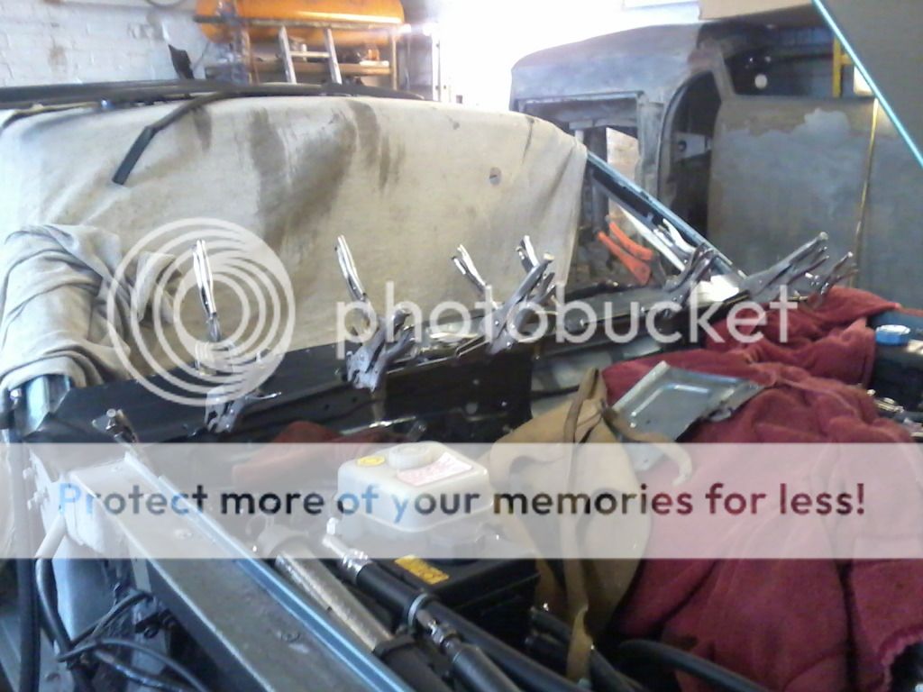

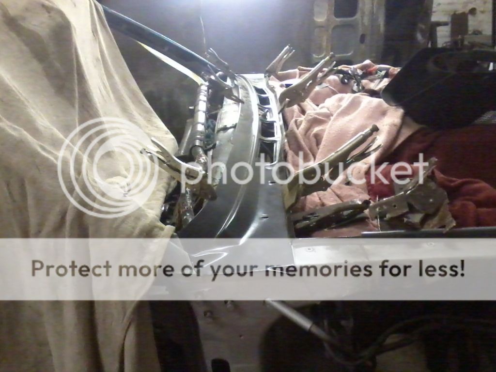

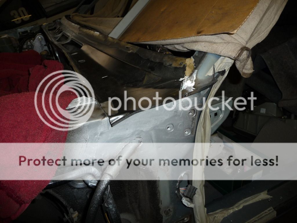

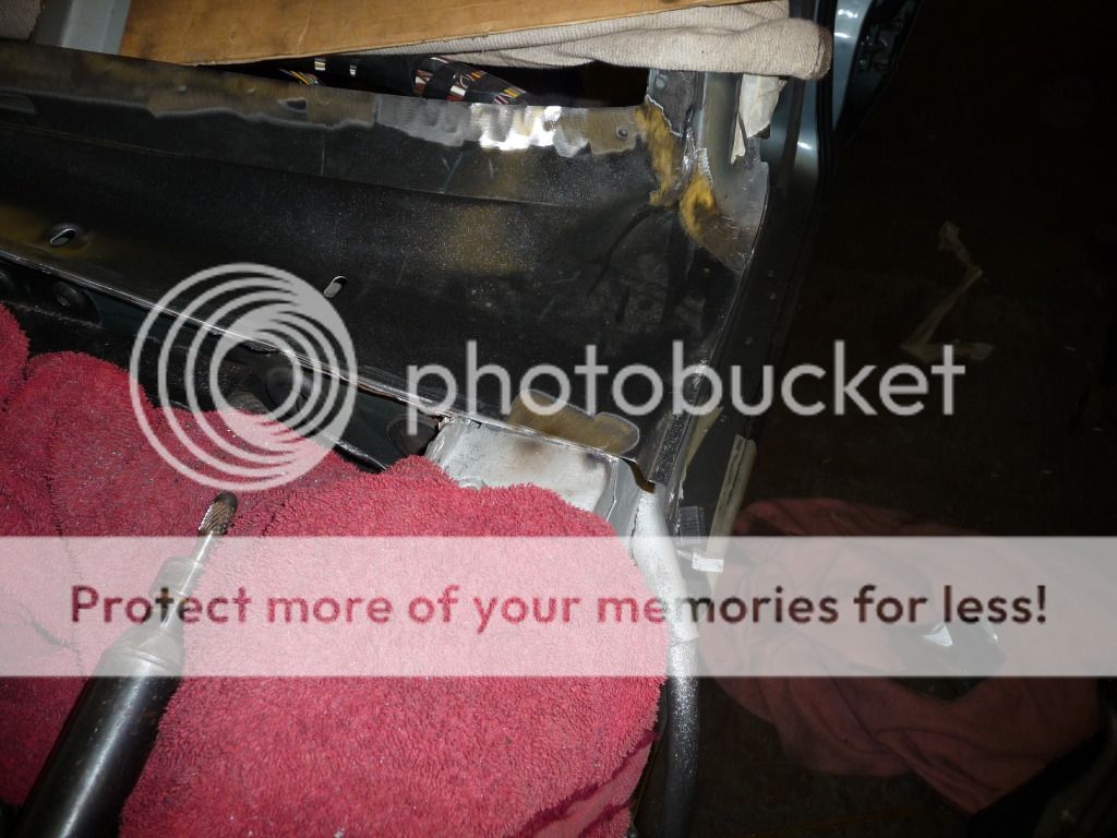

Then the final layer is the plenum top. This was fitted after the centre of the bulkhead had been replaced.
Posted Image
Gray carried out the same work on the left side. If anything, the rust was probably worse on this side

Final layer is again the plenum top. as before, the plenum top piece was added after the centre section of the bulkhead had been replaced.
Posted Image
Posted Image

Next installment!
As a few on here have mentioned, bulkhead rust is the undoing of many a late XJ40 – even otherwise good cars can be rotted so badly here that they are scrapped.
The bulkhead wasn’t bad on my car, mainly having rust in a central part near the earth point. I first noticed a small blister here in about 1998, but is has developed at a very slow rate probably because the plenum has been kept clear of water – it used to slosh about sometimes back then - I thought it was something to do with the air conditioning!
Thankfully, the inner bulkhead wasn’t rusty so only needed to be cleaned up a bit. Rust through the inner bulkhead complicates the job considerably because of the huge array of internal parts which need to be removed in order to get to its inner face. The whole climate control system needs to come out which involves removing both the heater matrix and air conditioning evaporator along with all their allied pipes and electronics need to come out. I was very glad my car didn’t need this!!
The right hand side of the bulkhead is rust free:
Posted Image
As is the left: late XJ40s can have really horrible rust here – it is always a place to check for rust on any battery in boot ’40.
Posted Image
The bulkhead rust blister is visible here. I first noticed rust here in the late 1990s – it has developed very slowly since.
Posted Image
Gray marked out the bulkhead ready for cutting - the plenum top has already been removed in order for the inner wings to be repaired:
Posted Image
Cut!! :D
Posted Image
Posted Image
Luckily the inner bulkhead was in excellent shape with very little rust and only needed cleaning up. Had this been corroded the job would have grown considerably.
Posted Image
Repair section cut from a genuine Jaguar XJ40 bulkhead repair panel (JLM20631) I was lucky to find. I bought mine from Jaguar but unfortunately they are now unavailable from JDHT. The part radically reduces the amount of work needed to repair the bulkhead and is likely increase its accuracy for most people. I recommend anyone doing this repair to use the panel, if they can find it. XJ restorations in Eastbourne bought the last few - I believe they still have them in stock.
Posted Image
Welded in:
Posted Image
Another Jaguar part was used for the plenum top repair section, cut from a ‘Windscreen panel’ FNA1114BC - part 3 in the diagram. This is actually an X300/X308 part, used since the XJ40 one is no longer available. Jaguar list it as a supersession part however and it is identical.
Posted Image
Very accurate cutting saw it fit perfectly:
Posted Image
Posted Image
Posted Image
Posted Image
Posted Image
Spot welded in:
Posted Image
Posted Image
Posted Image
Then the welds ground off:
Posted Image
Posted Image[/
1992 Jaguar Sovereign
