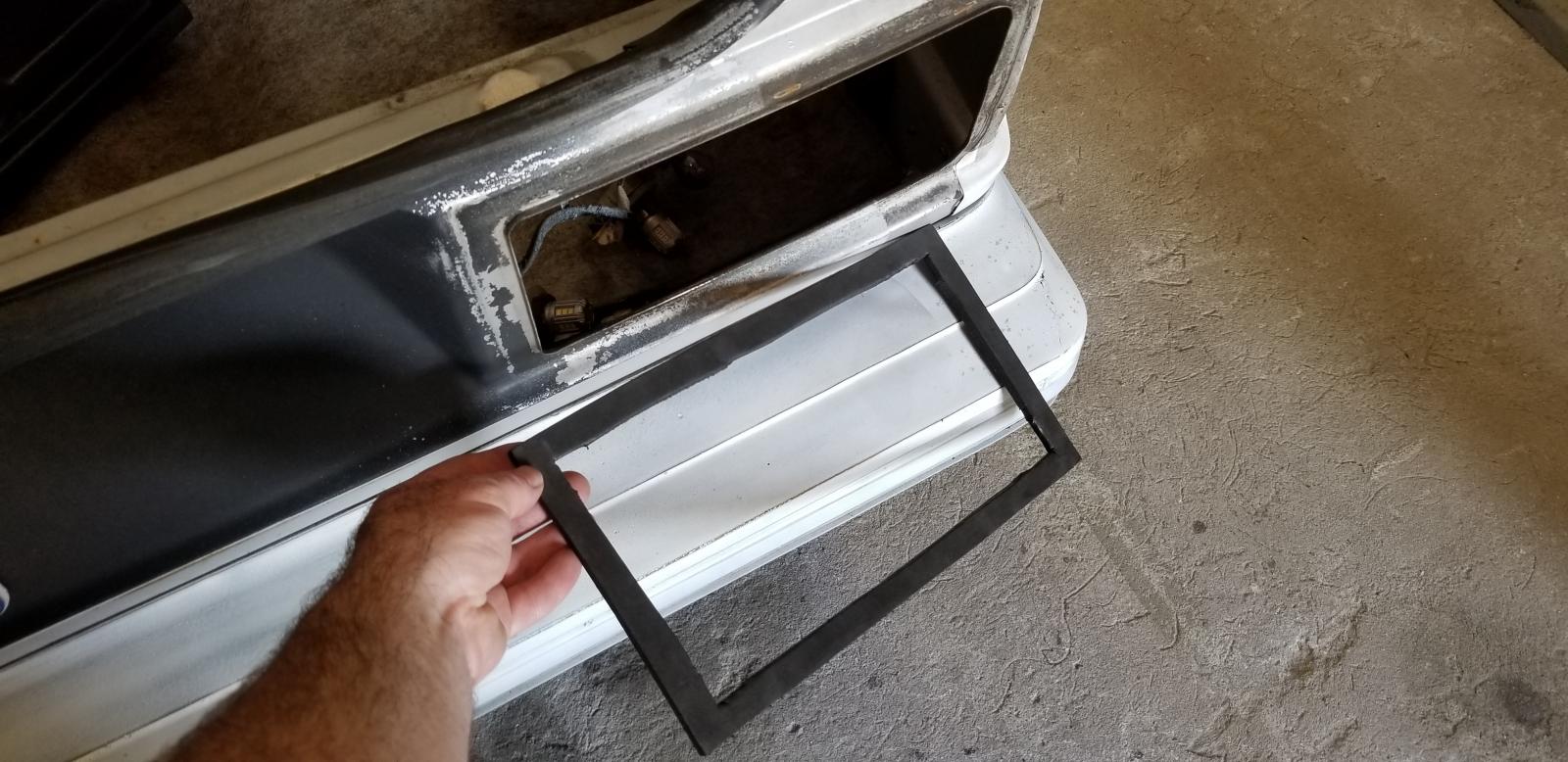

PhilA Posted April 23, 2018 Author Share Posted April 23, 2018 Bought a neoprene boot today but I'm not sure it'll work. I shall try. Also made a new light seal for the back. Sits okay, shall see how it fares. Gave it a wash and a brief outing for the first time since November. Going to try do the boots this week, have vacation time off. Phil Eddie Honda, somewhatfoolish, vulgalour and 1 other 4 Link to comment Share on other sites More sharing options...

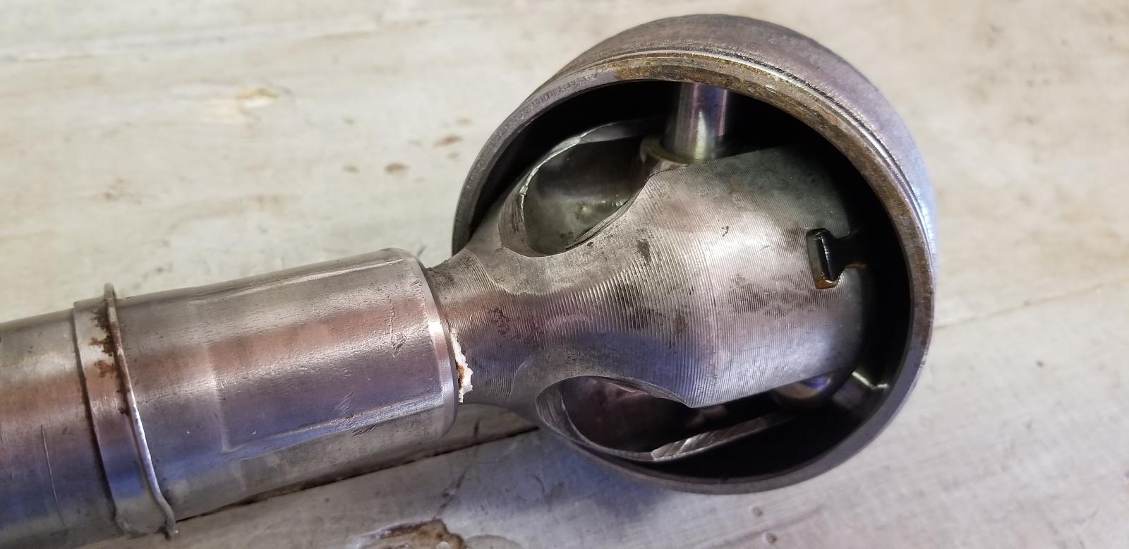

PhilA Posted June 7, 2018 Author Share Posted June 7, 2018 I finally got off my arse and decided to fix the car. This is my spare nearside driveshaft. It had a hole in. Pulled the boot off. Inside it was dry as hell and all the grease had turned to the consistency of rubbery yoghurt. Presto! An hour of toothbrushes, old paint brushes and petrol later and it's all clean. Greased it to within an inch of its life. Cleaned up the other end and forced new grease into the needles. Money shot! All back together, unfortunately with zip ties because the stupid metal band things they supply need a special tool, which qualifies for "nope". New outer one is really stretchy. Hopefully it'll last. I'm going to try do both sides in one go- gearbox needs drained for the other side (ffs). Need to get a boot for it too. Phil vulgalour, CGSB, somewhatfoolish and 3 others 6 Link to comment Share on other sites More sharing options...
3VOM Posted June 7, 2018 Share Posted June 7, 2018 I have the proper tool but I think you could get away with a pair of blunt pincers the right size. Link to comment Share on other sites More sharing options...
PhilA Posted June 7, 2018 Author Share Posted June 7, 2018 I tried it and 1) cut my finger open on the tab and 2) couldn't get the tab to bend over without risking punching a ruddy great hole through the new boot. Trying to grab on to a strip of greasy metal never works well Thanks for the offer- I'll risk the zipties. The outer end has 2, they are tight and are sitting in the pair of grooves the original style boot had a slot to go in (this is a universal style boot, all the original ones I've had have been new old stock and the rubber has been well past its' sell-by date). --Phil pilninggas 1 Link to comment Share on other sites More sharing options...

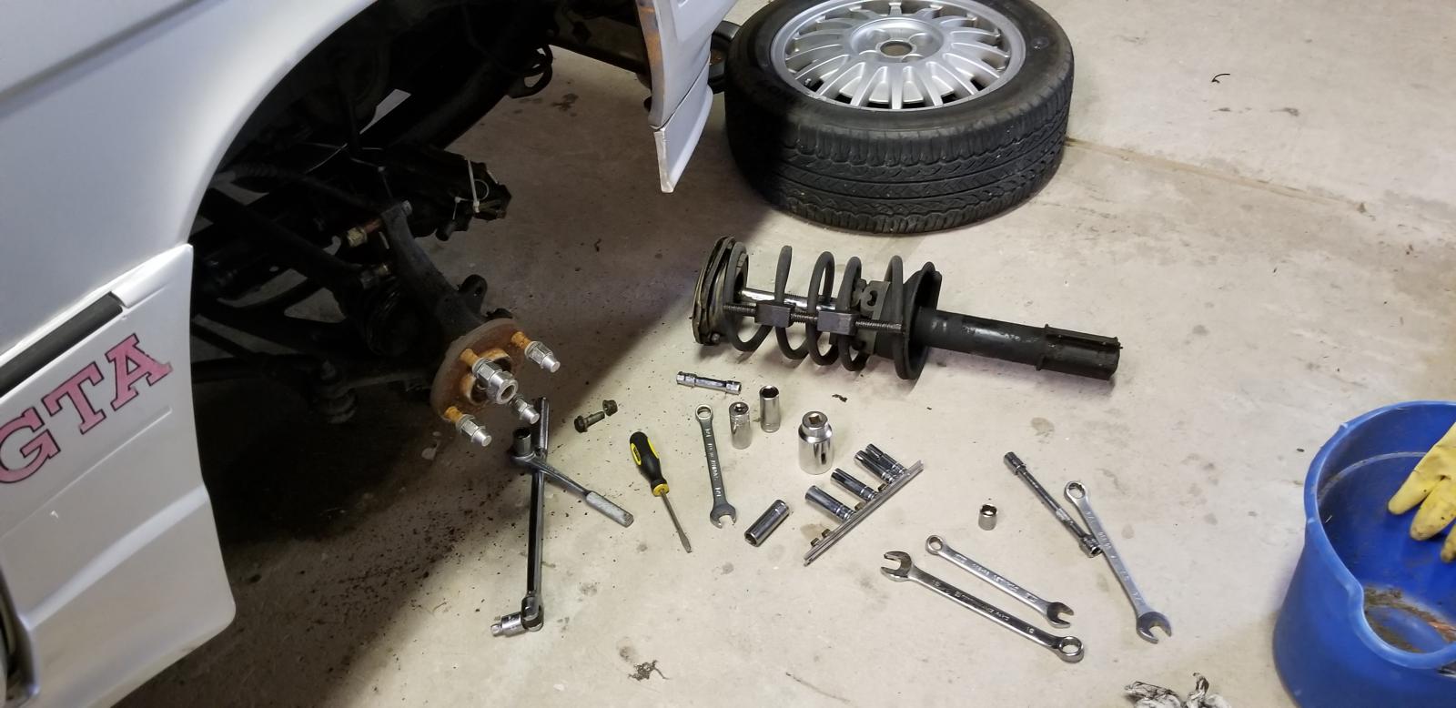

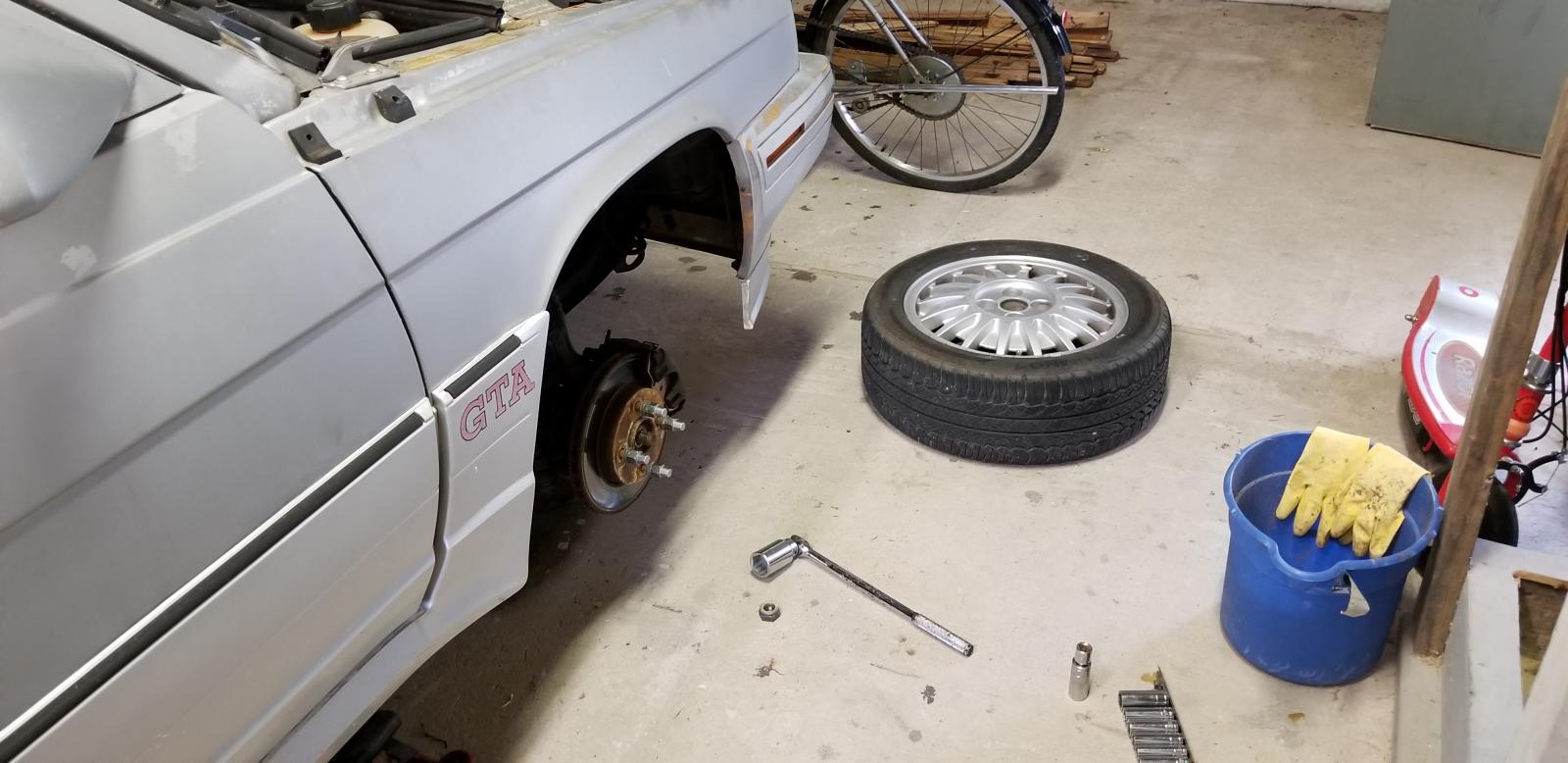

PhilA Posted July 17, 2018 Author Share Posted July 17, 2018 Okay. Finally got my ass in gear. The day was moderately cool, being overcast so the oven was less so and more a garage. Holy moly, I still own a car! First order of business was to put on the handbrake and crack off the hub nut.Next up I decided to twist the ignition key. Damn car only started up as though it had been switched off this morning. My jack did not enjoy being pressed back into action, it got a little leaky but did still pump up. Shazam! Wheel just fell off (with minimal kicking and swearing). Bloody thing. This side was howling on overrun. You can see why. On the upside, nothing on the lower suspension will ever rust. Caliper off, disc off. Disc took a gentle* beating with a small* piece of wood to remove. Evil things. Nice and heavy duty though. Sykes-Pickavant from way back when. Fought with it and got everything off. Managed to split the dratted tripod bearing and got needles all over. Swapped the bearing tripod over and fitted it all up. Much more stretchy. Tightened everything back up and flung it back down on the floor. Looks much the same as it did when I started. Gotta do the other side next, but that needs the gearbox to be drained. Ugh. Phil Burnside, DeeJay, Lacquer Peel and 5 others 8 Link to comment Share on other sites More sharing options...

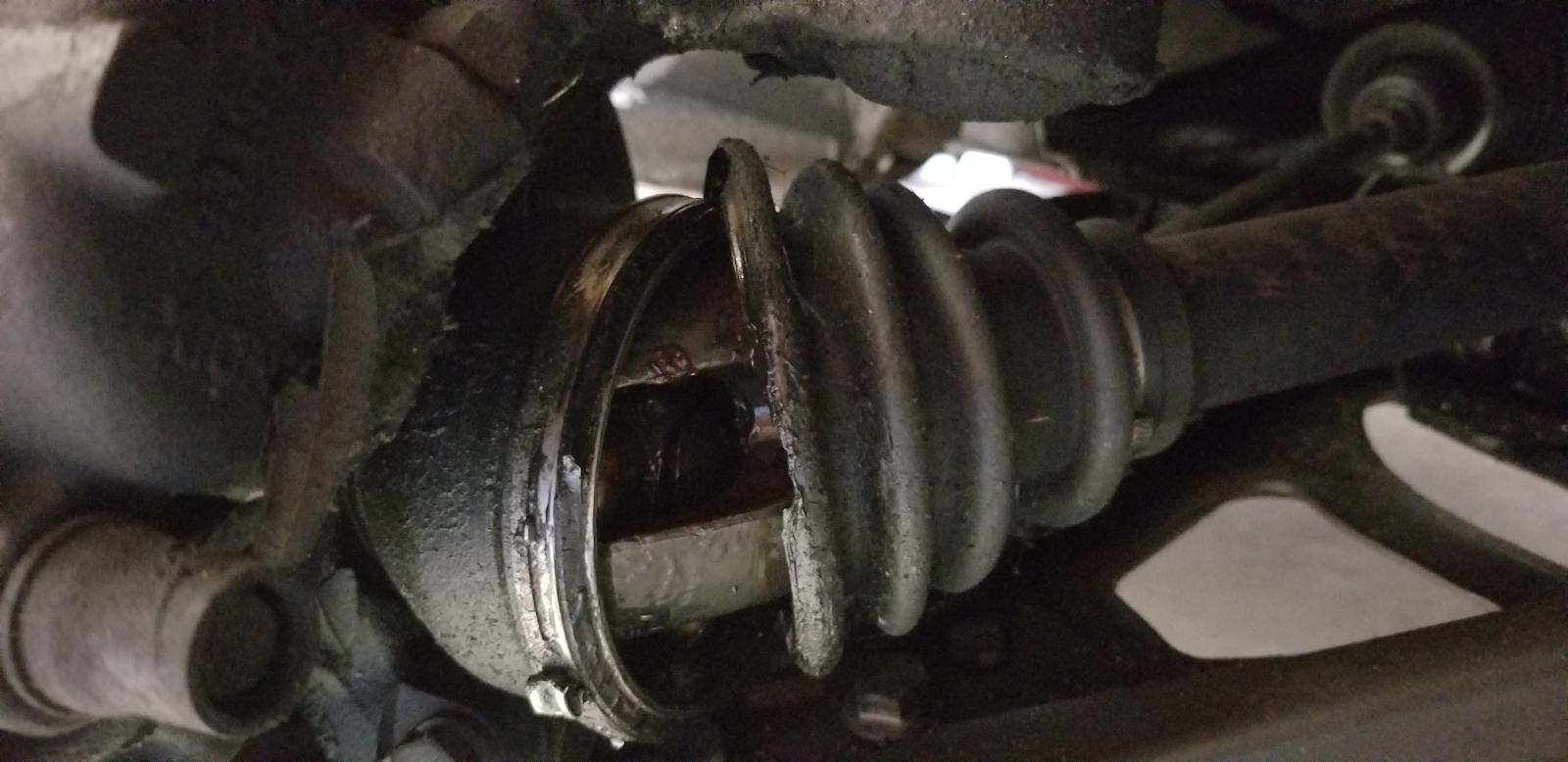

PhilA Posted July 17, 2018 Author Share Posted July 17, 2018 I've had her up to 60 myself, but why would you want to be in such a gold-darned hurry? The only reason I say that is I've jacked a car up before and had it in top gear and brought the revs up.. and I've seen the wobble CV boots can attain due to grease being unevenly distributed inside. It's quite scary to watch. Personally I think the old boots didn't have enough stretch for full lock, if you see the picture above that's on maximum lock there and it's not got much more to give. Link to comment Share on other sites More sharing options...

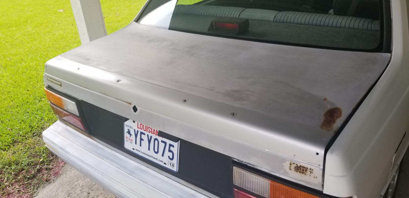

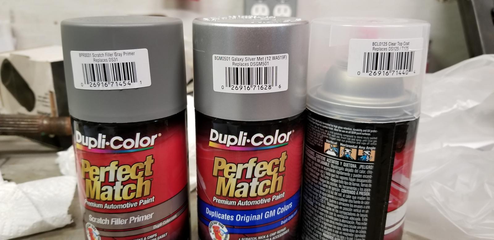

PhilA Posted July 28, 2018 Author Share Posted July 28, 2018 I was buoyed today with the concept of paint, or rather the lack thereof on my car. I had a bit of a read of the Internet and decided that the paint I need (Chrysler Sterling metallic, 1985) was unobtanium premixed locally so went about having a shufty on the rather dusty shelves of Dupli-Color paint at the local auto parts place.Came up with the closest, a 2001 Chevrolet color, a bright silver metallic. It's not quite as blue as this but it's pretty damn close to an unfaded section of paint under the hood. Started by pulling the spoiler off and cleaning up. Sixty grit to pull the second coat of paint off, which, underneath looked like it had been applied with a fork. 120 grit. Gave it a wipe over after 240 grit. Pretty smooth, considering. The old paint smells like Stilton cheese. This is probably a bad thing and I'm going to die from inhaling the dust. Pulled it off the hinges and brought it inside the professional spray booth*. Decent few coats of etch primer. First coat of high build primer. That's where I'm up to tonight with it. Going to leave that to bake in the booth* until tomorrow, need a second can of it before it can be sanded down with high-number paper. Car secured with tinfoil and medical tape. More later! Phil Skizzer, Joloke, DeeJay and 4 others 7 Link to comment Share on other sites More sharing options...

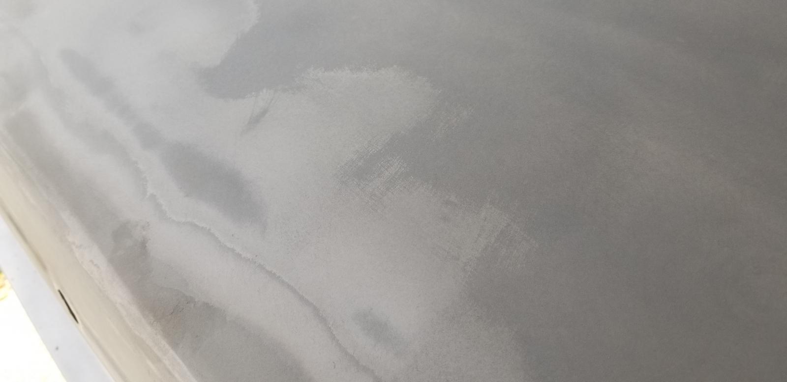

DeeJay Posted July 29, 2018 Share Posted July 29, 2018 Pretty smooth, considering. The old paint smells like Stilton cheese. French innit, probably Camembert. PhilA 1 Link to comment Share on other sites More sharing options...

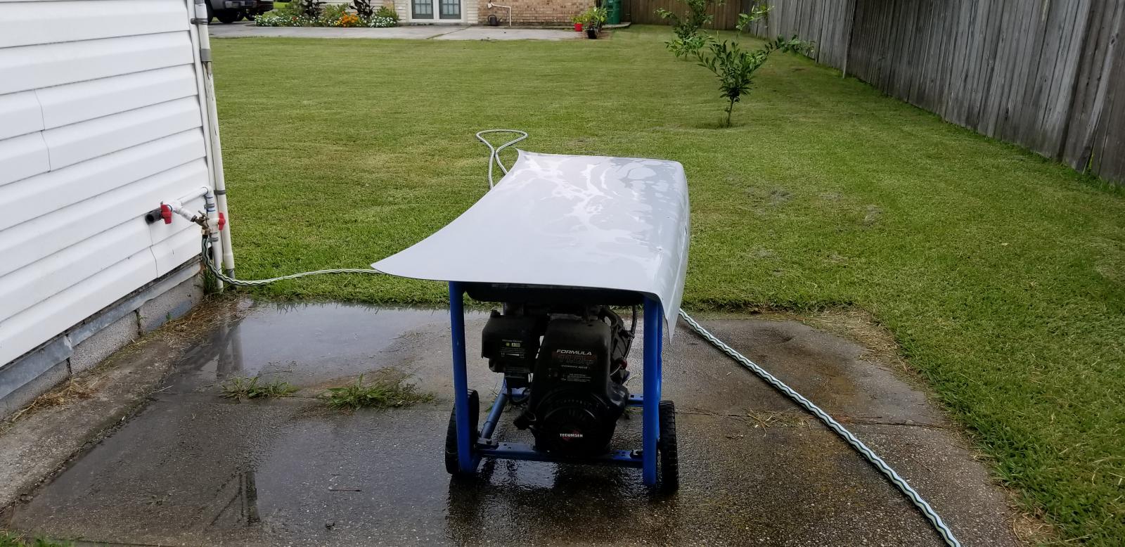

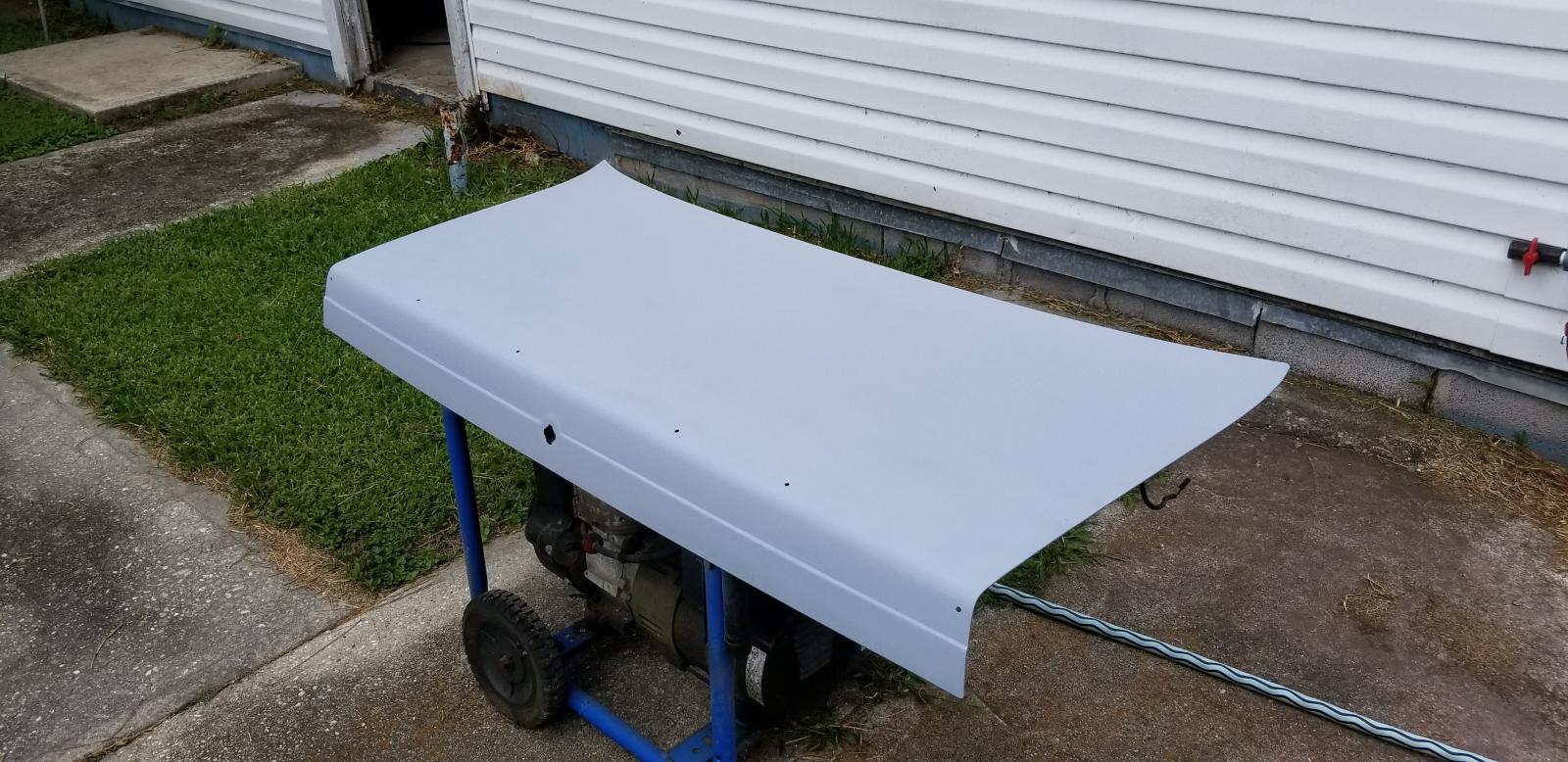

PhilA Posted July 29, 2018 Author Share Posted July 29, 2018 Took it outside (in a thunder storm). Smart. Bought some spare paint too, hopefully that'll be enough. Started with 800 grit and plenty of water. Needs to dry thoroughly but it's smooooooooth. Phil Burnside 1 Link to comment Share on other sites More sharing options...
