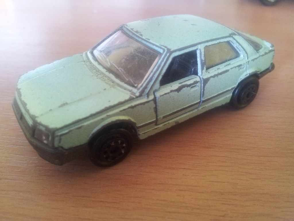

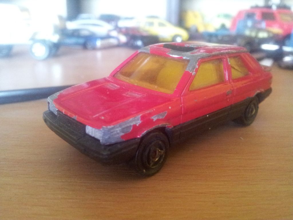

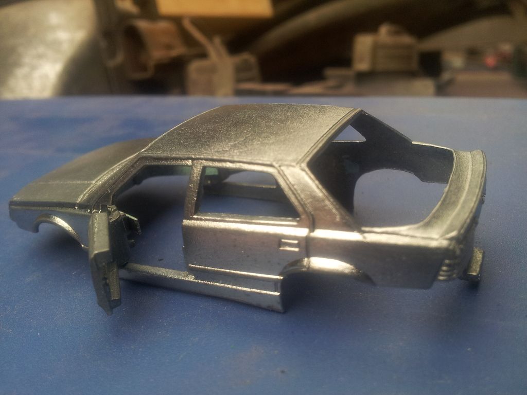

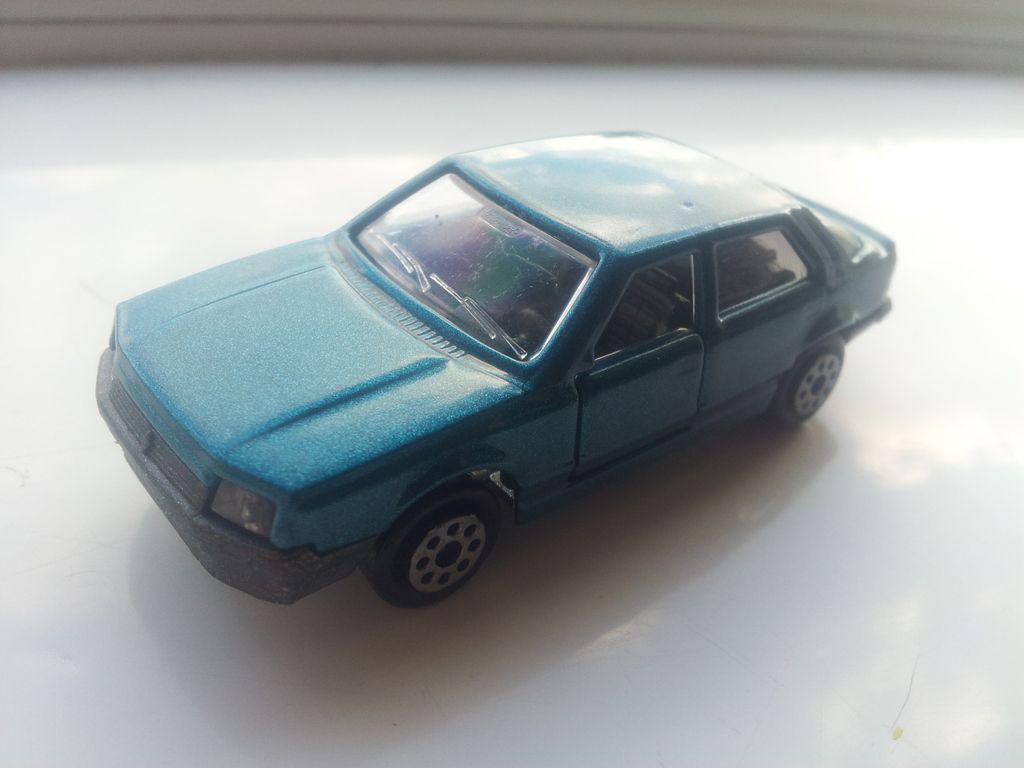

junkyarddog Posted April 19, 2017 Share Posted April 19, 2017 Tatty,well playworn and repainted Majorette Renner 5 Happy with that,the mirrors are missing,hopefully some will turn up. hennabm, 155V6, Lord Sterling and 5 others 8 Link to comment Share on other sites More sharing options...

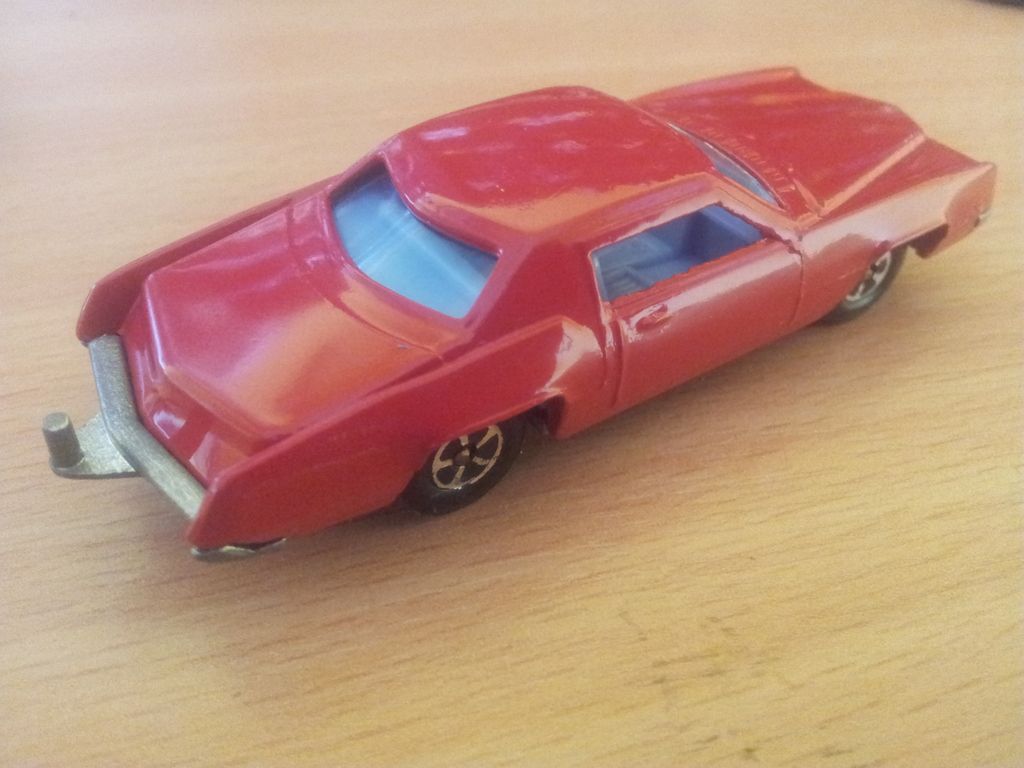

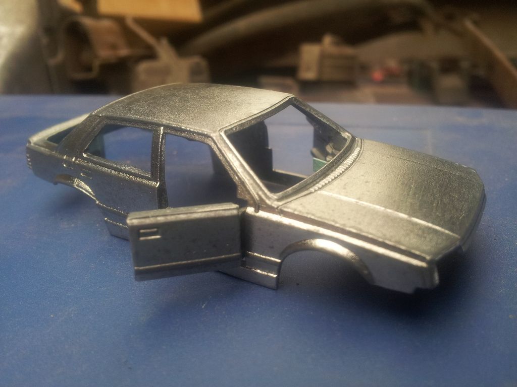

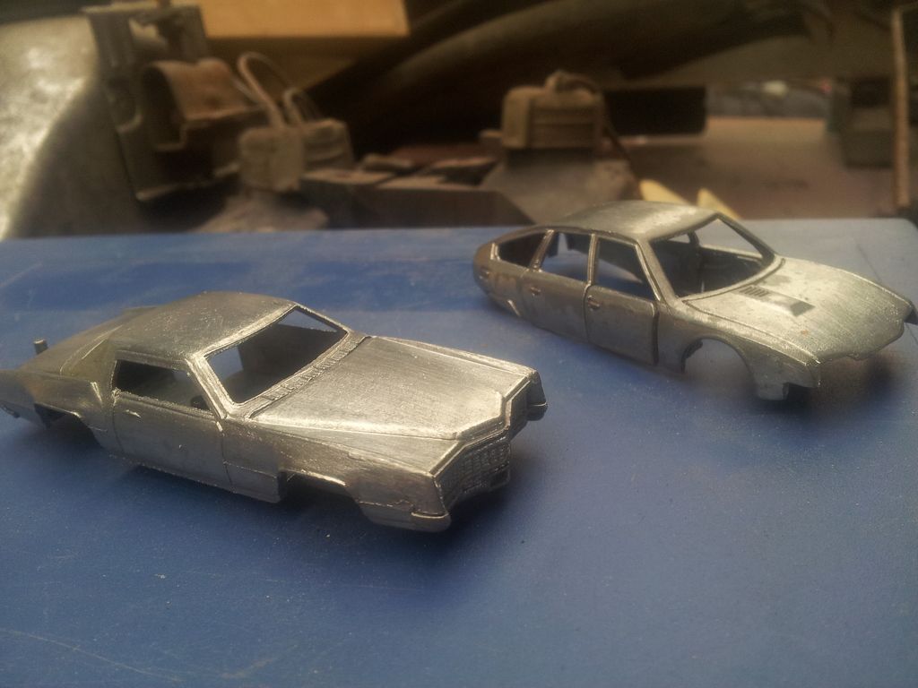

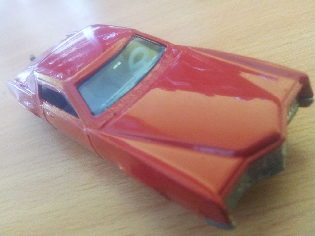

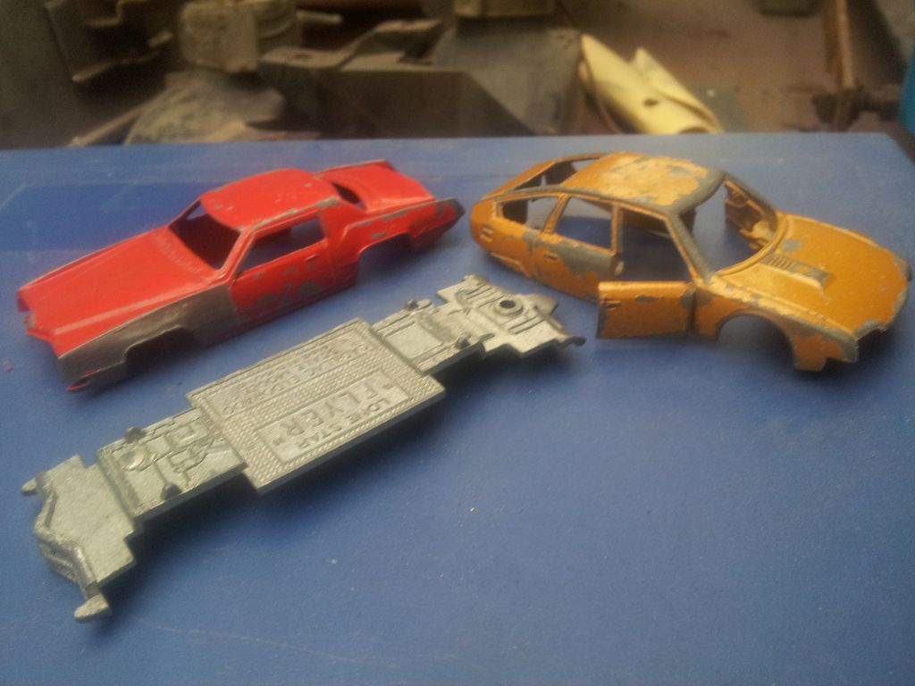

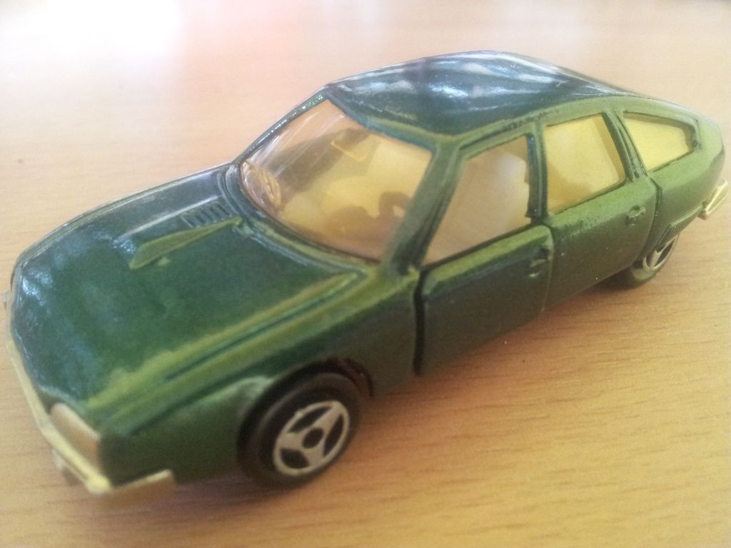

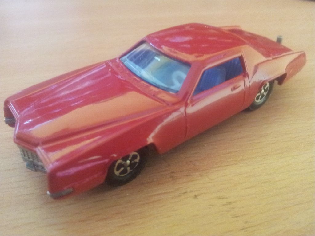

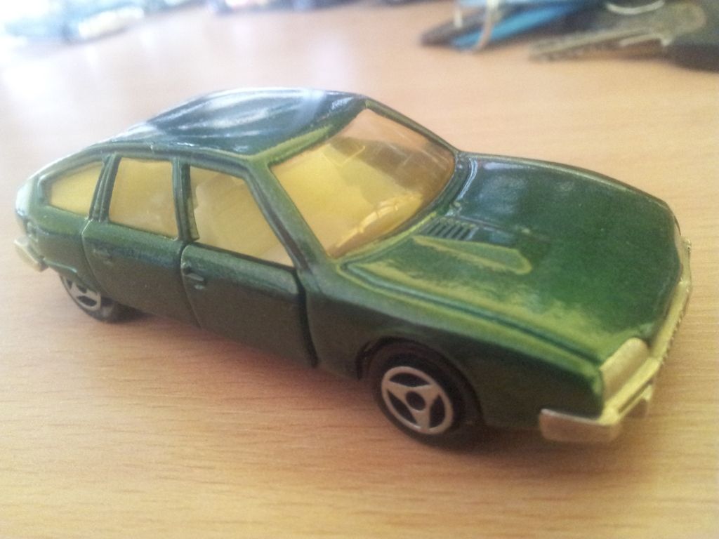

junkyarddog Posted April 20, 2017 Share Posted April 20, 2017 More repaints,Majorette Citroen CX and a Lonestar Caddy, Very pleased with the outcome Lord Sterling, mercrocker, 155V6 and 8 others 11 Link to comment Share on other sites More sharing options...

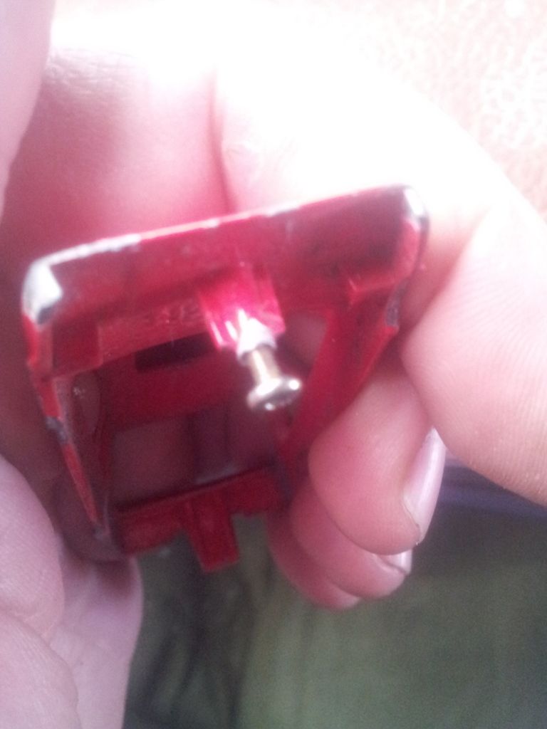

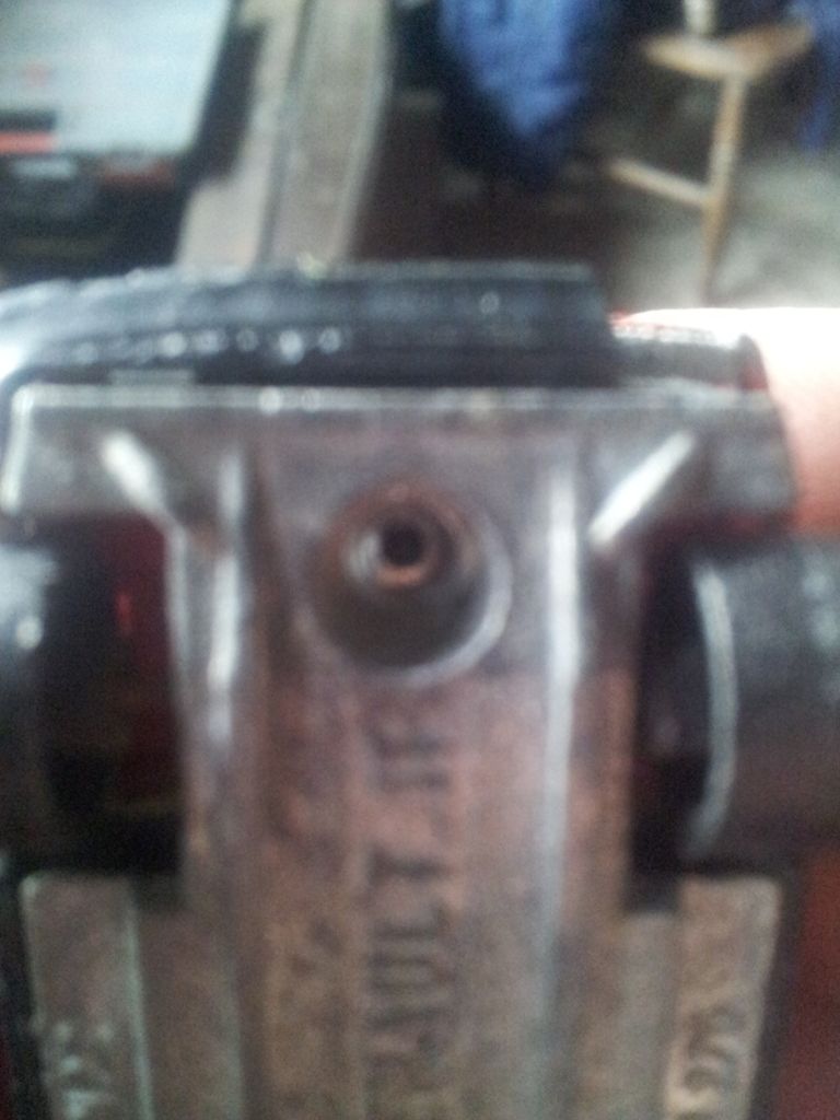

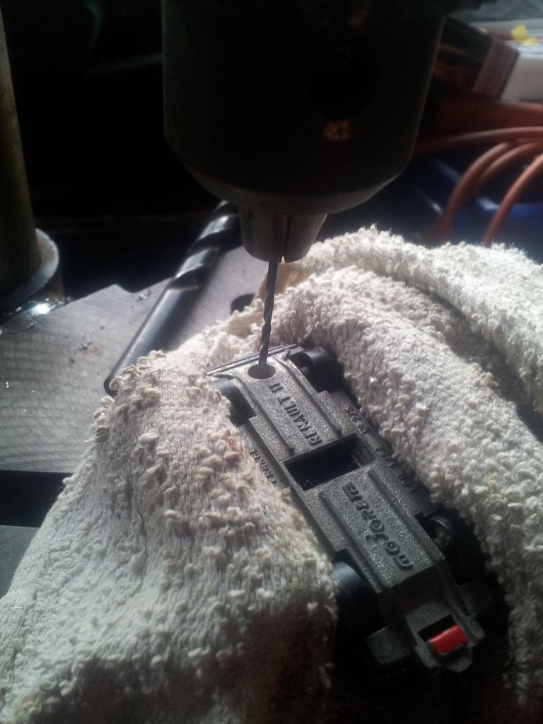

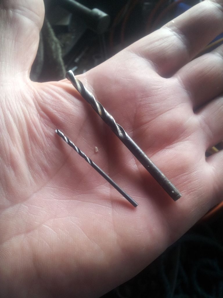

sierraman Posted April 20, 2017 Share Posted April 20, 2017 What method do you use to replace the original rivets on the base? Link to comment Share on other sites More sharing options...
junkyarddog Posted April 20, 2017 Share Posted April 20, 2017 Small drill to bore into the post,then a bigger one to take the head off of the rivet.Then tap the hole and use a small screw cut to length. Sometimes use a small self tapping screw,depends on what's available to me at the time. Junkman 1 Link to comment Share on other sites More sharing options...
Burnside Posted April 20, 2017 Share Posted April 20, 2017 Nice work on the repaints! That Citroen CX looks fantastic must get one myself. Really need to get my backside into gear and do the 20+ majorette / matchbox cars I've been collecting up. What paint stripper do you use as the stuff I've used on the ones I've resprayed so far are rubbish. junkyarddog 1 Link to comment Share on other sites More sharing options...
sierraman Posted April 20, 2017 Share Posted April 20, 2017 Small drill to bore into the post,then a bigger one to take the head off of the rivet.Then tap the hole and use a small screw cut to length. Sometimes use a small self tapping screw,depends on what's available to me at the time.Have you a picture of this so can see what I'd work to? Link to comment Share on other sites More sharing options...

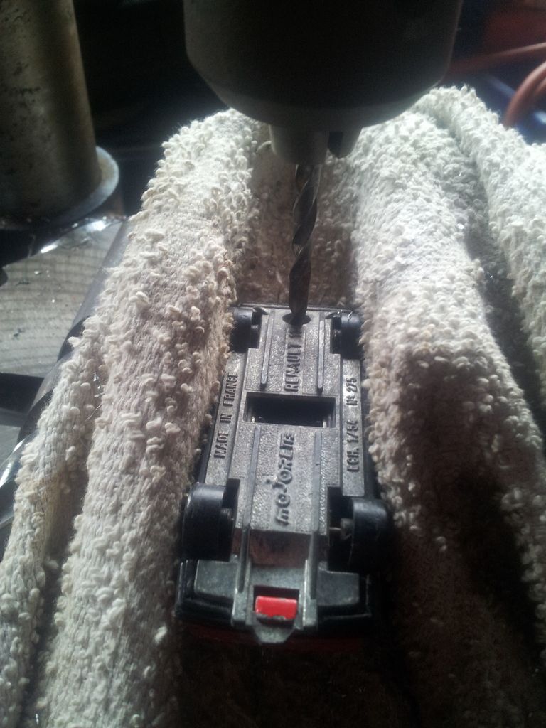

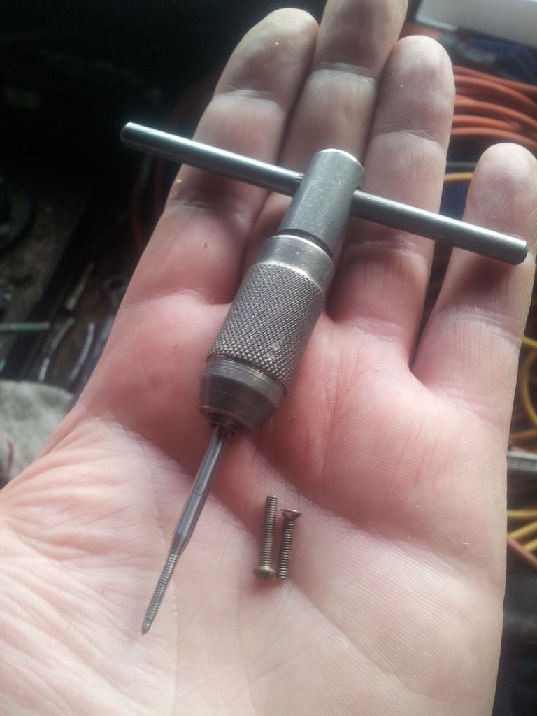

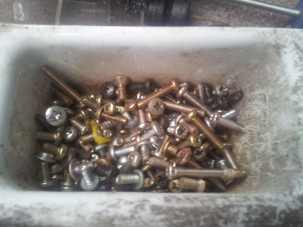

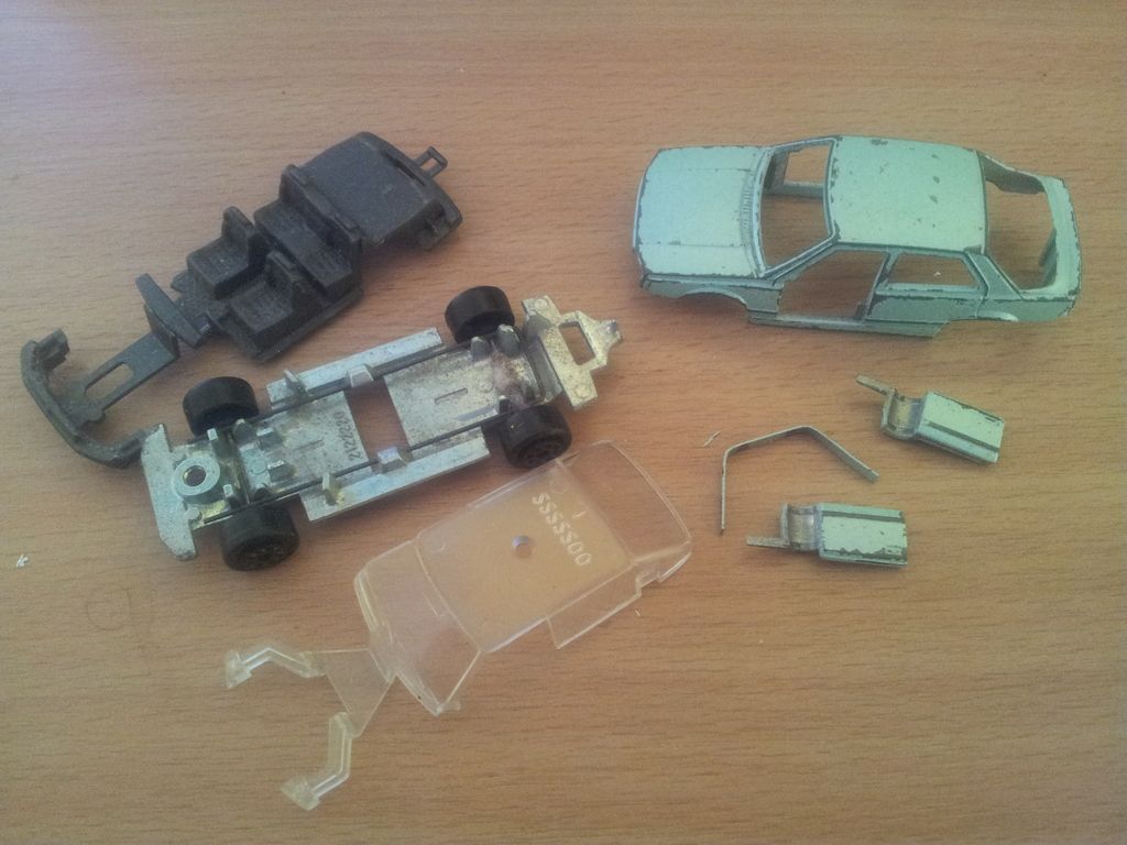

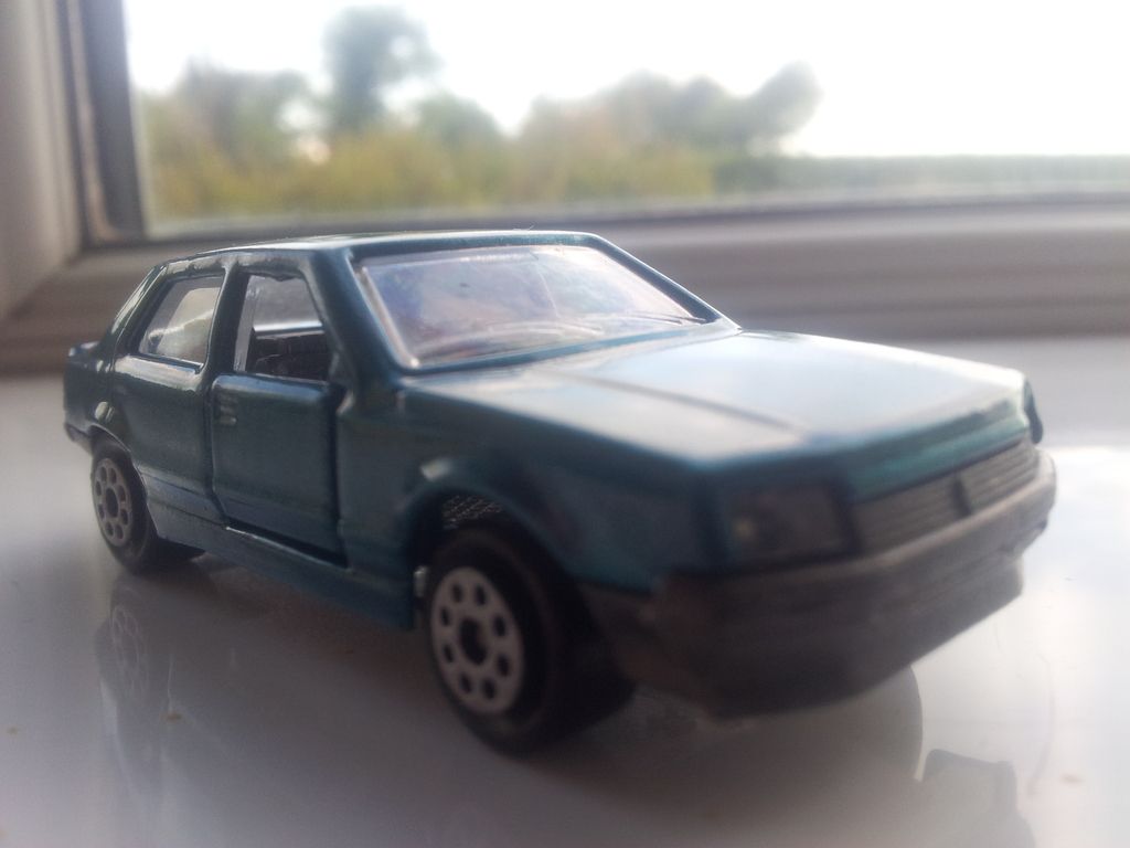

junkyarddog Posted April 20, 2017 Share Posted April 20, 2017 Have you a picture of this so can see what I'd work to?Tatty Majorette Renner 11 Tap and small screws. Or,these small self tappers will do too.These mainly came from old car radios ect. Hold in vice under the pillar drill,bore into post using the small drill bit,go slowly to stop a build up of heat,as the metal can clog the drill bit.Also keep and eye to how deep you are into the post. When deep enough,drill off the head with the bigger bit, Ready to come apart, Apart, Small self tapper screwed into the drilled out post, That's pretty much how I do it. eddyramrod, Lord Sterling, mercrocker and 3 others 6 Link to comment Share on other sites More sharing options...

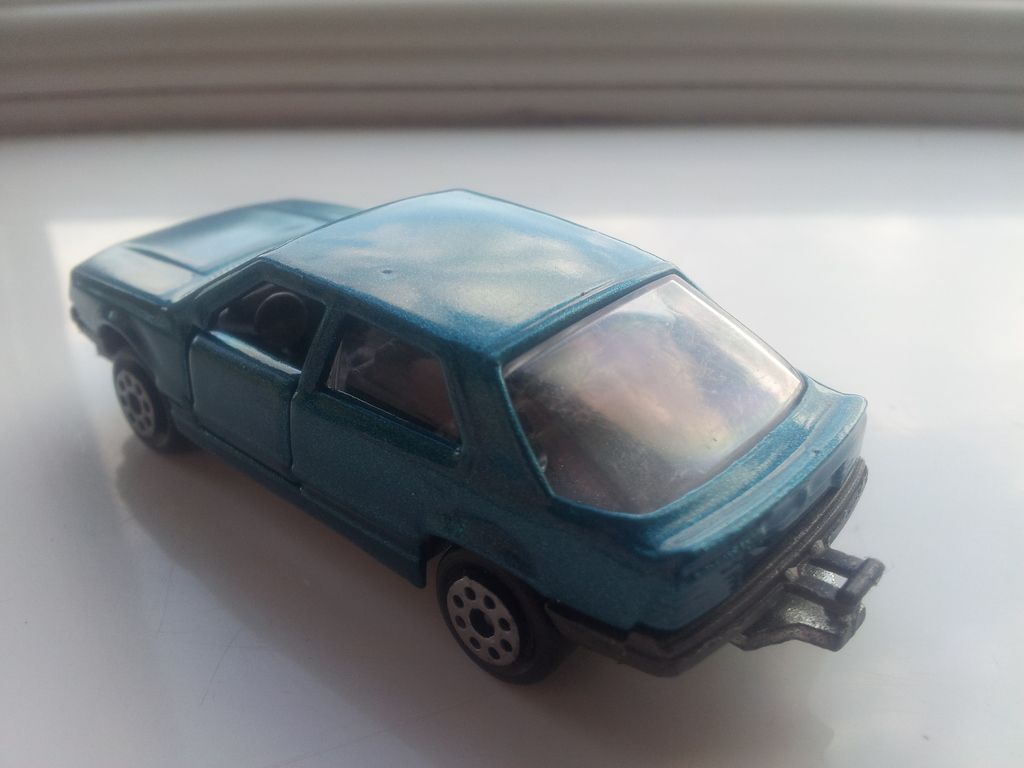

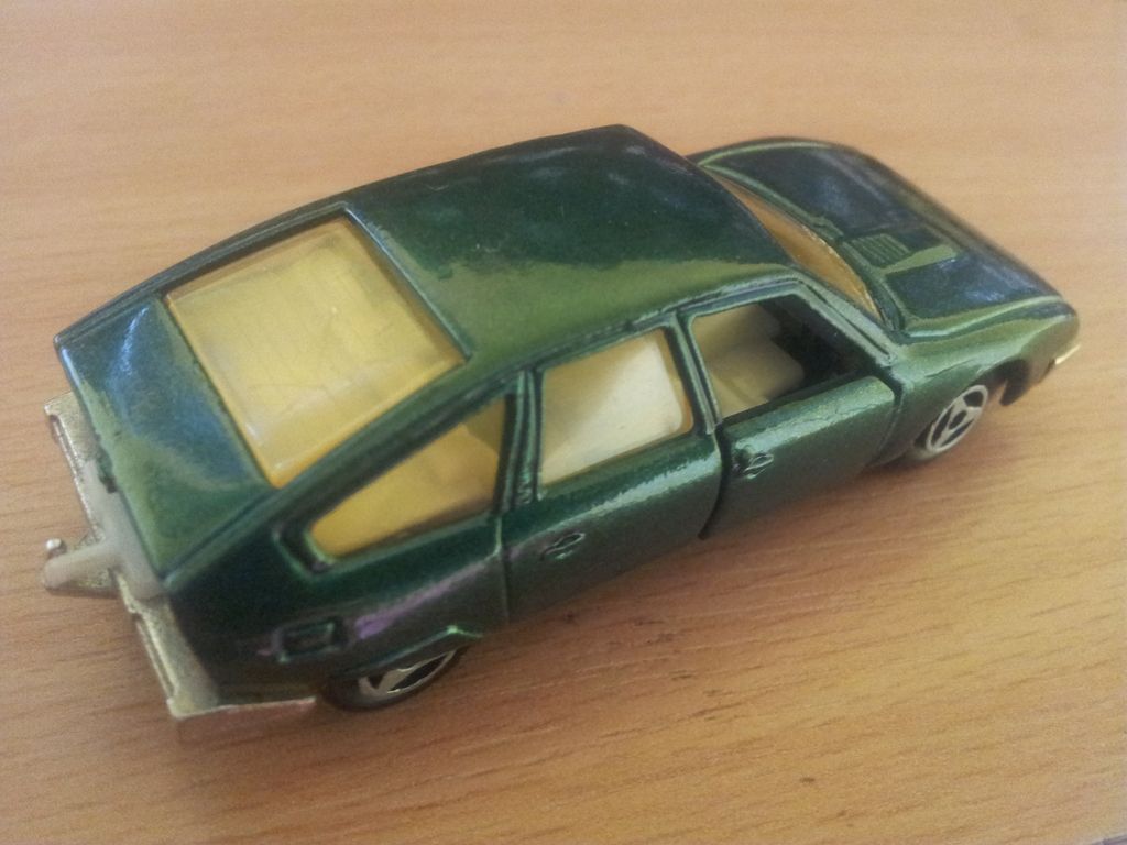

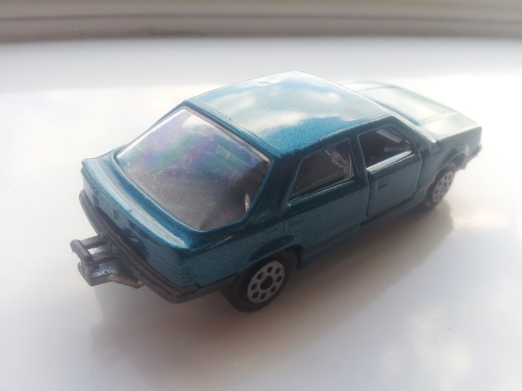

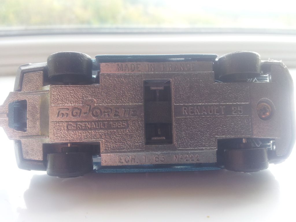

junkyarddog Posted April 20, 2017 Share Posted April 20, 2017 Renner 25 You can see the small screw in the base here. eddyramrod, Burnside, paulscavalier and 4 others 7 Link to comment Share on other sites More sharing options...
sierraman Posted April 20, 2017 Share Posted April 20, 2017 Right, food for thought, might have a crack at it this summer with some car boot finds. I've tried glueing before but find the joint itself is very brittle. Might try this on the Corgi Renault 16 i restored. It's a really satisfying way to bring life back into a tatty model and to get a specific period colour. Ironically I have the Majorette R25 in that colour, it's an original colour they did in the early 90s. Link to comment Share on other sites More sharing options...

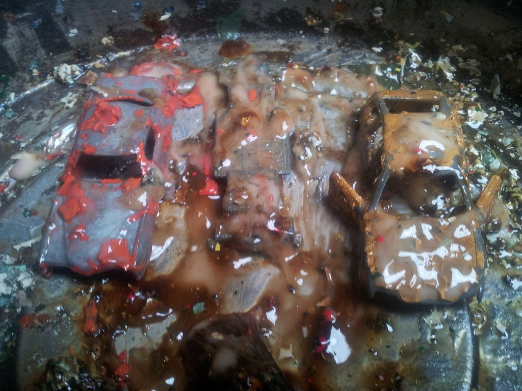

junkyarddog Posted April 20, 2017 Share Posted April 20, 2017 What paint stripper do you use as the stuff I've used on the ones I've resprayed so far are rubbish. Just some crappy stuff from B&Q,works well on some,not so well on others. Tend to leave on overnight and wash it off the next day using an old toothbrush,whatever paint is left usually comes off with the wire brush. Burnside 1 Link to comment Share on other sites More sharing options...
Spottedlaurel Posted April 20, 2017 Share Posted April 20, 2017 Excellent work there! Rather better than the hand-painted Humbrol efforts I used to do back in the day...... When I stripped paint off plastic kits I used brake fluid. junkyarddog 1 Link to comment Share on other sites More sharing options...
paulscavalier Posted April 20, 2017 Share Posted April 20, 2017 What paint do you use? I repainted a matchbox Porsche 944 in blue with some leftover car aerosol. I primed it first then topcoated and lacquered it. But is there a better way with more durable paint? Link to comment Share on other sites More sharing options...
junkyarddog Posted April 20, 2017 Share Posted April 20, 2017 What paint do you use? I repainted a matchbox Porsche 944 in blue with some leftover car aerosol. I primed it first then topcoated and lacquered it. But is there a better way with more durable paint?That's just what I use,you can buy specific paints and airbrush them on but that's too much of a faff for me. I do heat the paint and casting first though,just use a hot air gun on both. Link to comment Share on other sites More sharing options...
